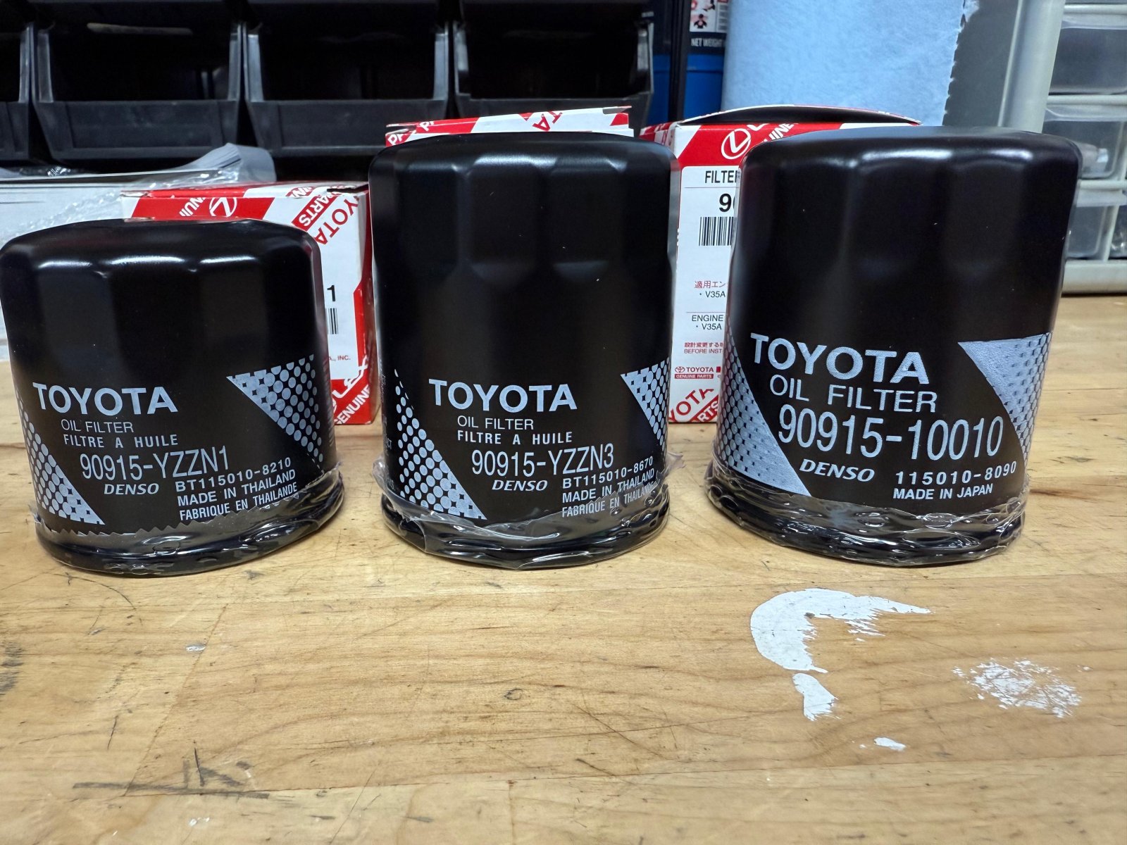

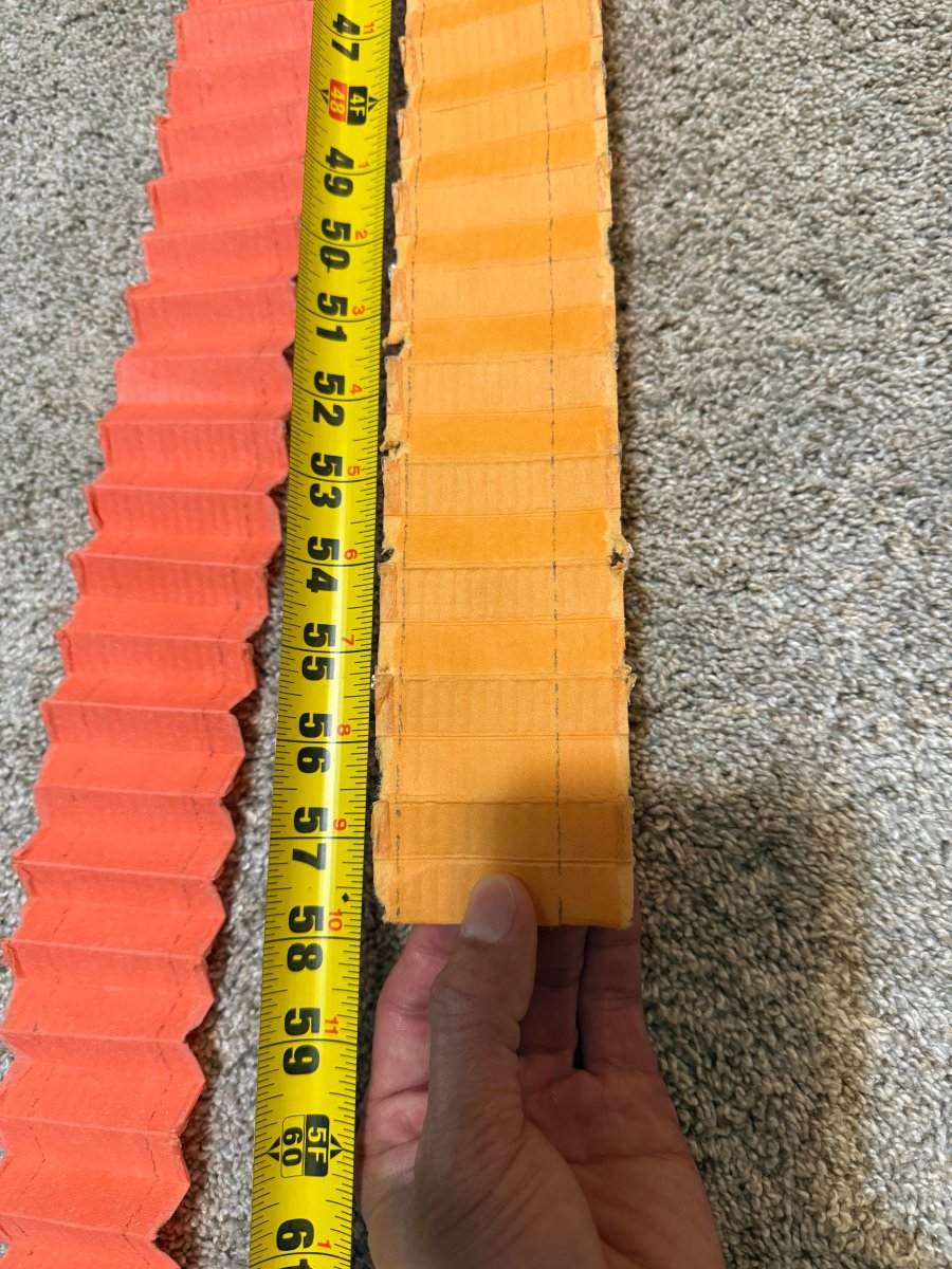

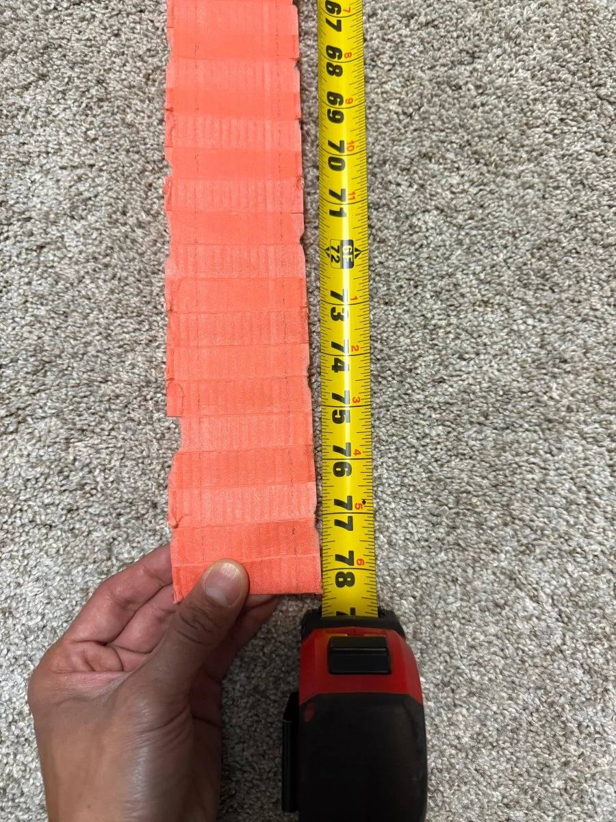

The 90915-10010 have been superseded the 90915-YZZN3. According to Lexus, the 90915-10010 is obsolete and they won't be making them anymore.

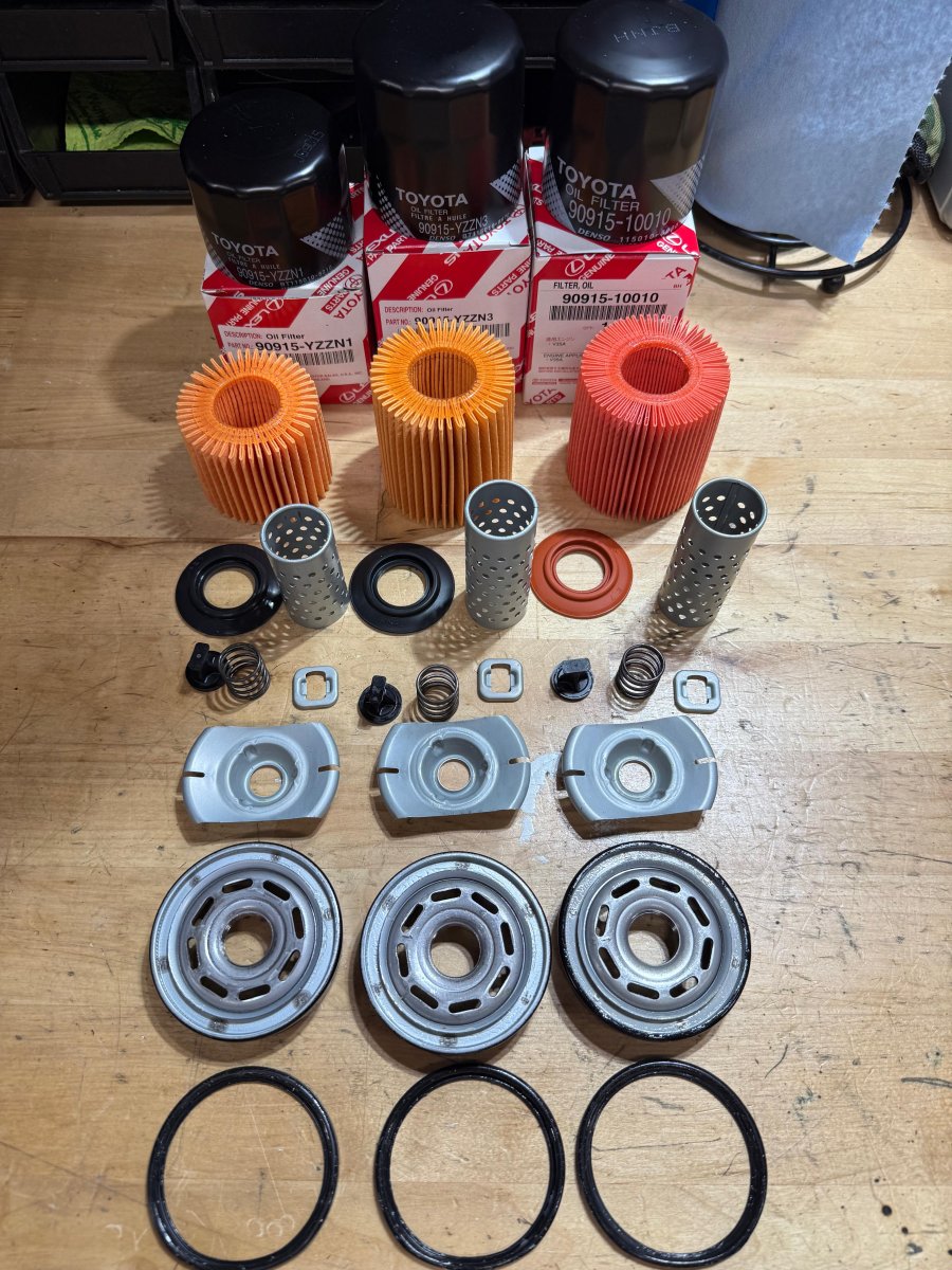

We were curious to see if anything is different besides the country of origin, so we cut them open. Every part seems to be identical except for the filter element, itself.

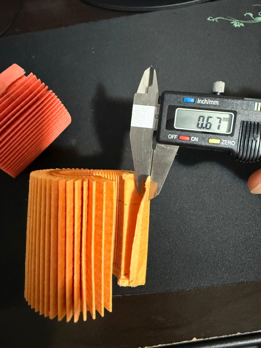

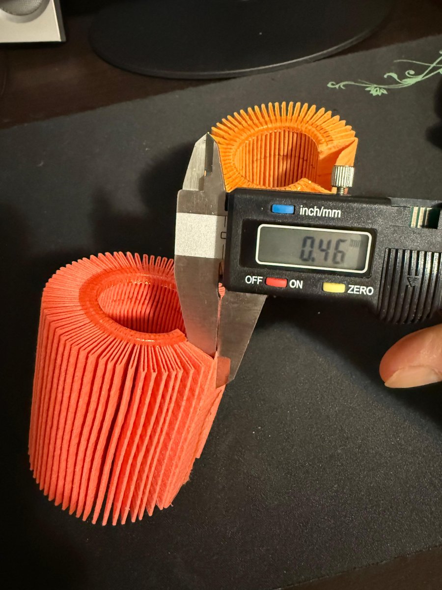

  • The revised version (90915-YZZN3) is almost 50% thicker than the obsolete (90915-10010).

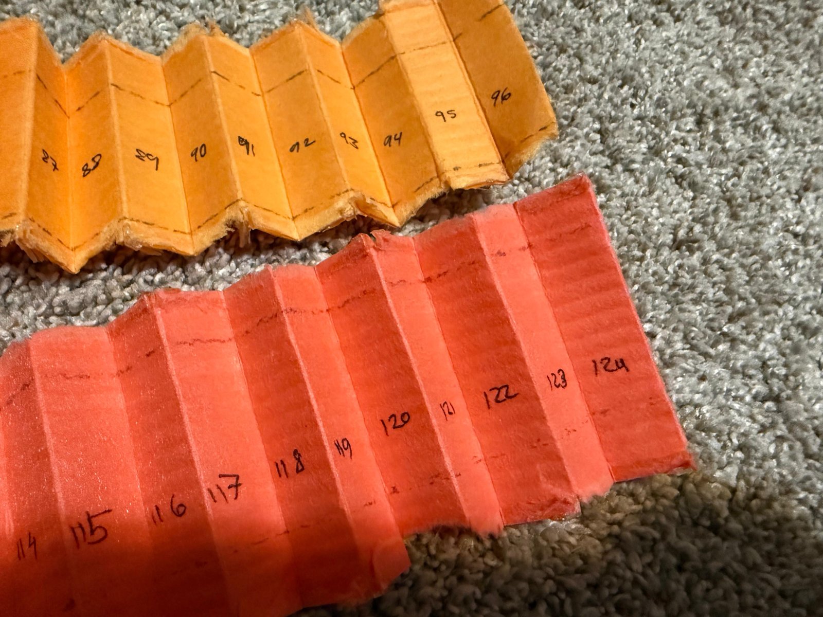

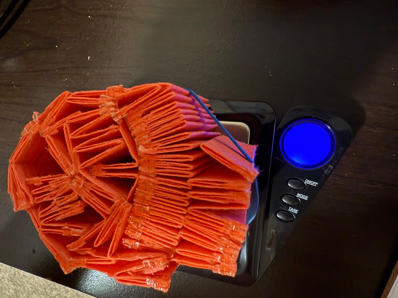

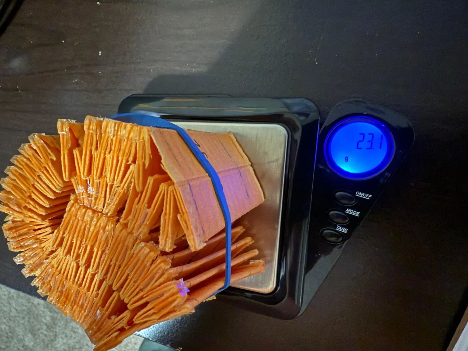

  • The revised version is more dense. Even though it was 34% shorter in overall length (58 vs 78 inches), it weighed more (23.1 vs 22.1 grams). Although subjective, there was more resistance when blowing air through it.
  • The obsolete version has many more pleats though.
- 124 vs 96 or 62 vs 48 depending on how you count them. Either way, it's 30% more pleats with the Japanese variant. More pleats = more surface area. More surface area usually means more filtering capacity before the filter becomes saturated.
Overall, Toyota/Lexus spends millions on R&D, so I’m sure they have their reasons for going through the trouble of revising it. They're the ones that have to deal with recalls/warranty claims.
Cheers,
-Tony
edit:
I wanted to give props to the OP ColoradoOutdoors for a stellar write up and apologies for the digression.
Thanks for the great evaluation of the filters but I'm a little confused on the 3 filters shown.
If the YZZN3 is the substitute for the 10010 filter, where does the YZZN1 fit into this evaluation.
Was the YZZN1 or 3 used in the filter media measurements?
Great question, Mike. The YZZN1 was not measured, since we ruled it out for being much smaller. Our local dealership sold it to us as an OEM replacement. We use it as a warning for others to be cognizant of better/safer options.

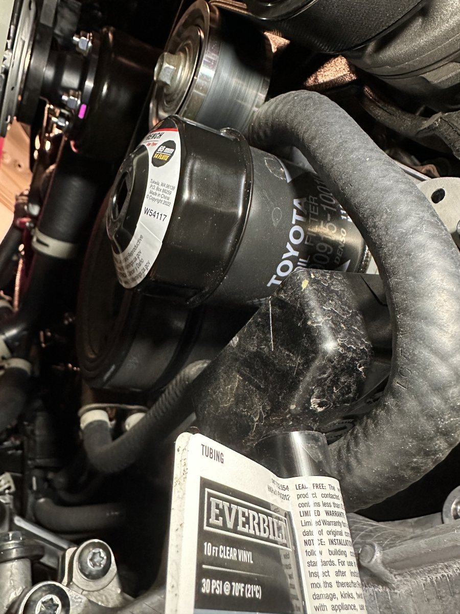

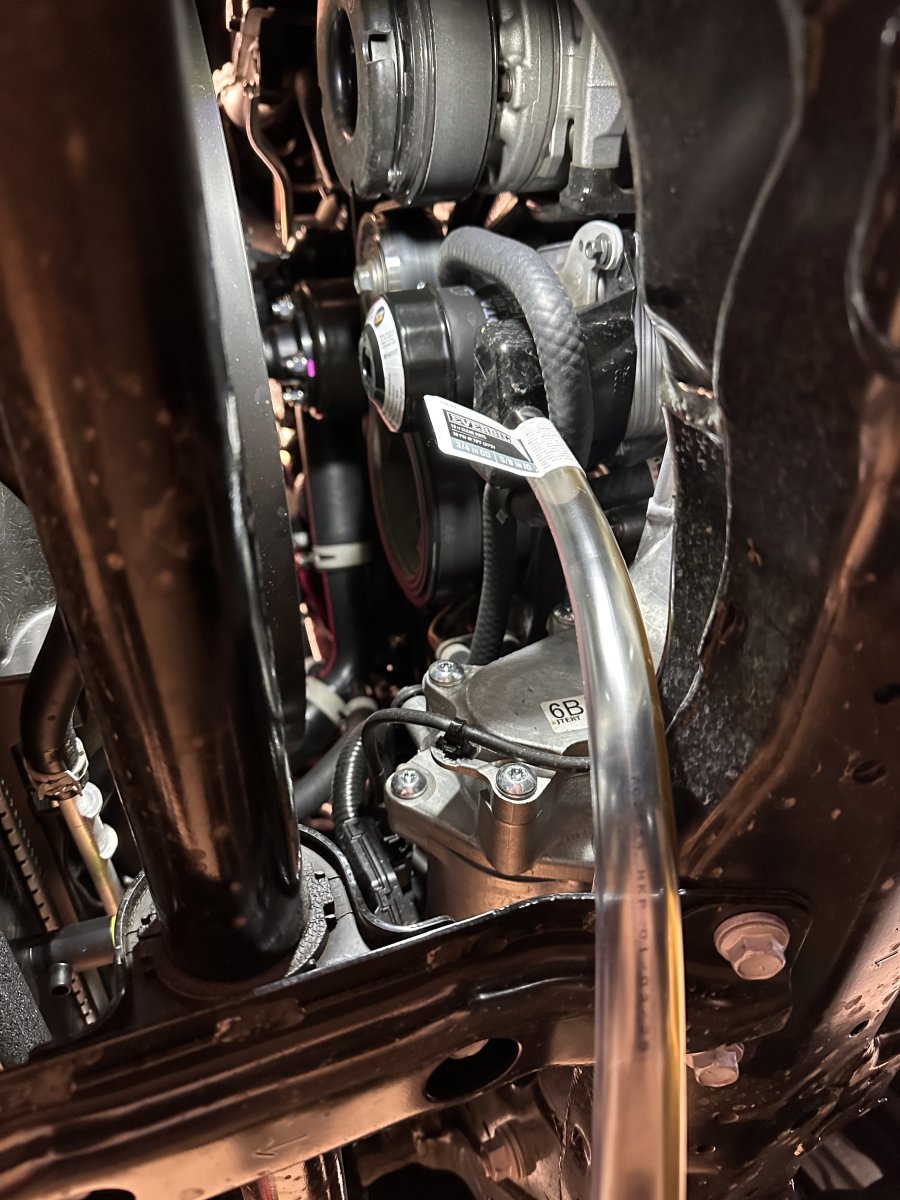

3. Filter removal and drain. This is the epic part of the oil change. The built-in catch pan with hose-ready drain below the filter is a marvel. Not a drip lost to a frame rail or my arm. Thanks Lexus! I used a 5/8 ID tube and ran it to an oil disposal jug. Not a tight fit, so don't go yanking on that tube or perhaps try something slightly smaller diameter if you prefer. I enlisted a Performance Tool filter wrench (65mm, 14 flutes) part no. W54117 as the original filter was set to 1 ugga dugga. Pic below of filter removal business. Lots of room to work with a ratchet in the area. Removal of the filter resulted in a renewed flow to the oil drain, which had already been in process for 15 mins or so. New filter o-ring was pre-oiled and protected by tear-off plastic. Nice. Installed to a something less than 1 ugga dugga torque.

Performance Tool filter wrench/cap (65mm, 14 flutes) part no. W54117
5/8 ID clear tube or 1/2 ID for more fiddly fit.

When I went to remove the oil filter, I first installed the tubing. Regardless, some of the oil went behind the piece that's supposed to direct it. Next time I'll put a paper towel up there to catch this runoff. The instructions on the oil filter said to go until it makes contact and then turn it another 3/4 turn. I turned it until it made contact but could only get it go about 3/8 of a turn more. There was no way that it was going to go 3/4 of the way around unless I used a wrench. That seemed excessive, so I just left it where I could get it by hand.
