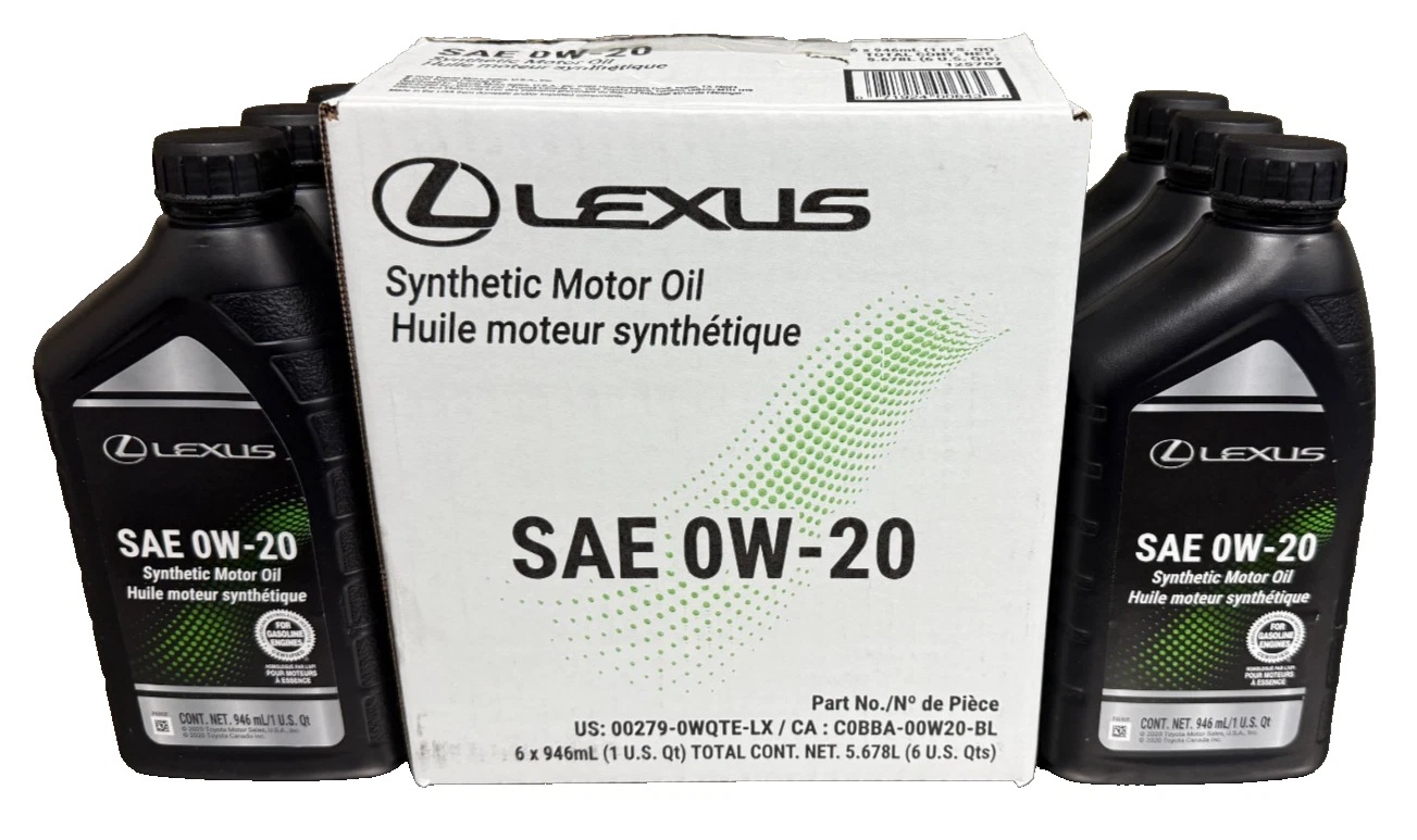

I sourced Lexus branded oil primarily because I happened to be at the dealer and price was same as Advance Auto or O'Reilly. Many Lexus dealers will run Black Friday or other holiday deals on parts, and oil is often part of that promo. I grab a couple cases when I see it on sale.

I wasn't aware there is a Lexus branded oil. I bought Toyota oil.

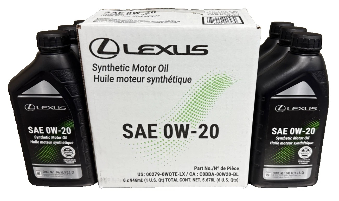

is this one?
What the part number for 0W-20 Genuine Engine Oil?
Toyota & Lexus only make one 0w20 oil, to my knowledge - it's all the same. The only differences in part number are different quantities (quart bottle vs. case vs. drum).
Buy genuine oil from wherever is cheapest. Whether it says Toyota on the bottle or Lexus - it's all the same stuff.
