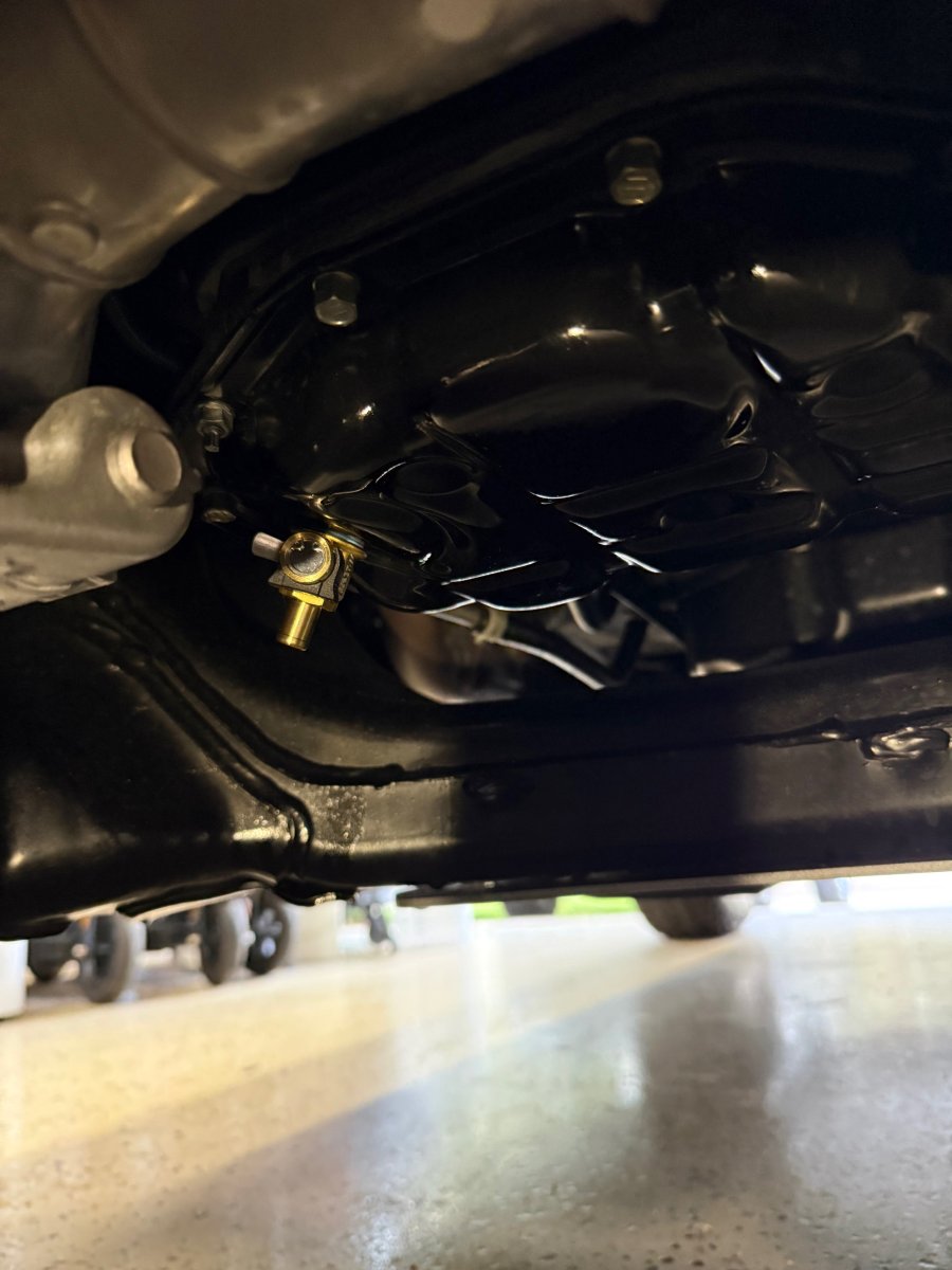

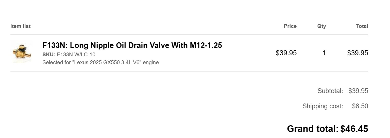

Anybody use Fumoto drain valves for their oil pan? Have one on my truck and works great, but I don’t think it’s really that big of a deal to remove a typical drain bolt so might not be worth your time.
Yeppers, I have one on my Tacoma 12 years and the Prius for 15 years with zero issues. The GX had way more room than the other 2 so I went with the longer nipple and it still has plenty of room. I was hopping I could just cut an access hole to get to it and drain and refills on 5k's and do filters on 10k's but it doesn't seem like its going to be possible.
