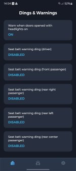

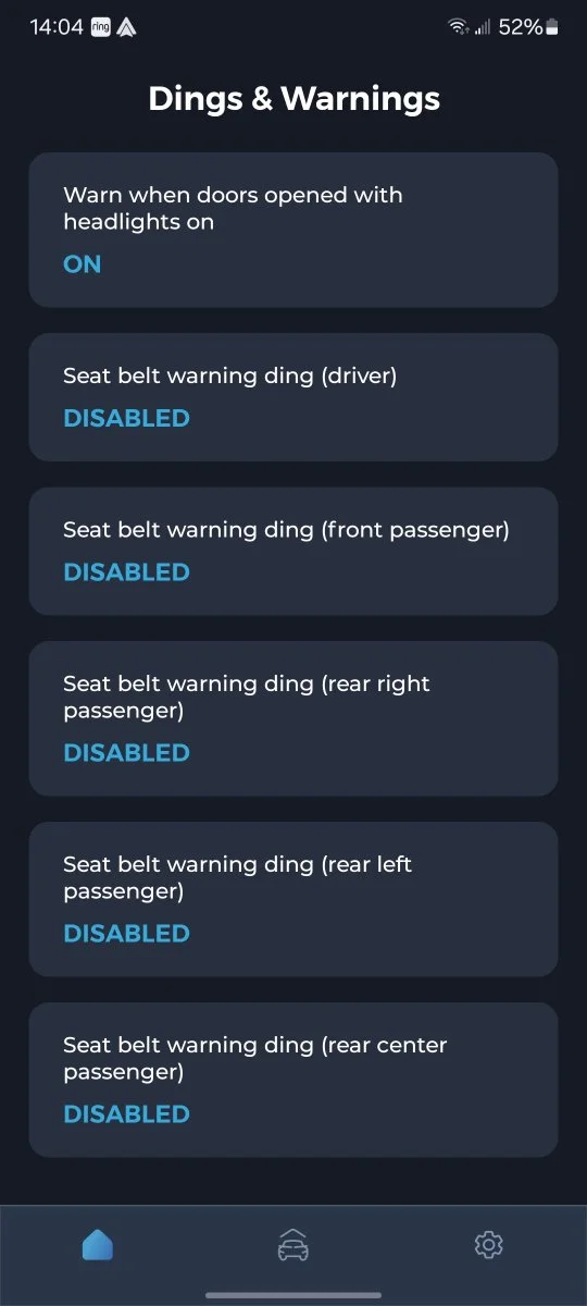

EDITED to add - this particular reader is only compatible with Android devices
My dealer wouldn't due to corporate policy so I went and found a cheap OBD2 scanner off Amazon:
Downloaded the Carista app and you're good to go. I also turned on the feature that allows you to roll down the windows and open the sunroof with a long press of the unlock button.
Handful of other options are accessible as well but these were the ones I was interested in. The dealer already turned off the fake engine noises for me at the last visit. If you're in the greater Houston area I'm more than happy to help you out while I'm on my free trial from Carista.

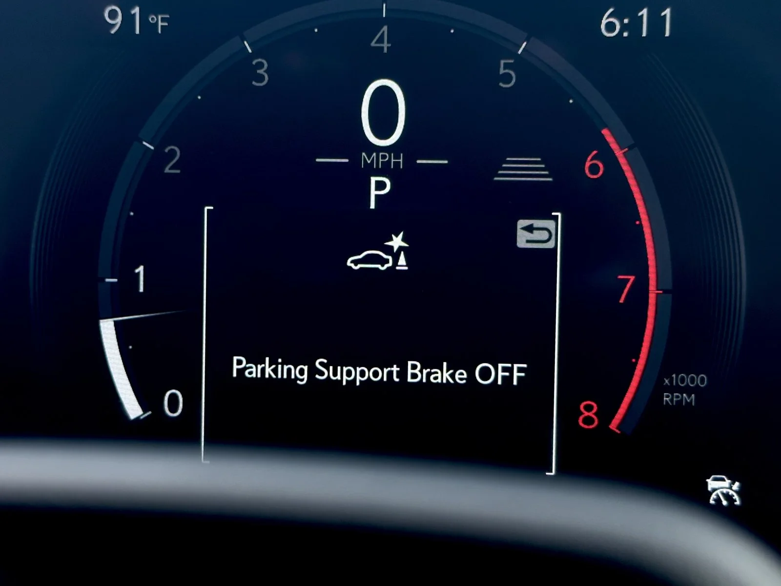

Does it let you turn off the parking support brake alert permanently. I turned the feature off but get the alert telling me it’s off every time I turn the car on.
