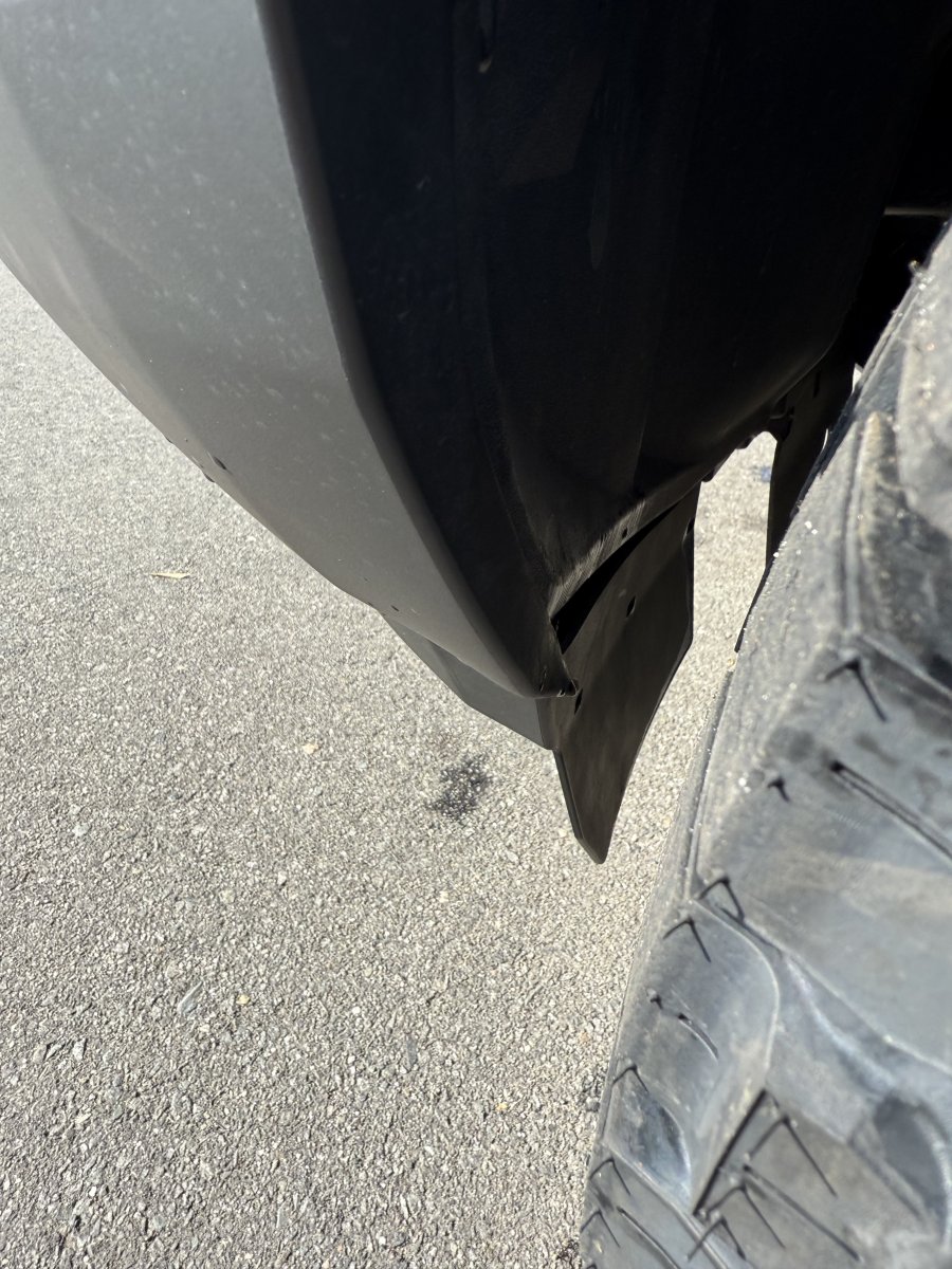

I just installed my Westcott Designs collar lift and Stealth Custom Series Gen5s (17x8.5 +20) with Toyo Open Country AT3s (285/75-17). Despite only being 34x11.5, I'm getting minor rub against the bottom of the front fender liner (not the aero piece under the bumper, the bottom lip of the actual liner). I plan on removing the aero piece, but have no interest in cutting the plastic. Has anyone done anything to pull forward the liner? Anyone with personal experience would be greatly appreciated. On my older GXs I would just cut, but not at this price point.
Thanks in advance...will post pictures shortly

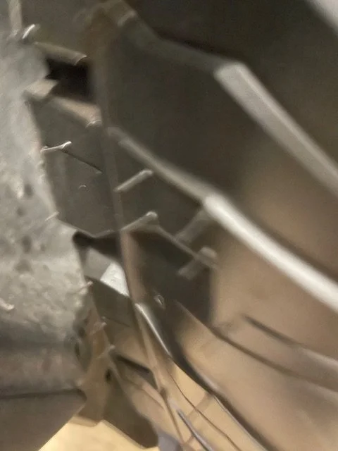

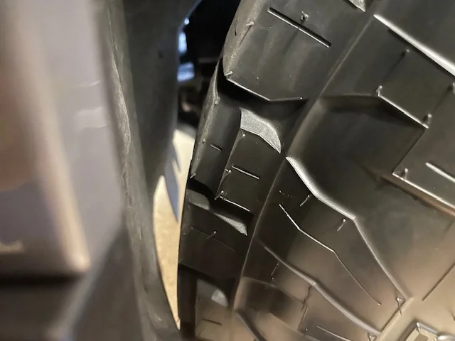

I have the same tires and lift with Method 17" wheels. I have noticed that when parked and the wheel is turned slightly to the right the tire comes very close (like a quarter of an inch) from touching but I have not seen or felt any rub. I wonder if the inner liner can be tightened to give the tire more room.
Here are a couple of pictures of my clearance with the wheel turned. I cannot feel any rub nor do I see signs of any rub. Not to say that it's not happening but if it is its only on the flap.

Thanks for the comparison. Odd that the 5mm difference in offset makes such a big difference in contact. It’s not horrible, just hoping someone has shaped or tied off the liner to give an extra half inch or so of clearance.
I've reshaped the thin plastic wheel well liner on past trucks with a heat gun (hot hair dryer works too) - heat up the plastic, put some gloves on, and push it back a bit, hold it while it cools. The plastic is easy to reshape. You can also drill a couple small holes or use a dremmel to make a couple small slits and use a zip tie to poke through and around and then anchor to something behind. You just have to get creative.
I ended up pulling the liner forward which fixed 95% of the rub then used a heat gun to reshape the inner lip of the hard plastic trim. You can see where the rub was occurring in the photo but in a 40 min drive around town since, no issues. Moral of the story, I’d recommend at least a +25 minimum if you’re doing 17” wheels and don’t want to risk rubbing.
