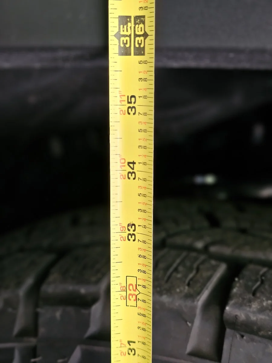

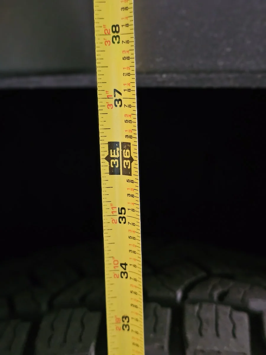

It's about 37.25 in the rear and about 35.5 in the front, so about 1.75 difference. That equates to the Wescott Designs kit taking it up 2.5 in the front and .75 in the rear for a level GX550.

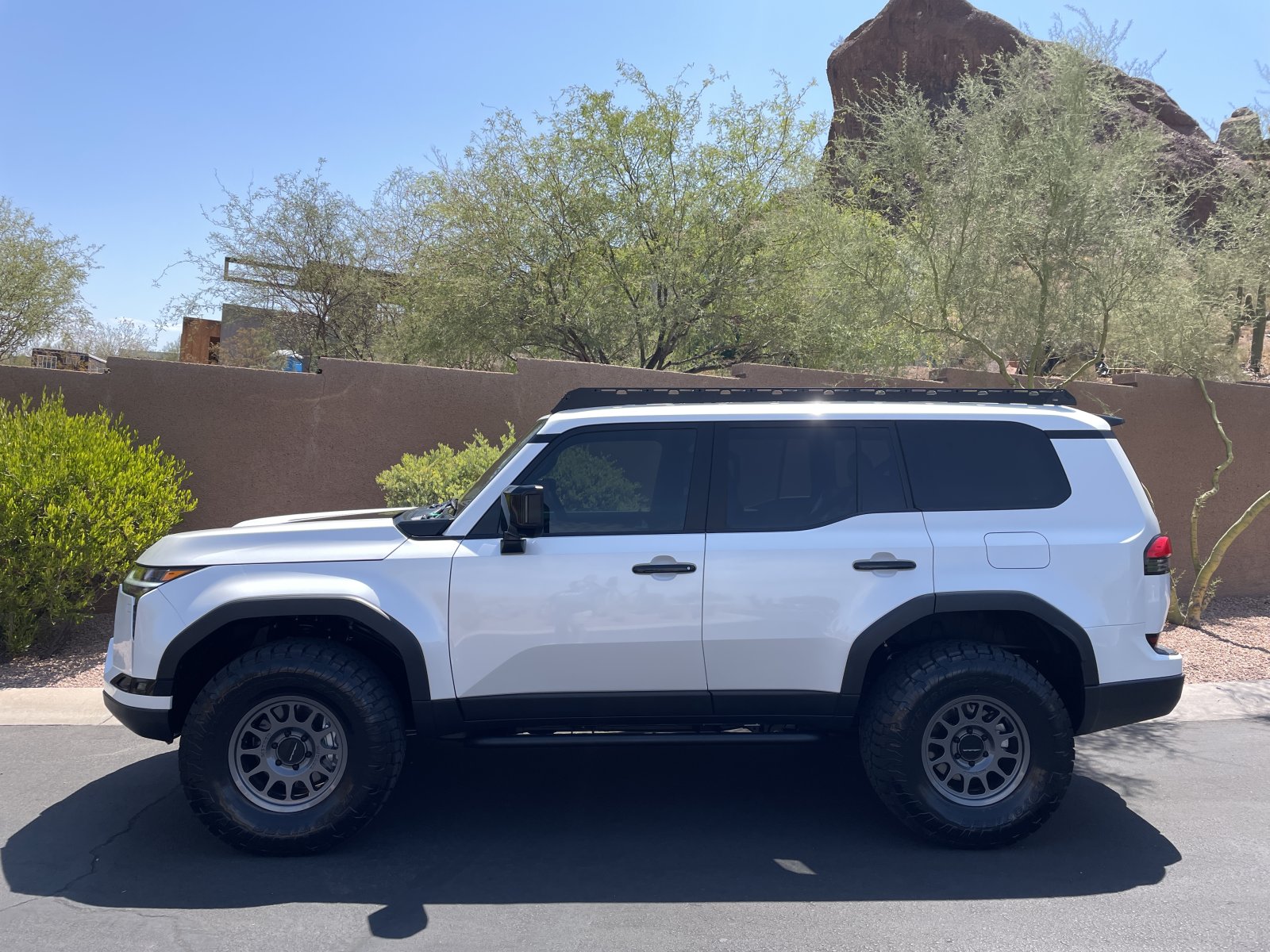

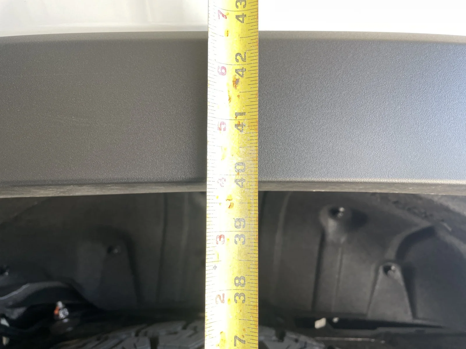

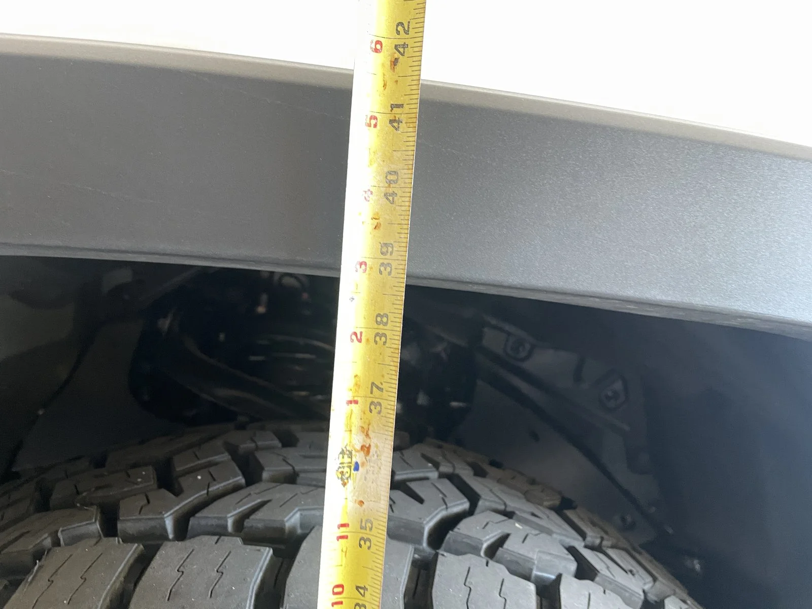

Here are the front & rear measurements after the Westcott Designs pre-load collar lift and 35x12.5x17 wheels and tires:
38-3/4" Front
39-7/8" Rear
or 1-1/8" higher rear

The top of the rack (top of the truck) after the lift and rack is:
77-1/2" Front
79-1/4" Rear
or 1-3/4" higher rear

To get a accurate height measurement you should start from the center of the wheel to the lip of the fender well. I learned this when lowering my Explorer ST and was informed by someone on a different forum. This is relevant for both lowering and lifting a vehicle. Below is more information on this from Bilstein.
True - this method takes the tires out of the equation because you are essentially measuring center of hub to fender line.
Method 703 wheels, 17-inch diameter, +35mm offset. Westcott Designs told me the specs and Westcott ordered and installed them with the new 35x12.5x17 Toyo Open Country AT3 tires in Load Range C.
