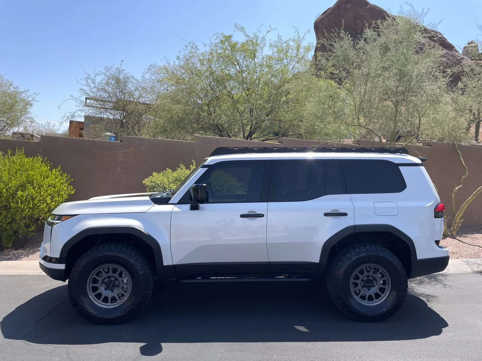

I am really loving the lift and the stiffer suspension, no more leaning on corners, turning or changing lanes. The GX handles much better over all. The front is 1.5" higher and the back is .75" higher measured from the center of the wheel hub to the lower fender.
