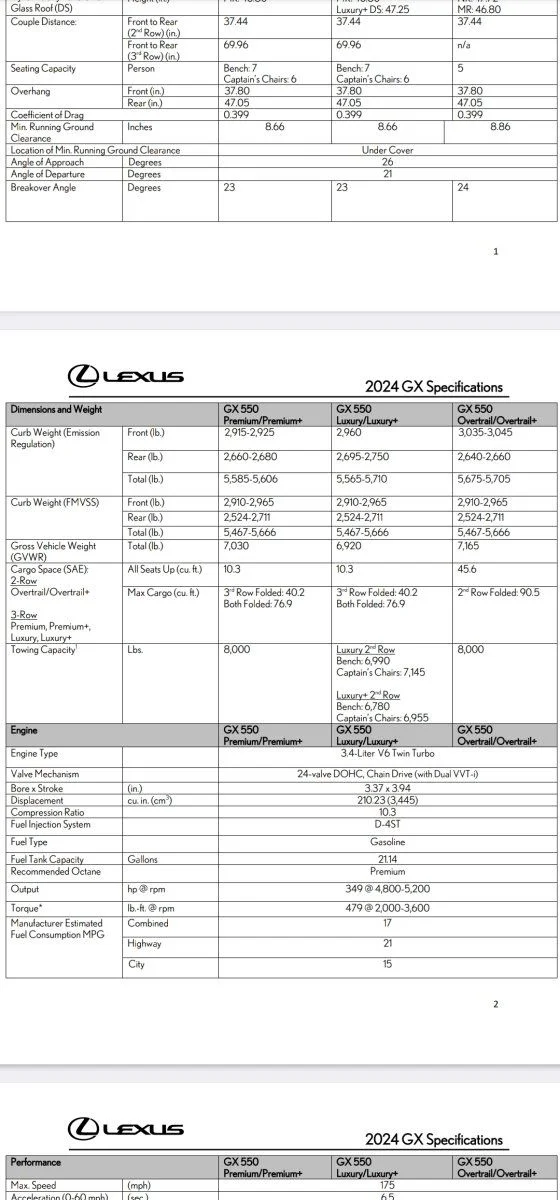

Has anyone been able to find the GVWR for the various models? I found curb weights listed on the Lexus build configurator, but not GVWR. For example the Overtrail + has a listed curb weight of 5,705 lbs., so I assume the GVWR would have to be greater than 6,000 lbs. or you wouldn't be able to fill the seats with people...... but would like to see confirmation. Does anyone know?

It's on the website under specs. I believe the max haul weight: people + cargo is 1500 lbs which is about the same as a Tundra which is awesome!
So does that mean (in the case of the Overtrail +) that the GVWR would be 5705 + 1500 = 7205?
Close, here's the specs on Lexus website if you choose to search it.
The correct answer is YES.... it qualifies and expect an 80% tax write-off if you purchase a GX in 2024.
