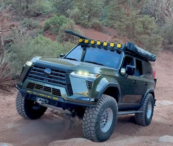

I have an Overtrail+ coming in July. Would like to get some wheels and tires to upgrade before it arrives. I've read many posts of others choice, offset, tire size, etc. and have a few questions.
First off, I do not plan to do a lift just yet, and wouldn't like to deal with rubbing or modify the wheelwells and do not want any poke outside of the fender.
I'm seeing offsets from ) to +45mm recomended.
I'm interested in the SSW Dakar Evo wheels which are as follows:
PCD: 6x139.7
Center Bore: 106.1
Color: Machined Silver
Weight: 29.5 lbs
Load Rating: 2500 lbs
Hard to tell but looks like the 0mm offset will put these outside of the fender? Has anyone put these on their GX550 and if so any issues? Also pics would be great.
I appreciate any direction on these...
That rim will definitely poke out and unless you go with a smaller tire than stock, it will need trimming. I think anything under +20 will poke from the wheel well
Depending on the tire size you go with...stick with something with a higher offset for less issues
