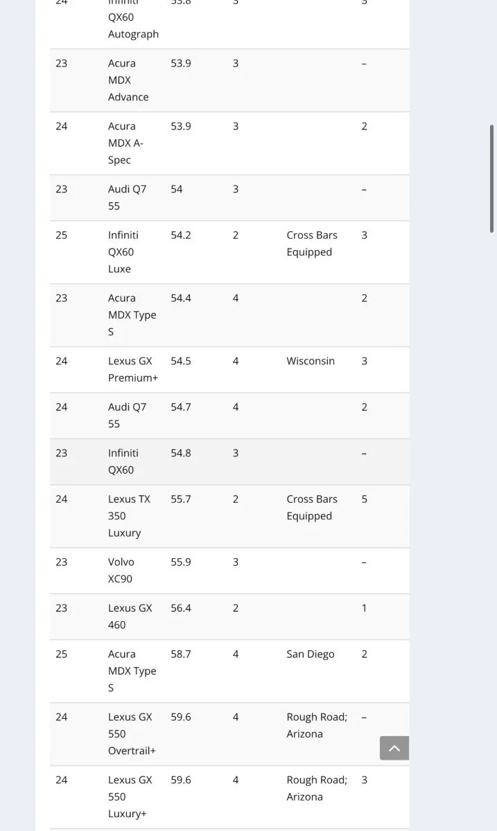

According to the car confections web site (https://carconfections.com/luxury-midsize-3-row-suvs-sound-level-readings/)it should be around 54dB or so on the highway.
