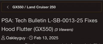

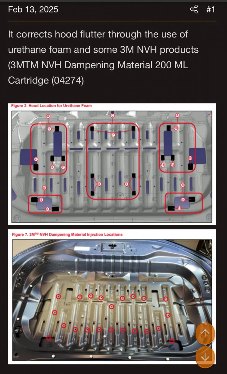

Hood Flutter Investigated and Corrected
I have an appointment with Lexus next Friday for the hood fix. Based on the below.
This was uploaded by another forum member in another thread.

This is the fix. They have the body shop add adhesive "mastic seal" to re-glue the hood skin to the frame. I had mine done in Chicago in January before driving to Arizona. I put 5000 highway miles (80+ mph) on it since the fix. The fix made it a lot better (it was unbelievable how much it moved before - and a very distracting issue with dancing reflections while driving at high speed), but I don't think it will ever be as good as it should be because the hood skin is just too thin of a gauge in comparison to other high end vehicles using Aluminum for hood to save weight. Haters will say to "get over it", "every car with aluminum hood has flutter", blah blah blah, but imo its a design issue.

They will have the body shop add mastic seal to glue the hood skin to the hood frame.
