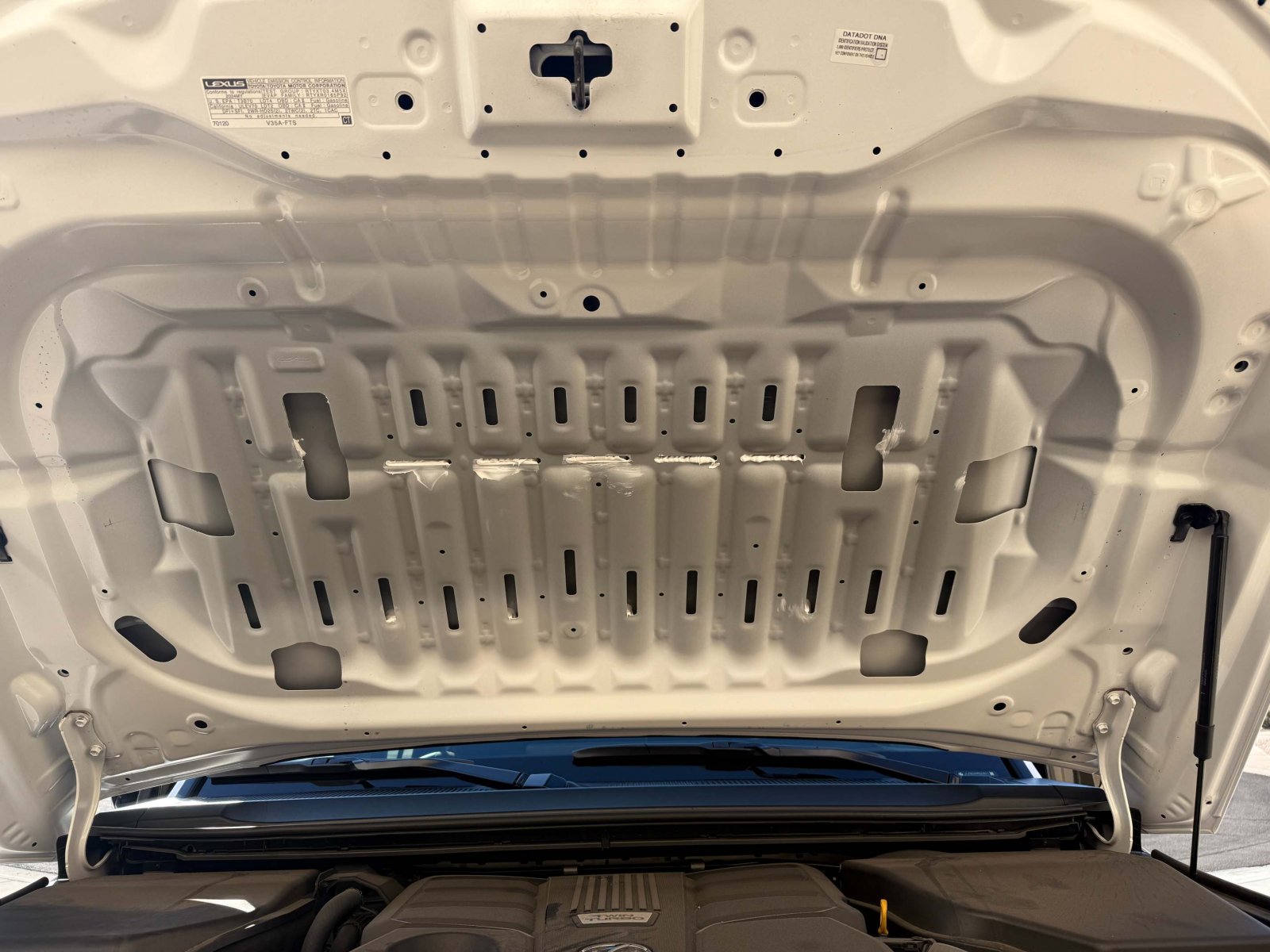

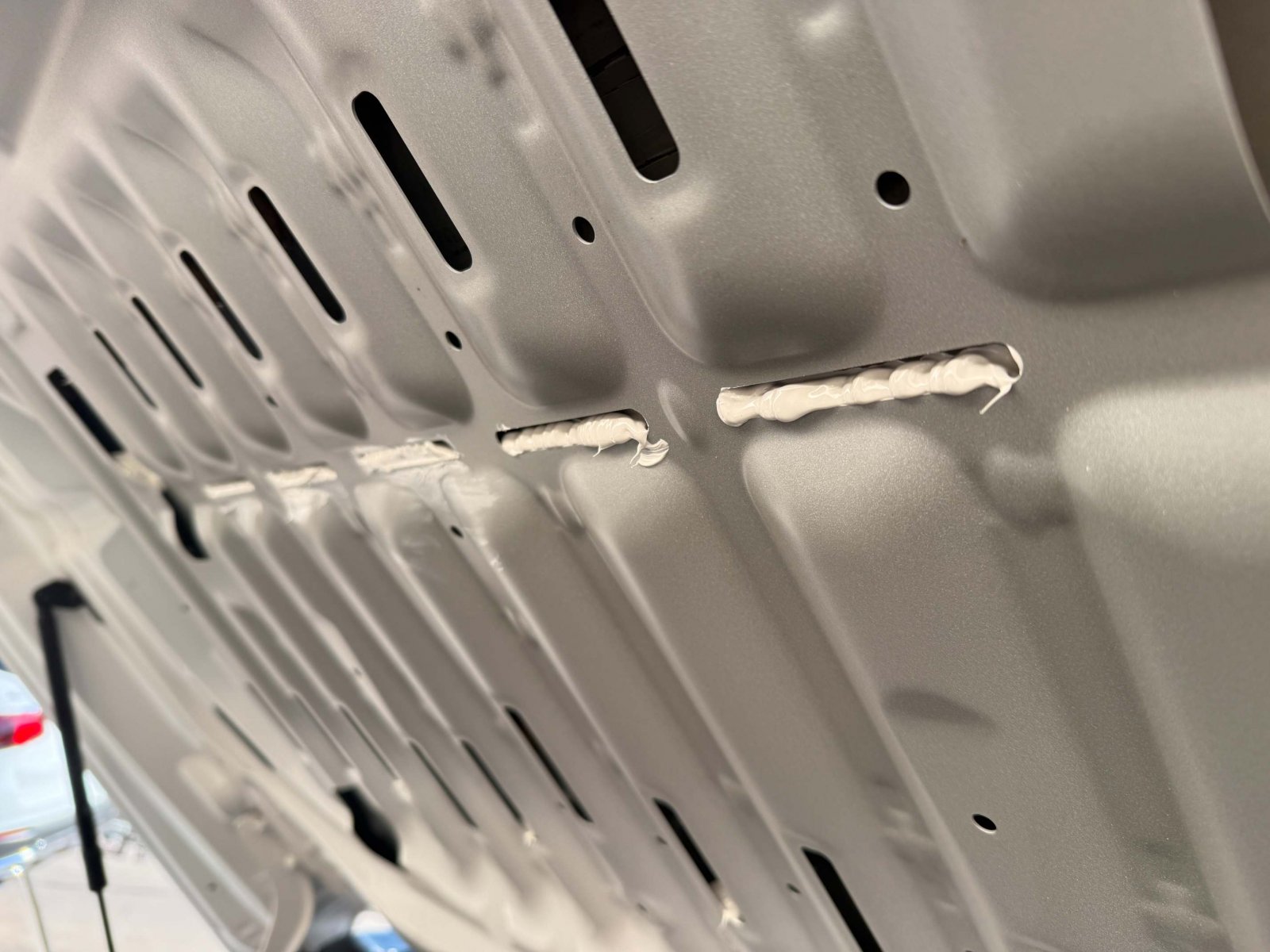

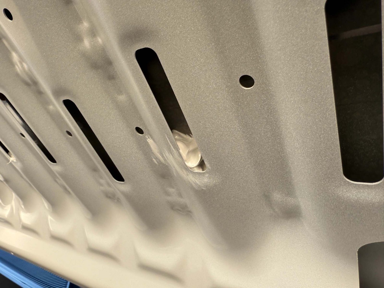

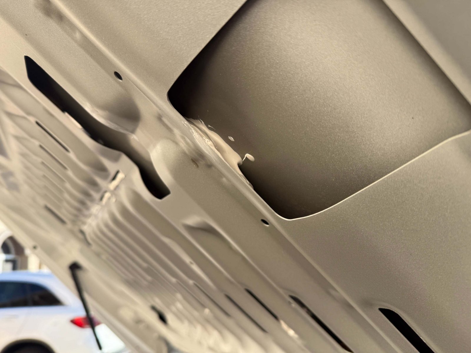

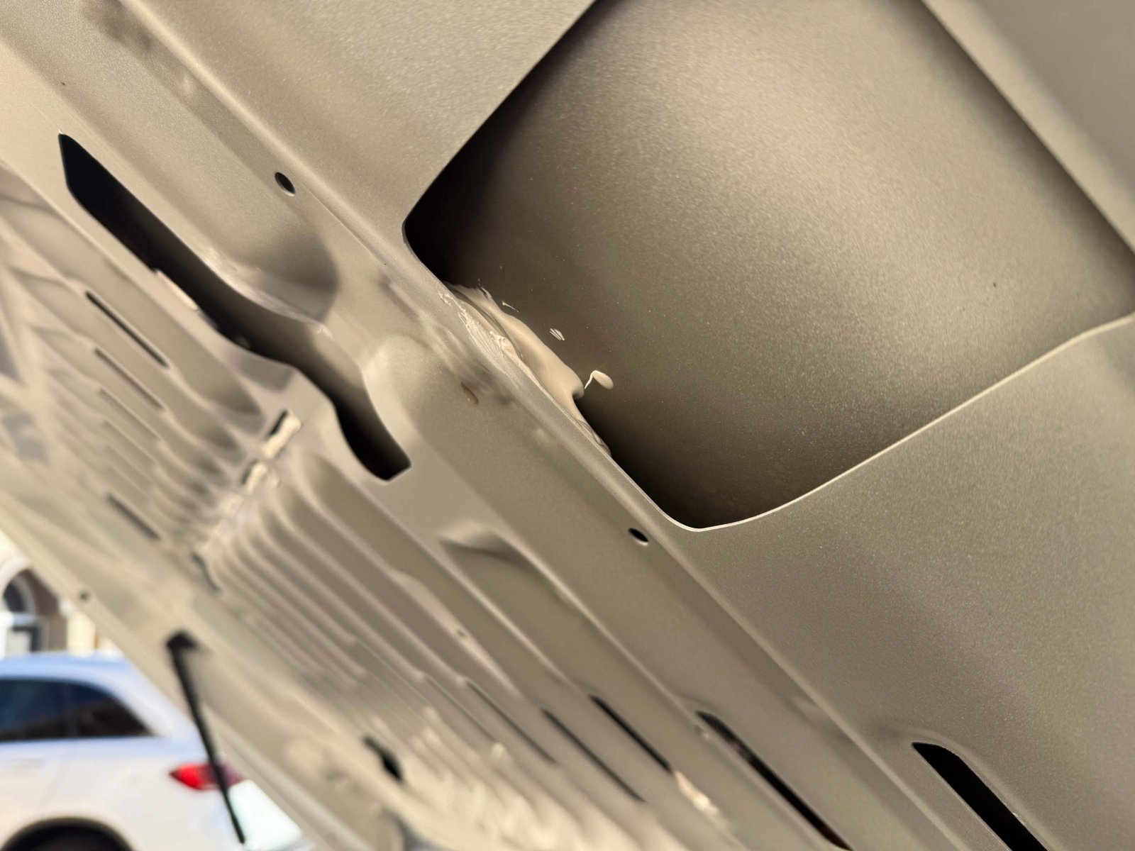

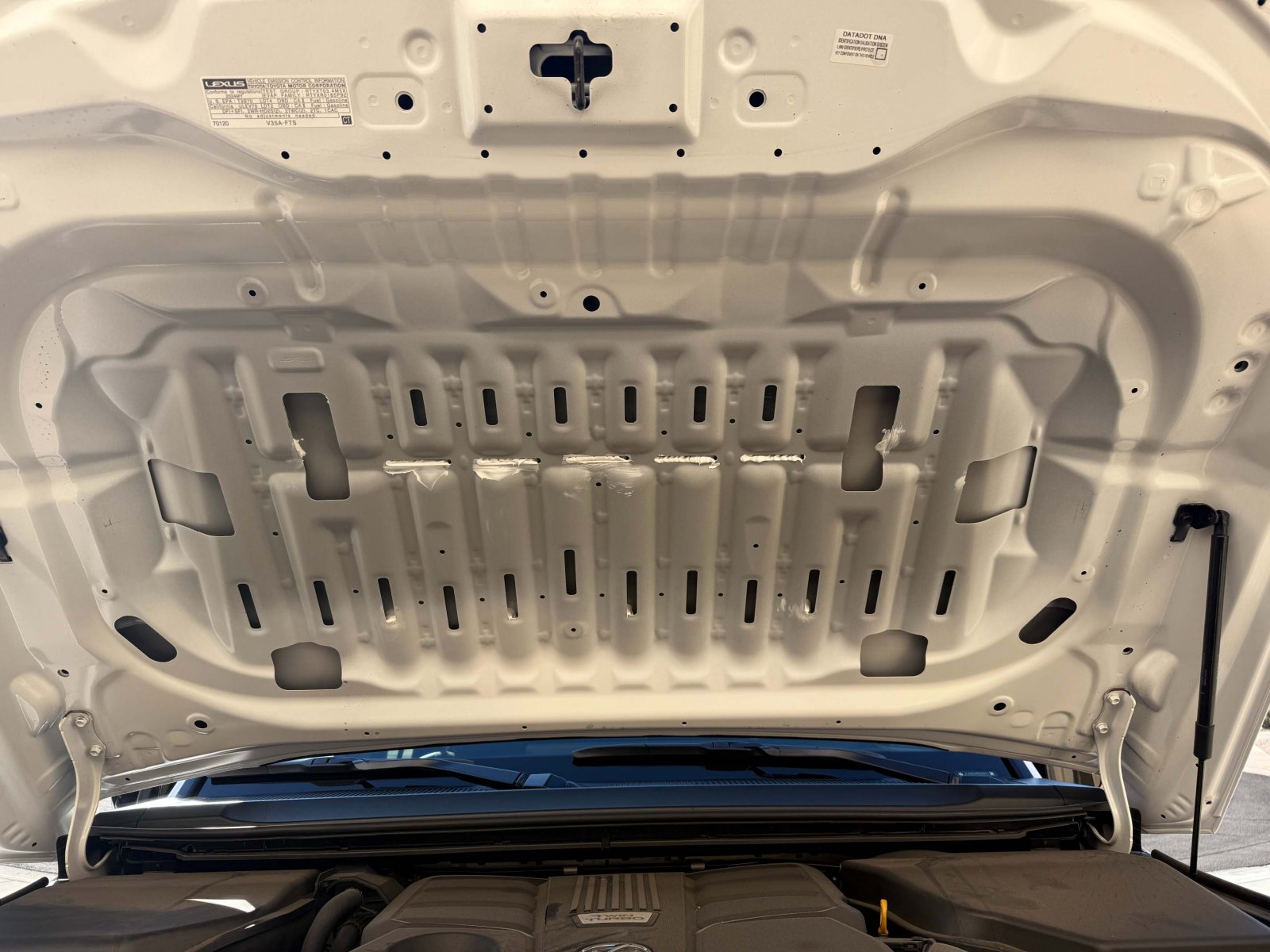

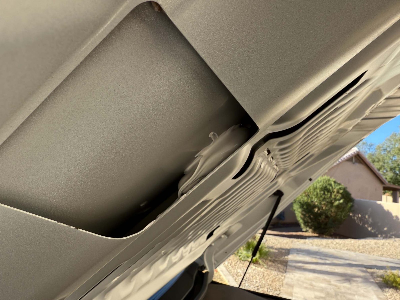

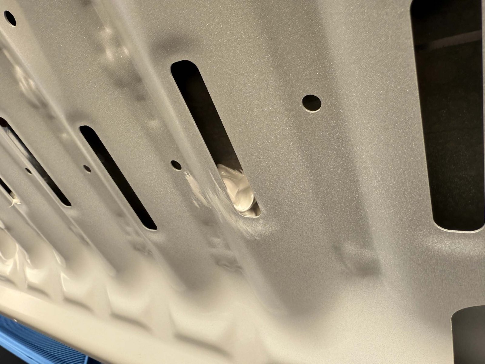

Just picked up my GX from Bell Lexus here in Scottsdale, Arizona. I took it in a couple days ago to have the front brakes replaced to cure the squeal. While I was talking to the Service Consultant, I asked if they had a solution yet for the hood flutter. He didn't know anything about it but he typed it up on my service order. The guys in the Lexus shop knew all about it and they sent my truck over to a body shop where they squeezed in a bunch more adhesive to settle down the hood (it's the white stuff in the photos below). I hit 90 mph on the short highway run home from the dealer and the hood flutter is very much improved. There is still a bit of movement but not nearly what it was before. Previously, it was like a flag waving in the wind.
So that's that. I'll re-install the fabric & cardboard panel now and call this one done.

View attachment 7625View attachment 7626View attachment 7627View attachment 7628View attachment 7629
Thank you for sharing these pictures, very informative

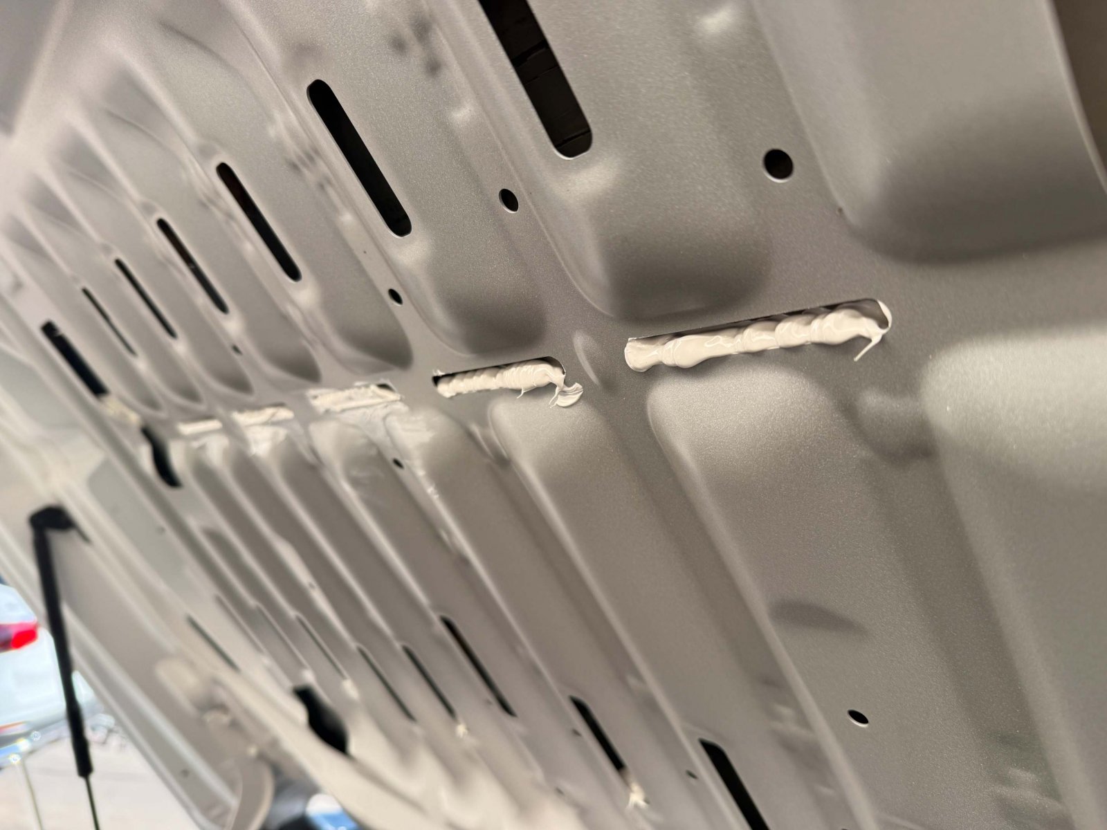

That is good to know!
Do you happen to know the name of the particular adhesive they used?
Some of us may need to take it to the dealer/body shop and ask for it specifically when showing these pictures.
Thanks!🙏
I have no idea and it's not on the paperwork. Lexus took it to their preferred local body shop - they don't do body work at this dealership. I can certainly ask, though. It's white goop that's still a bit soft to the touch.

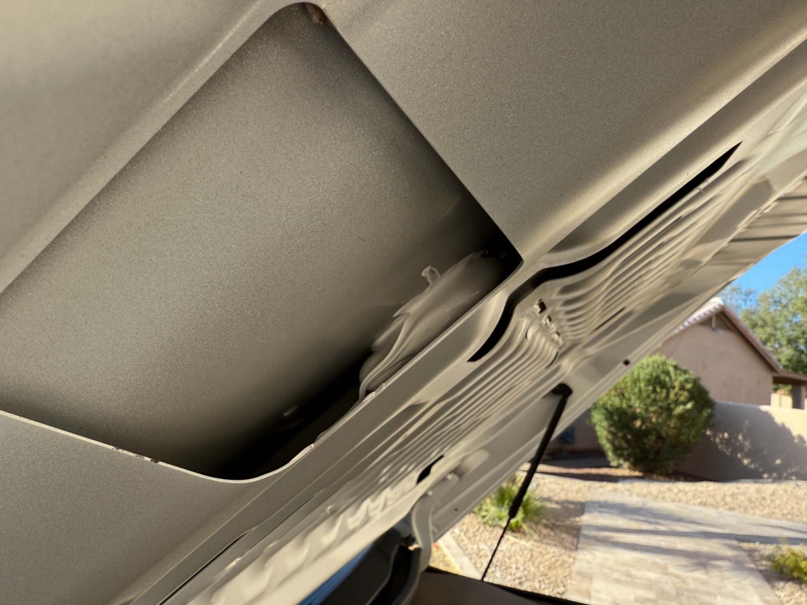

So, the underside of the hood panel is actually highly-engineered. Lots of structural bends, air flow slots, etc. On the topside of the hood, the outer wheel-location humps over the fenders have bends that obviously define the fenders. These major bends on each side give it plenty of rigidity in this area. Furthermore, there are little rubbery plugs that wedge between the low sides of the fender bends and the inner hood structural panel, which supports this bend line from below. See the pics below.
The problem is apparent: the topside expanse in the middle of the hood appears to be completely unconnected to, and unsupported by, the underside structural panel. Coincidentally, this is the part that flutters at highway speeds. This topside expanse is about 40" wide across the hood.
It looks like sound deadening paneling (butyl or foam padding) is not going to work because you can't apply it directly to the underside of the topside, if you see what I mean. The inner underside structural panel is in the way.
I'm thinking that some rubber spacers stuck in there (like the factory rubbery plugs already installed under the bends) would do the trick to form a wedge between the inner structural panel and the topside expanse. Or, maybe even easier, would be to spray some heat-resistant expanding foam up in the little cutouts all across the expanse. I wonder if this would bulge the hood? Probably not if you let it just expand freely and ooze out the little cutouts and the sides, then trim it clean. Would really suck to bulge your hood trying to fix a flutter...LOL. Maybe just stuff some thermal batting up in there?
