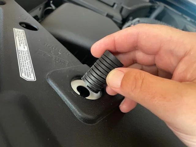

So this morning, I followed an advice from one of the Facebook groups about raising the hood adjusters (rubber screws) and it worked. I did try this in the past and it didn't help. The reason was that I was a little gentle with the hood when trying to close. When it didn't fully latch, I would lower the screws more until it closes with a gentle/normal push. So the difference between the new height and original was not really that much, hence, it didn't make much difference with the fluttering. However, this time I closed the hood with more force so I was able to raise the screws higher.
Conclusion: Raising the rubber screws does help by allowing more air to escpace leading to less fluttering. I tested this driving at 75mph or so in opposite directions and the fluttering is definitelty less. I measured the new height for the screws, about 2cm from the top of the screw to the plastic frame around it. Hope this helps.

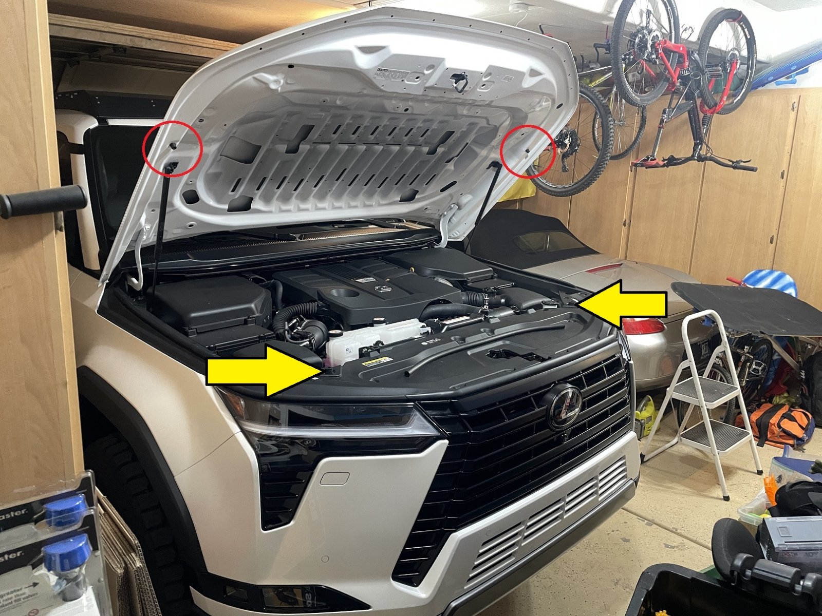

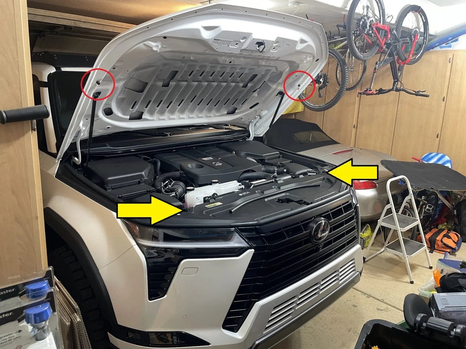

Can someone show a pic of these rubber feet? I can’t find them.
I'm pretty sure it's just these:
I just popped my hood up to let it cool down a bit and I'll mess with them in an hour or so.
Oops, just looked under the hood - the rubber feet are actually the yellow arrows below, looks like you can twist them to extend them up a bit more, the rubber twists into a slot.

I twisted out those rubber feet until I could barely get the hood closed. It did help with the flutter. It's more of a hood jitter now, it bounces up & down a bit across the middle. Before it was fluttering/rippling/waving like a flag in the breeze. Will be at the hardware store tomorrow for a few things and will also check out rubber spacers/plugs/etc.
Thanks. I messed w those a bit but it didn’t seem like they were raising, that’s why I was wondering if it was somewhere else.
