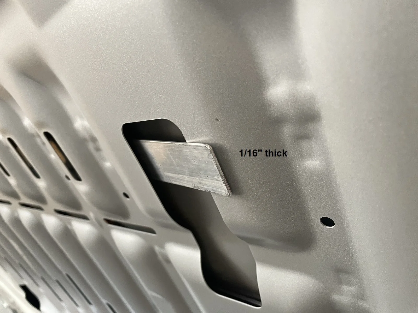

So the hood flutter is pretty much gone - the whole hood still shakes a bit up & down at around 80 mph but the waviness in the center panel is gone.

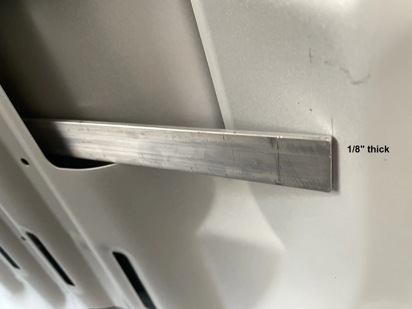

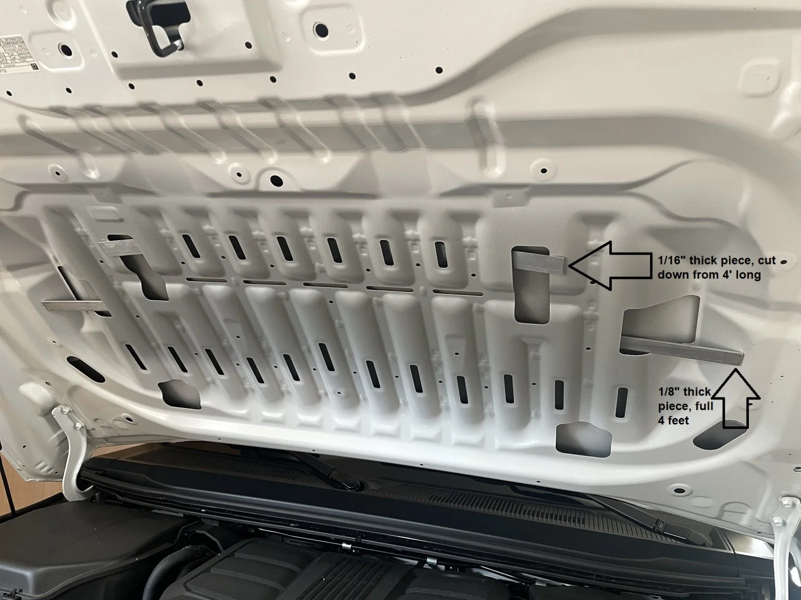

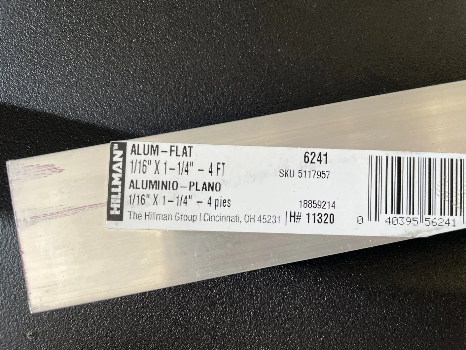

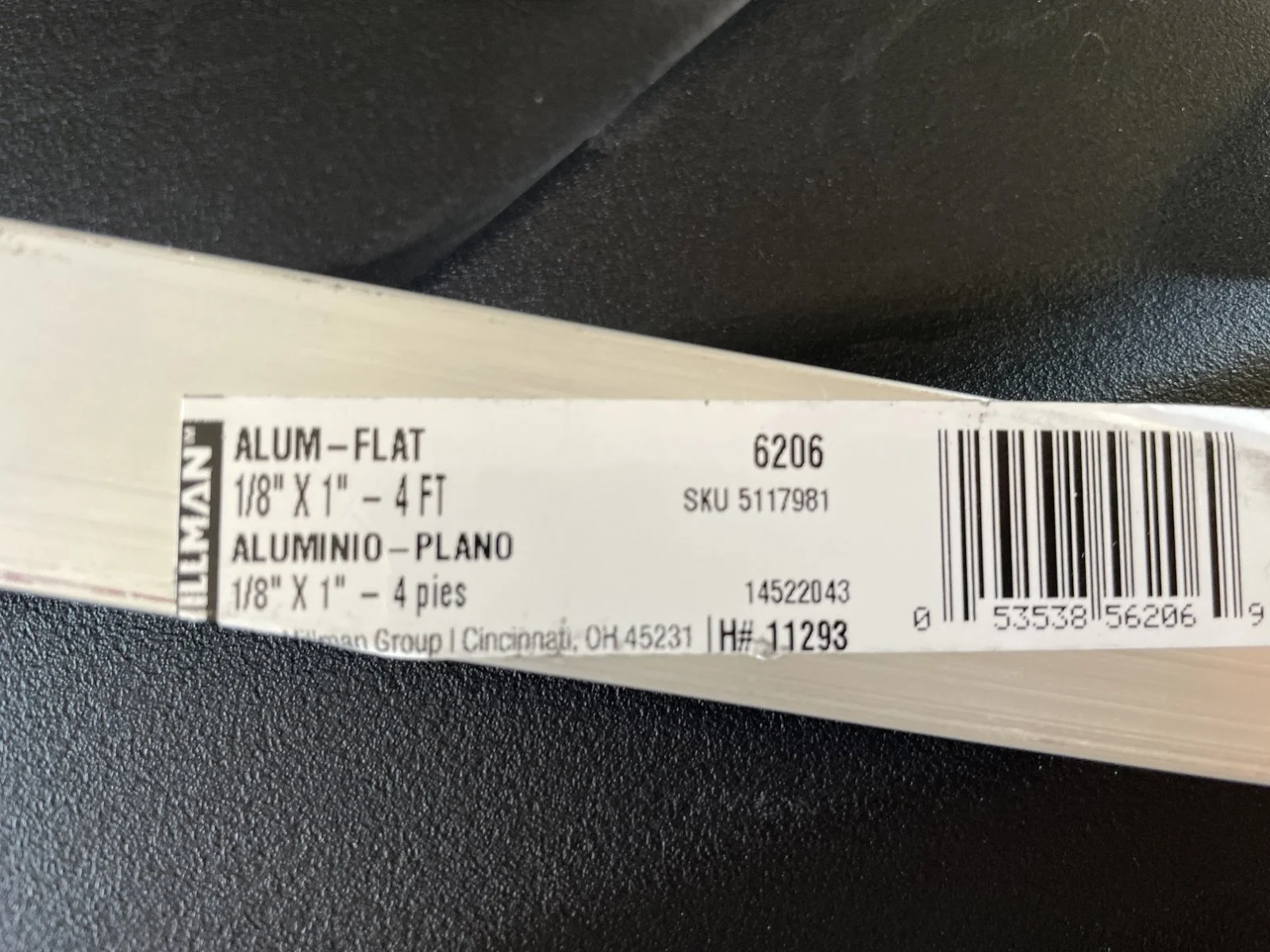

What I ended up doing is sliding in some long, thin, flat aluminum that I had sitting in the corner of the garage. I had a piece of 1/16" thick X 1-1/4" wide X 4' long stock and I slid it in behind the inner structural shell and the outer skin - the piece of aluminum makes a bow shape when the ends are wedged on either side of the structural panel. The bow shape gently pushes on the outer hood skin.
I went to the hardware store and picked up two more 4-foot lengths of thicker aluminum (1/8" thick) and less wide (1" wide) because I thought the 1/16" was a bit too weak and the 1/8" would press more firmly on the outer skin. When I tried to slide the 1/8" in the upper portion (see the photos) it was too stiff and you could see it pushing out the outer skin from above. I didn't want to crease or dent the outer skin so I didn't push it. I cut down the length of the 1/16" thick piece and slid it in the upper, shorter section and I used a 1/8" thick piece (full 4-ft length) in the longer middle section. The way the openings in the structural panel work, the longer run bows the piece of aluminum less, so the thicker piece works here. I also slid some cardboard between the ends of the longer run of aluminum because it was scratching the white paint. It's all covered so it really doesn't matter but I don't want to have the aluminum dig into the hood.
I'll let this ride for a while and see how it goes. Maybe another 1/16" piece slid in there through a set of openings might help.
