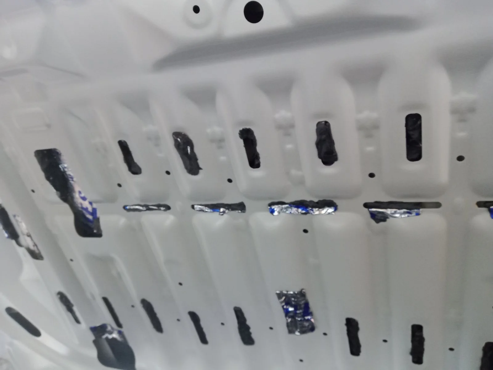

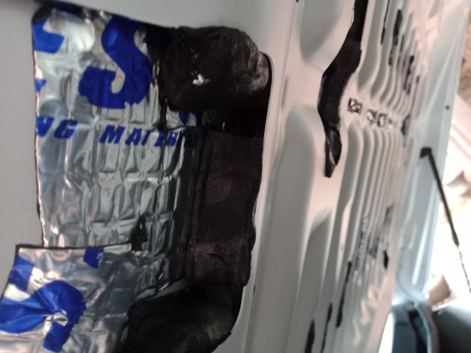

My hood flutter made me nervous LOL, like I hadn't closed the hood completely. I had a hood fly up and cave my roof in once so maybe that is why I had to fix it LOL? I had some very sticky self adhesive sound deadening material which I cut into strips rolling them up into little logs. I stuffed them into the slots in the hood forcing very solid contact on the surfaces. This stopped the flutter for good. To bad they tried to save weight with the aluminum hood only for me to have to add it back in a $75,000 dollar SUV?? Hood sounds more solid when I close it now! Now I have to work on those tinny sounding doors as I already sound deadened everything from my front seats back. It is much quieter now as Lexus didn't sound deaden the back wheel-wells at all?
I have checked before and after sound with a db meter. The sound level drops a few db but what helps me is quieting the high frequency noises and the lower frequencies that are left are not near as annoying YMMV.

Good job. Do you think the sound deadening material will be ok in there with the engine heat?
So far so good on the heat. The deadening has thick aluminum foil backing and the hood pad will shield it some and would catch anything that came loose. The heat will make it stick on better also. Another thing is that the surface area is widespread to the cold air traveling across the hood, and it will act as a heat sink to the rubberized material (my GX550 is white). You can feel the foam rubber blocks that Lexus placed between the hood skins so I feel this solution will be as high temp. oriented as that material. It looks to me Lexus used to soft and not enough of that material to stop the hood flutter at high speeds.
