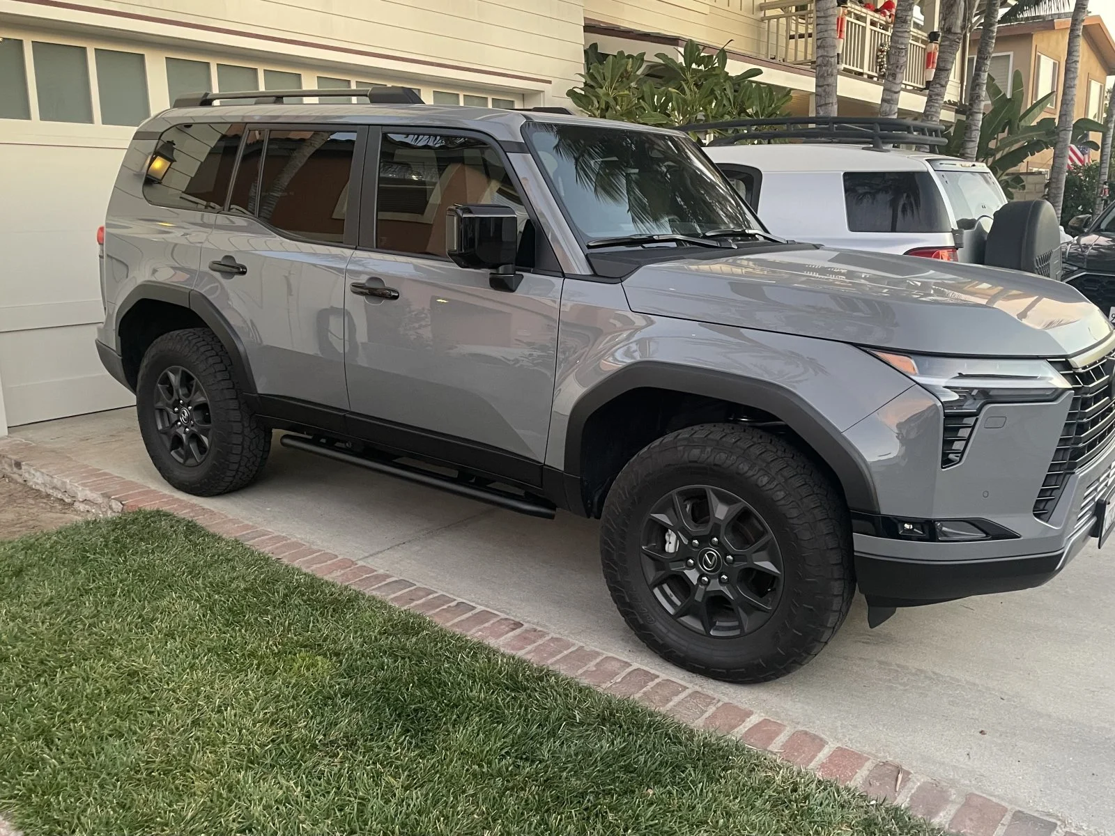

I just installed the Peak Performance 1.25" top hat spacer to level my Overtrail. I think it turned out great and I am really happy with the results. I have leveled numerous trucks including my 4Runner, F250, F150 and Tacoma. I do not like the look, or performance, of raked truck - higher in the back then front. Vehicles come this way because manufacturers think they get better mileage. I have never seen an appreciable difference in mpg in any truck I have leveled, not lifted.

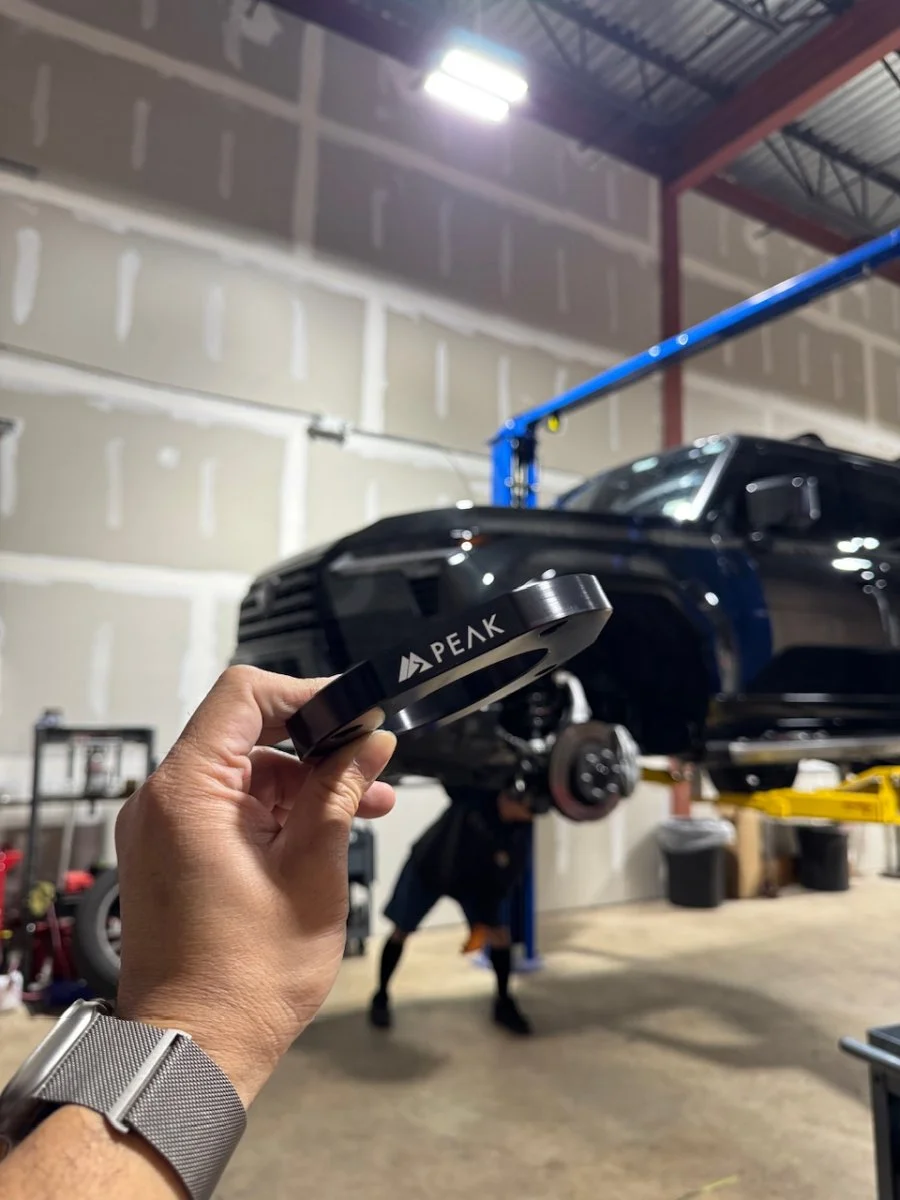

Here is what I did to get my spacer in.
  • Remove 3 AVS shock connector bolts
  • Disconnect shock AVS connector (kinda difficult)
  • Remove 4 upper shock bolts
  • Remove the lower 2 knuckle bolts
  • Remove sway bar end link from LCA
  • Loosen LCA mounting bolts
  • Loosen lower shock bolt
This gave me enough room to get the spacer in.
Then put it back together and tighten the following at ride height:
  • LCA mounting bolts
  • Swaybar endlink
  • Lower shock mount
  • Upper arms mount should be loosened and tightened too.
My 8mm spacer gave me 5/8" of increased height. Pretty sure this won't allow the shock to bottom out before the lower arm bump fully engages.

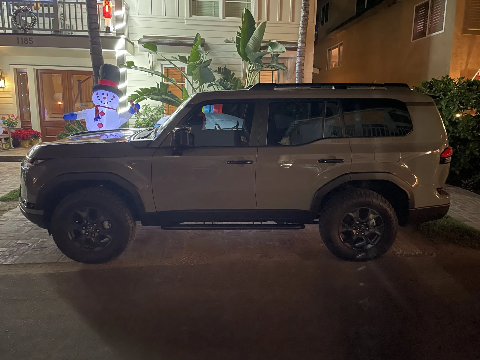

Any impact on the feel of the ride? I came to my OT+ from a pretty heavily modified 4runner. All the lifting and tweaking on that vehicle made for a very attractive stance, and lots of trail clearance, but at the cost of the ride comfort. The GX is just so buttery smooth, i'm hesitant to mess with it, even though i would really like to level off the rake. I don't care for it either.
I have not noticed any difference or harsh feel. I also had my 4Runner leveled by installing bielstien 5100 series shocks in the front and noticed a ride difference. I have over 1,000 miles since the peak spacer install and I am very happy. I did have to adjust m headlights after install.
