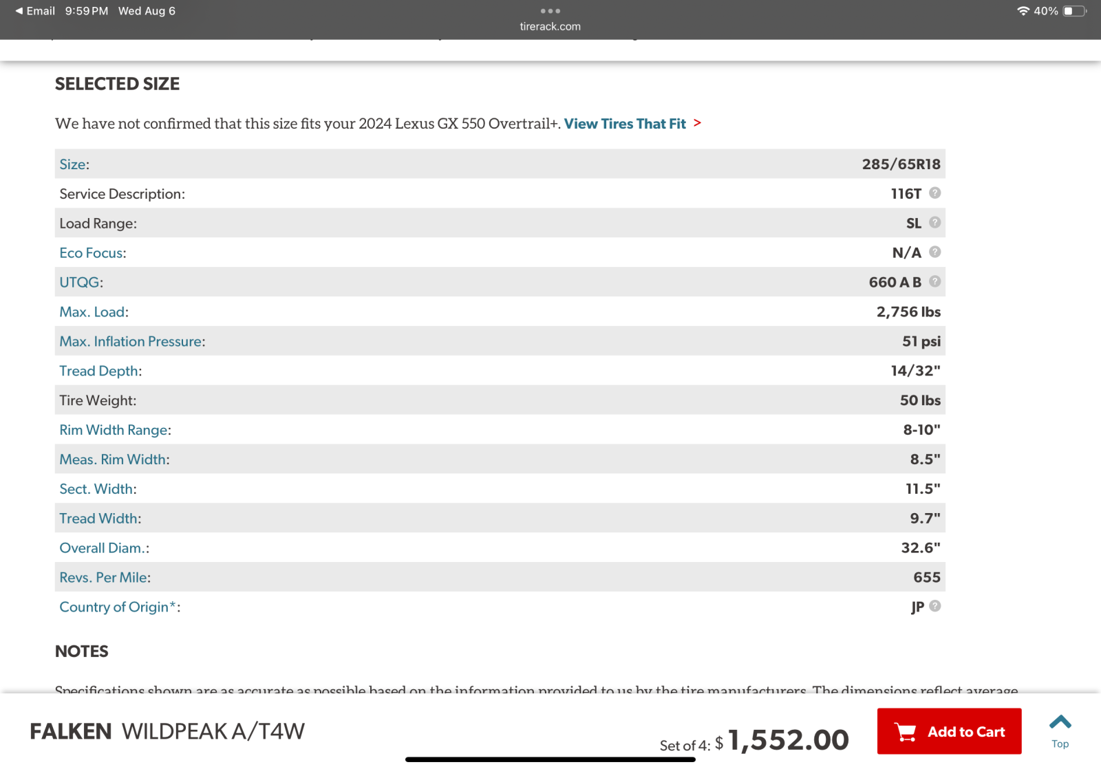

Thank you all for the feedback as it’s been super helpful! I did end up ordering the AT4w in the ‘SL’ load and the weight is only 50lbs per tire, which is roughly the same as the ‘E’ load K03s at 285 65R18s from what I found.
My hope is the ‘SL’ load will be “softer” than the ‘C’ load mentioned above as the latter is closer to an LT tire and heavier as mentioned. The ‘SL’ sidewalls are 3ply so I assume they will not be as smooth as the 2ply OEM Toyo AT3s on my Overtrail but better than the KO3s.
