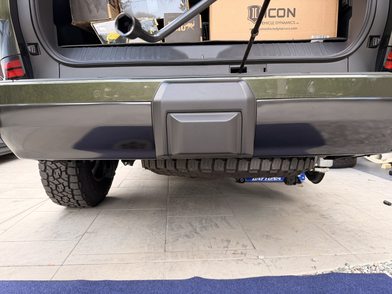

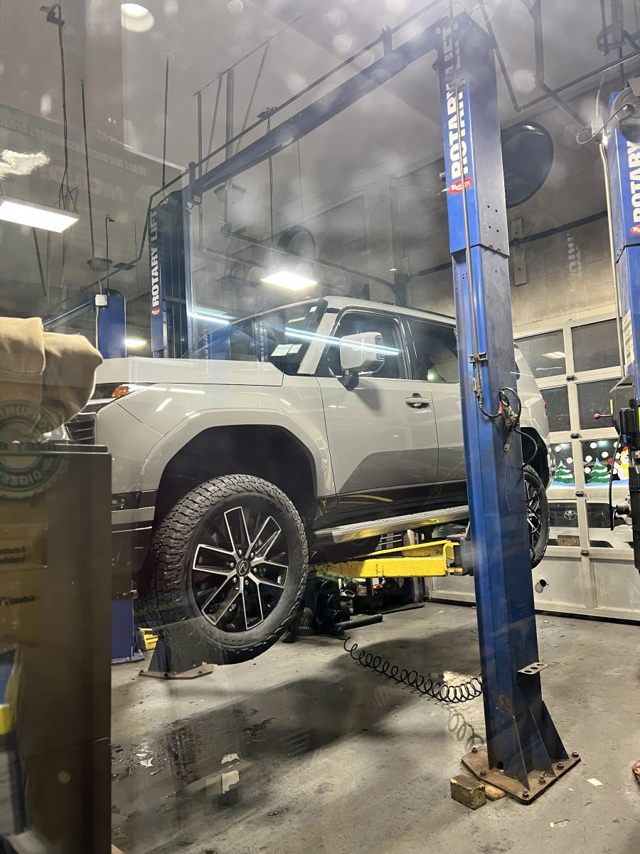

I went with Cooper Discoverer AT Road & Trail 275/60R20 and the spare fits no problem. Everything I have read says don't drive with a mismatched spare.
img_6565-jpg.18814

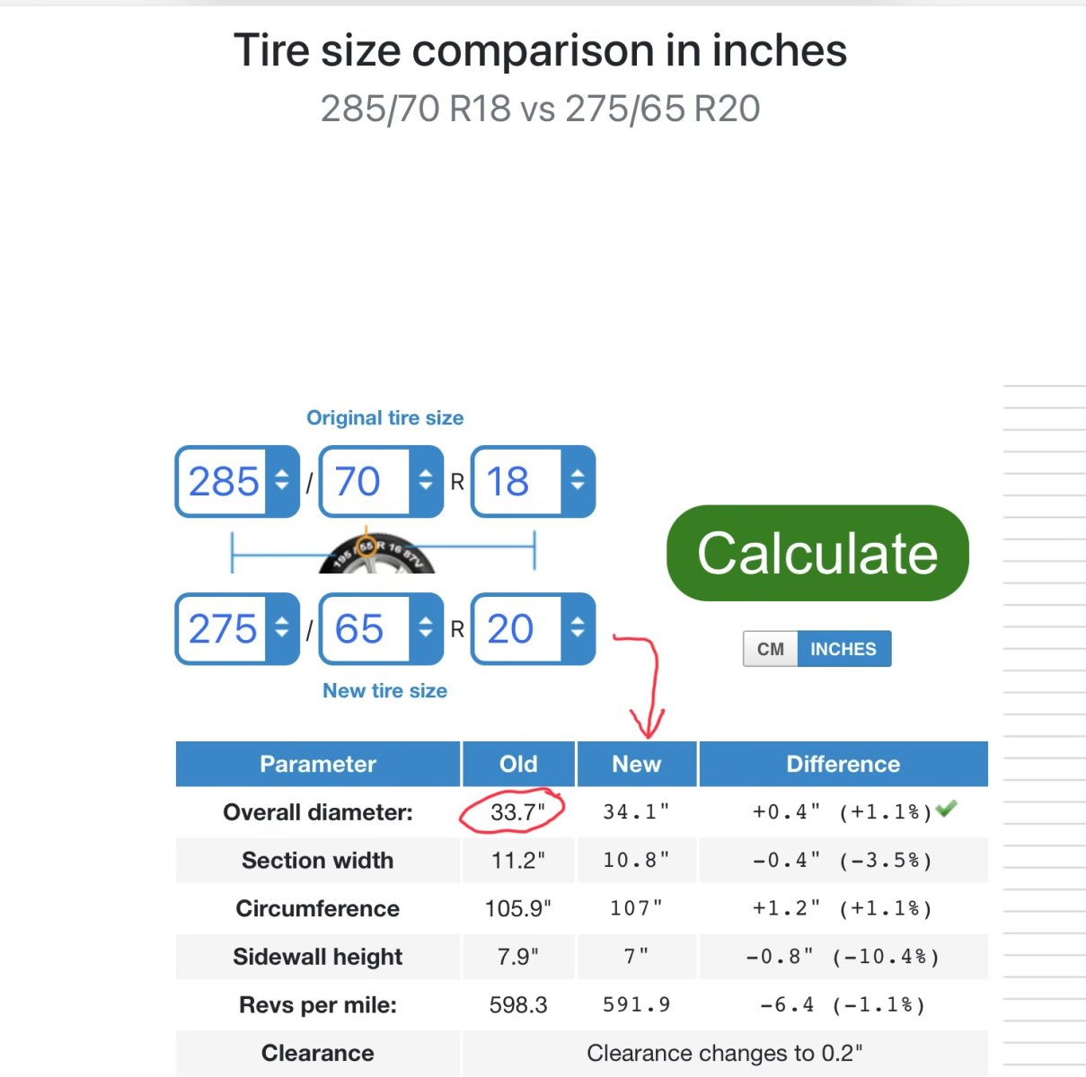

I have a spare that is 33.7” inflated, and it just barely fits at normal inflation. That’s on my ‘24 Overtrail using the OE OT wheel. My spare is nudged in tight and is up against all touch points including the very back of the hitch receiver.
I don’t know if there are diffs at the 3 or 4 touch points up inside the spare tire space of non-Overtrail models.
I’ve attached the size comparison you’re asking about.
There is a slight possibility the size you’re asking about might fit most of the way upwards if deflated to low pressures.
Good luck.
EDIT: keep in mind the numbers shown are nominal only; final fit could easily vary between diff brands, model of tires.

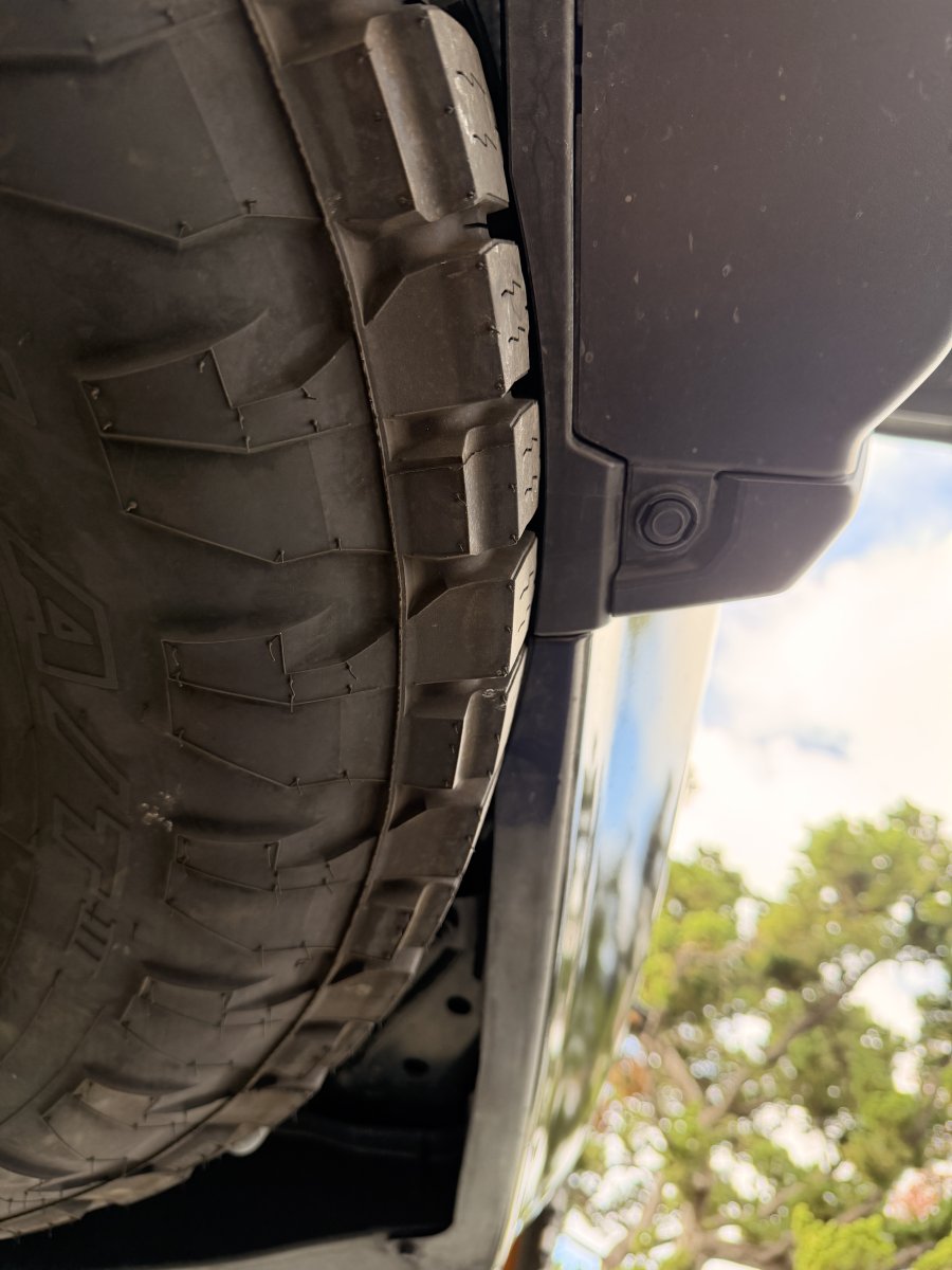

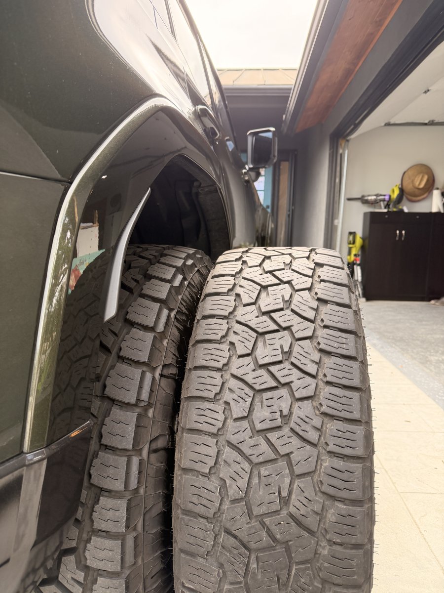

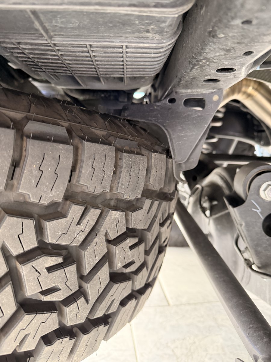

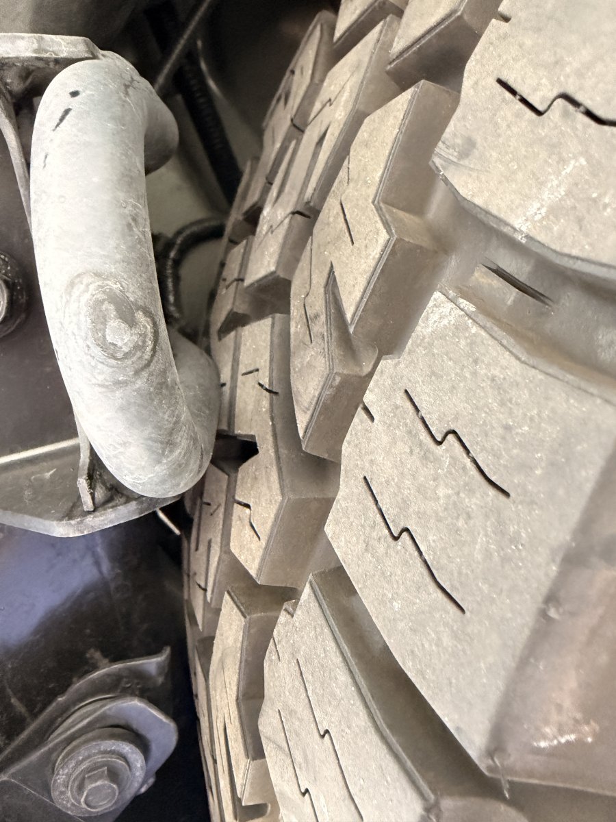

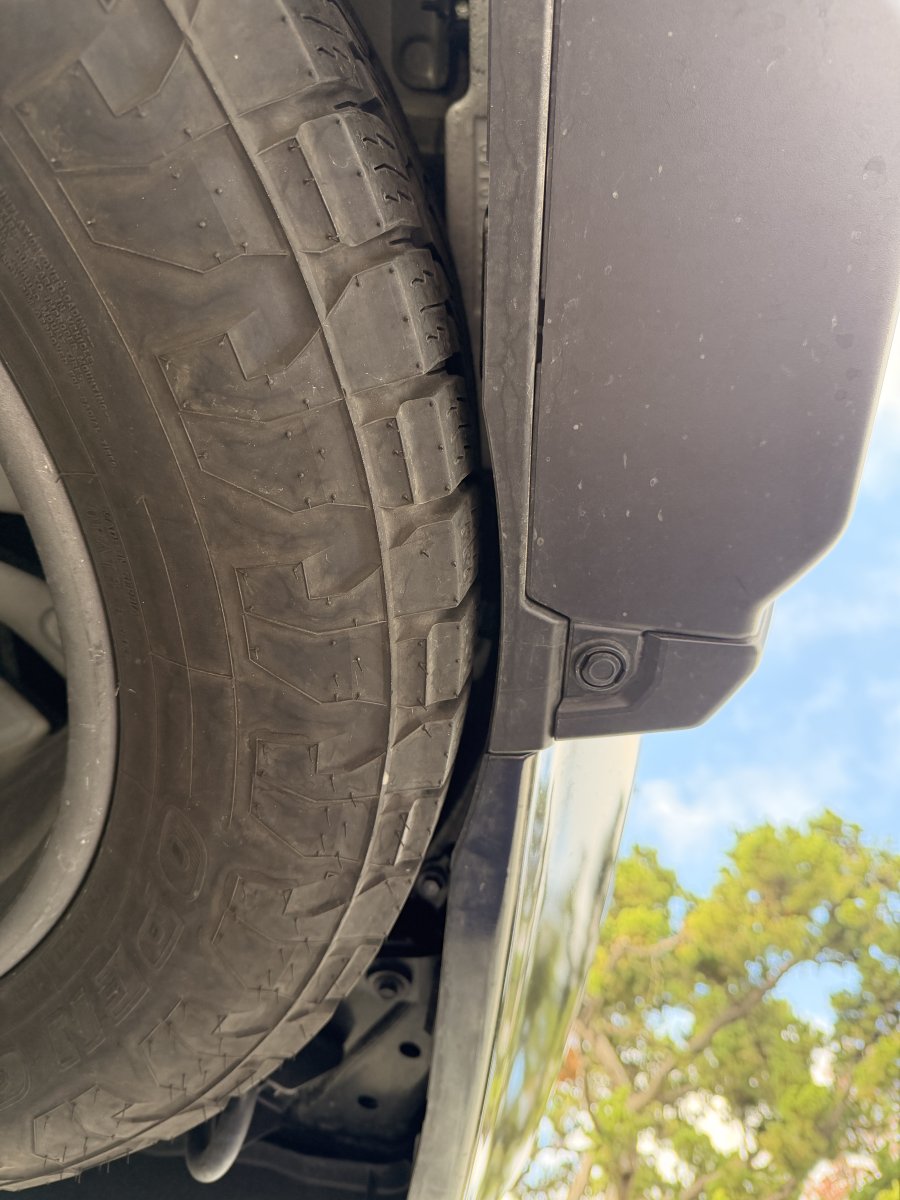

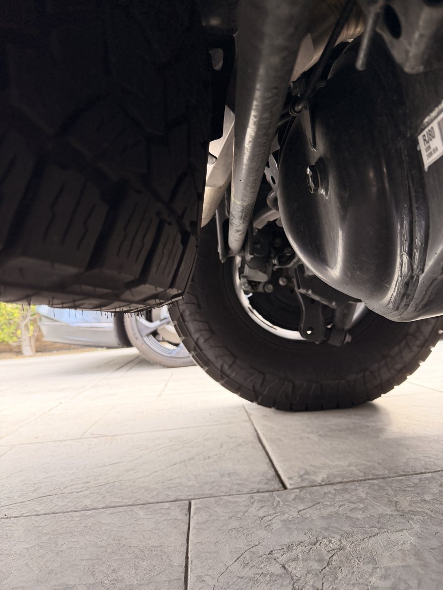

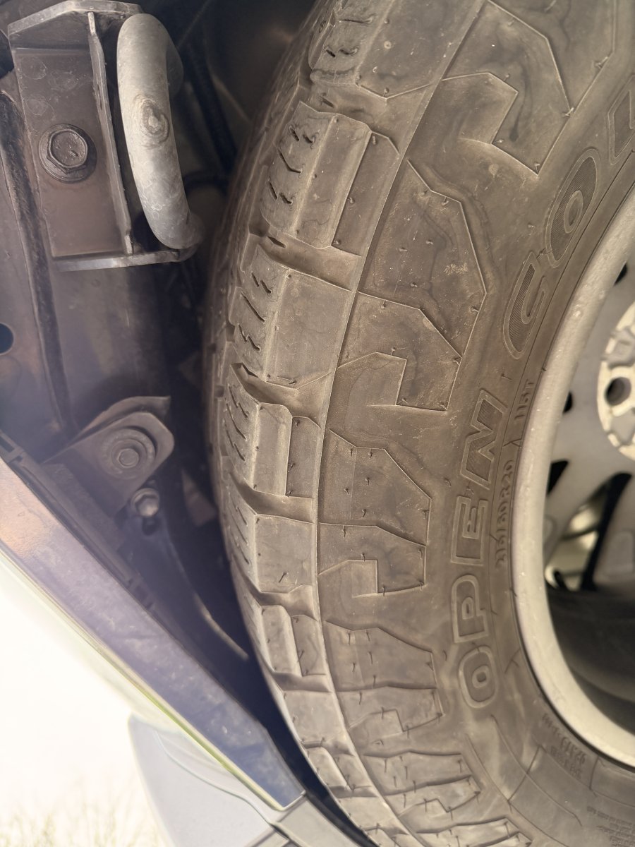

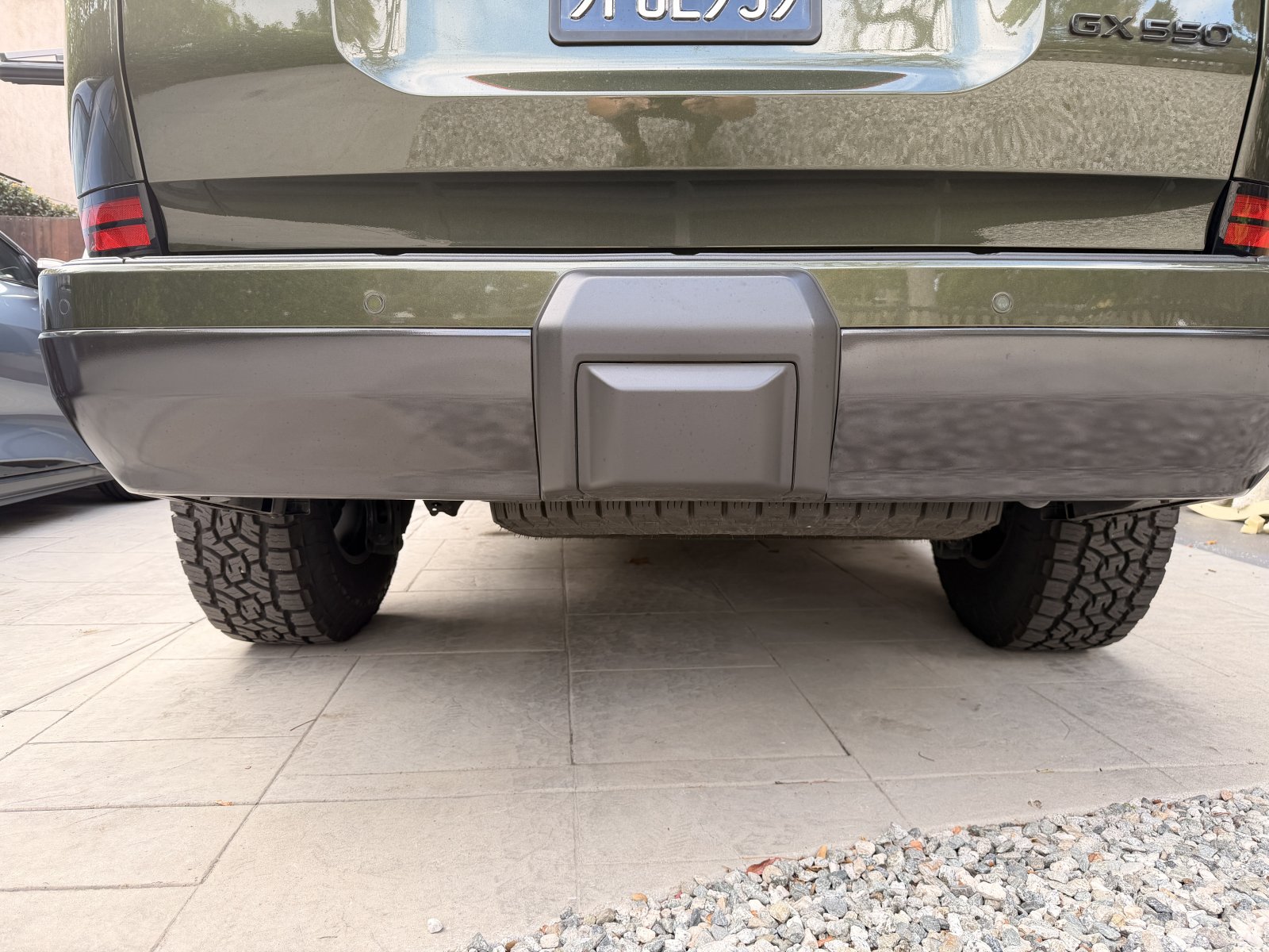

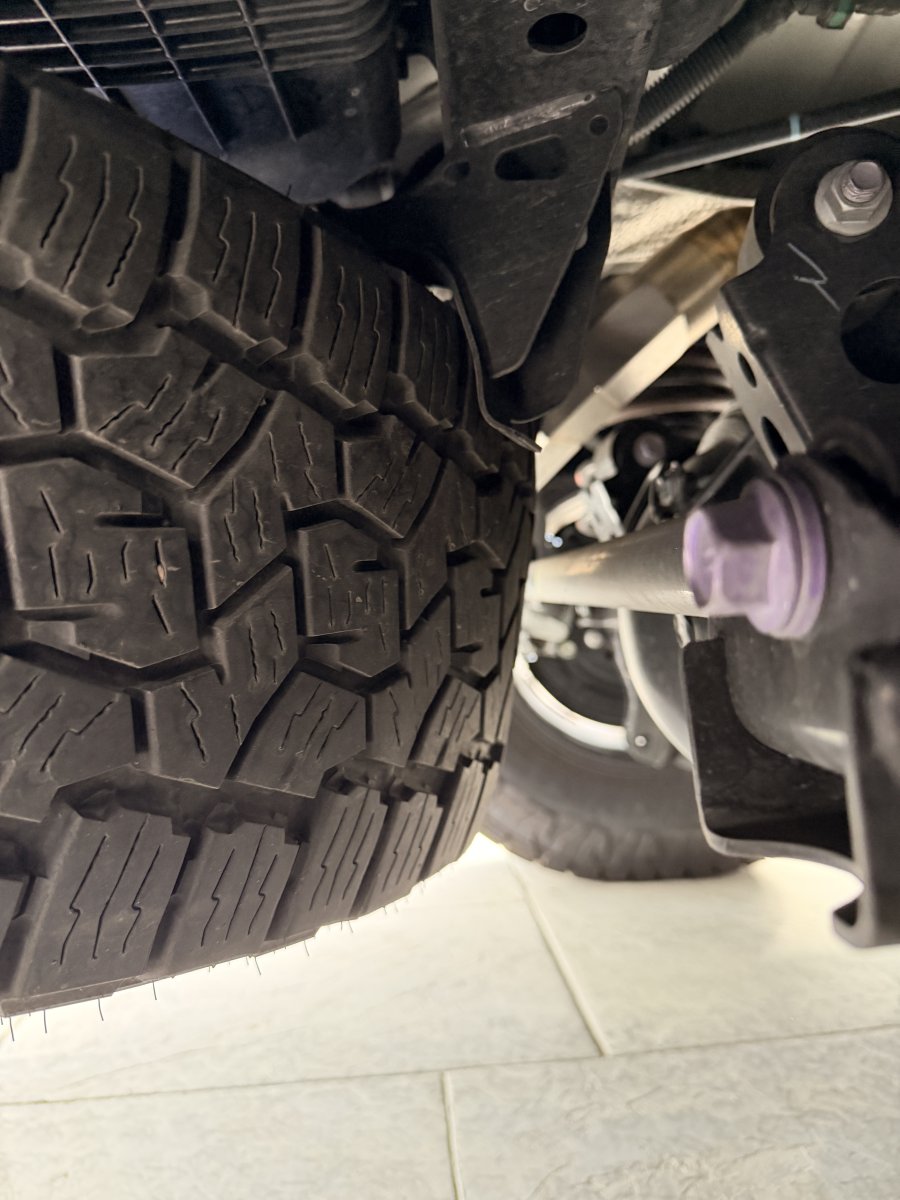

F it. I just went out outside and tried the 34’s.
Good news - it fits. Bad news - It hangs pretty low and any larger it would have to droop down on the axle side since there is zero room left at the bumper. My tire is a Toyo AT3 285/75/17 and my spare is also a Toyo AT3 but in a 275/60/20
Comparison of an unloaded 33” to a loaded 34”. Pretty close but it’s deceiving
33” spare Installed. Tad bit of clearance all around the spare and it’s peeking out from a bumper level view
Here’s the 34” in the spare. Touches something at multiple points.
So does it fit? Yes, but might lose some departure angle if that is important to you and if you can stand the look of the tire hanging out.
I wish there was a 34” that was slimmer but even the 34x11.5 Toyo is really only 33.5”
Hope that helps
