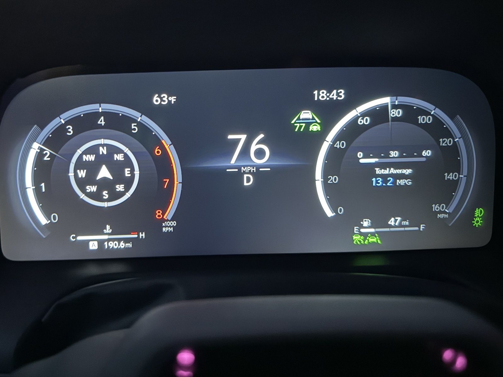

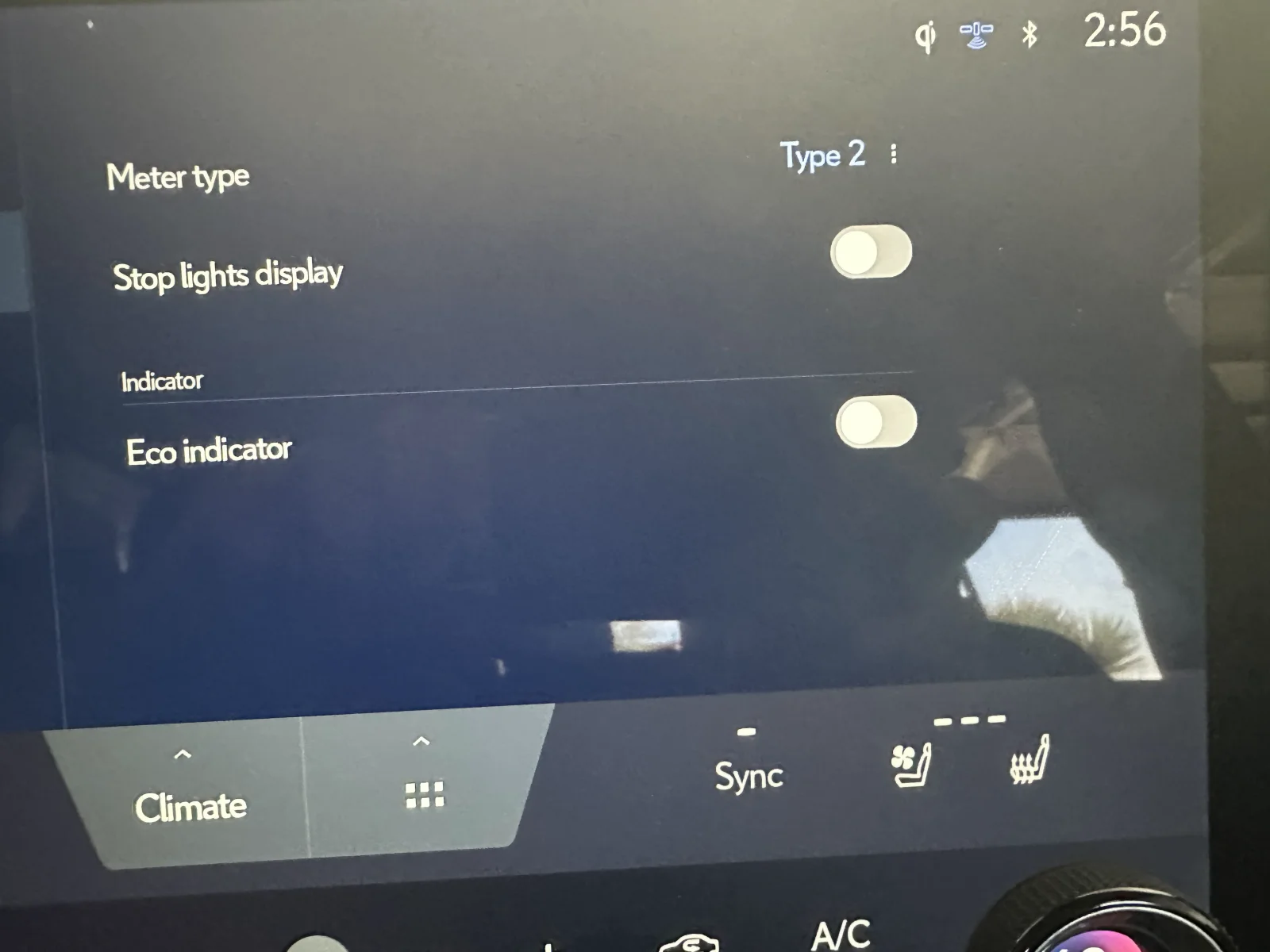

The pictures we posted show Meter. Its Type 2, which is pretty distinctive from 1 and 3 because the tach and speedo are right and left.
I tried it today using standard cruise.
The tach and speedo remained.

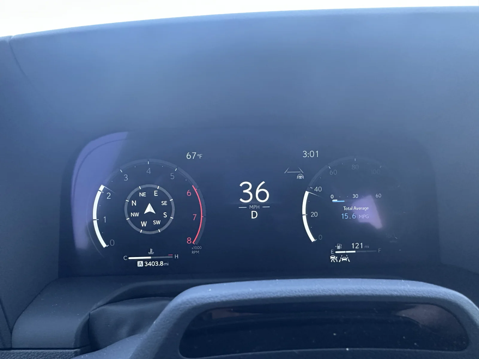

I tried this too. The tach and speedo remain using standard cruise. They disappear using dynamic cruise, for me, but not on everyone's else's rig.

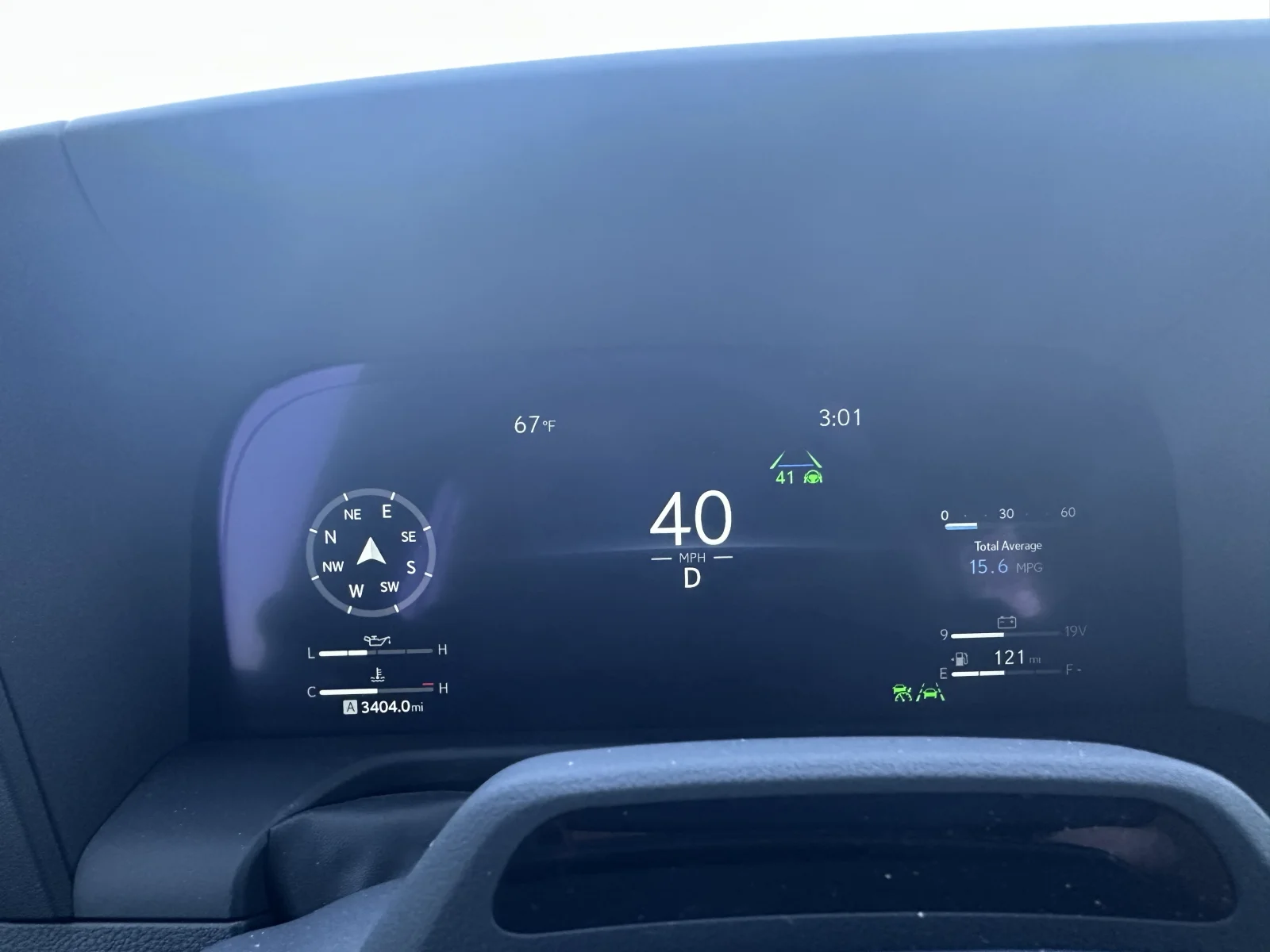

I tried several things today, but no luck yet. The meter type 2 tach and speedo drop off the display when dynamic cruise control is engaged.

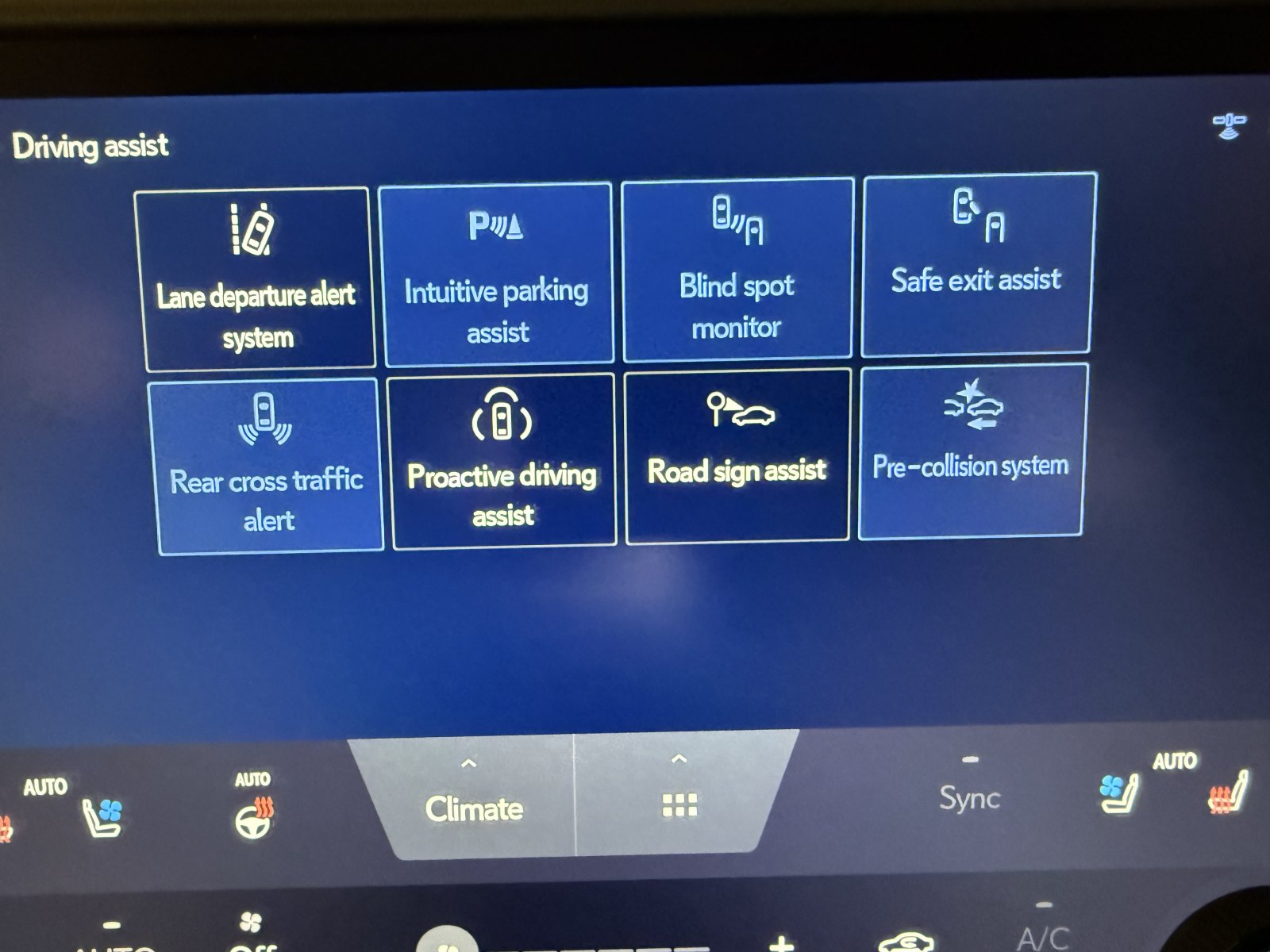

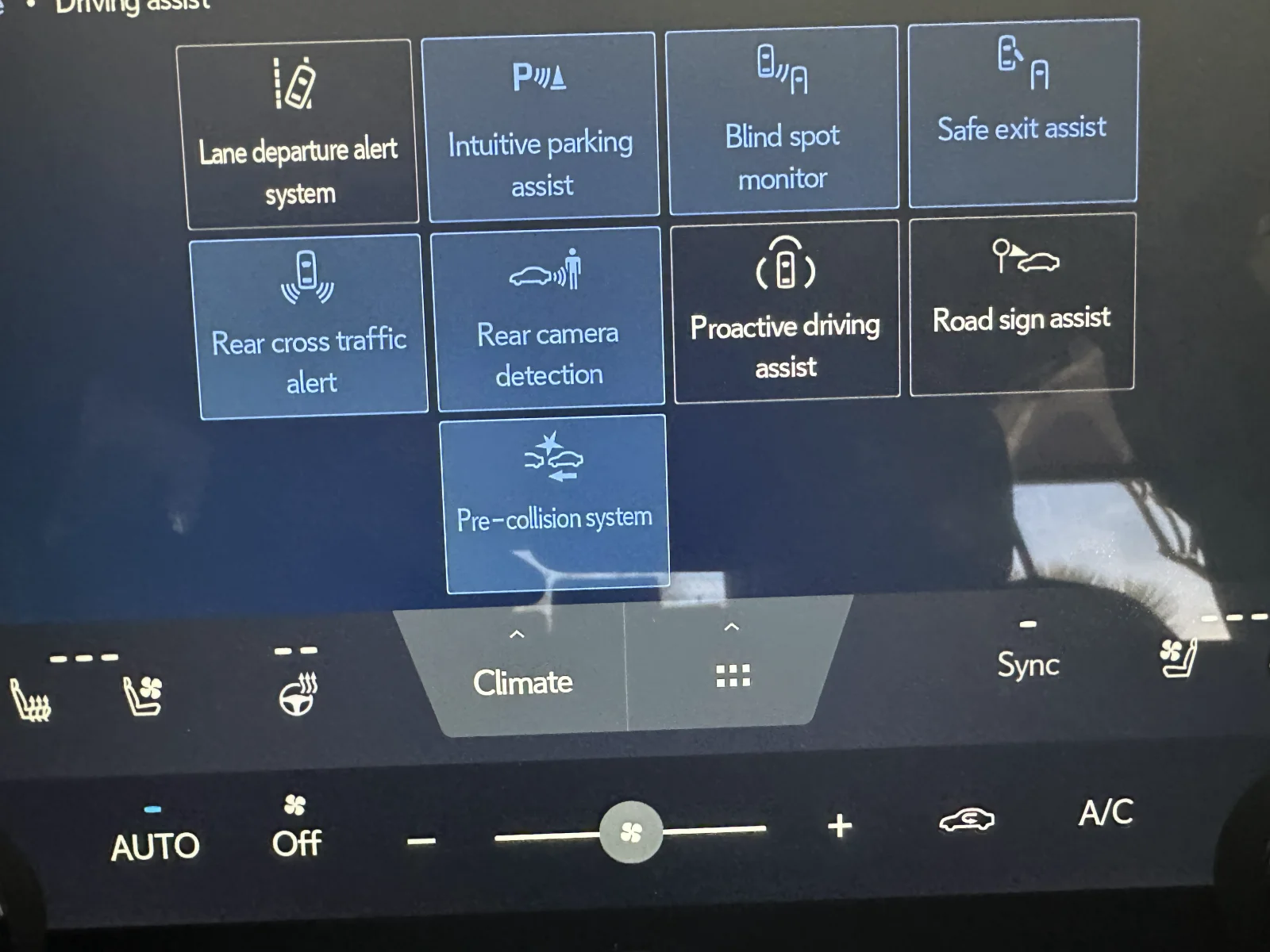

I set up the driving assists programs like yours. Mine has an extra Rear Camera Detection. I also tried turning them all off and then turning them back on one at a time to see if any one of them was the culprit. It doesn't seem to matter which are on or off, the meter drops the tach and speedo with dynamic cruise engaged.
I also did the meter display customization the same as yours again just to try to isolate the issue.
It's also interesting that when the tach and speedo drop off with dynamic cruise engaged, it add the oil and battery gauges.
This is so irritating.
If you didn't see from another post in this thread... I tried changing the mode to standard cruise and when you engage it in standard cruise, the tach and speedo remain. They only disappear with the engagement of the dynamic cruise.

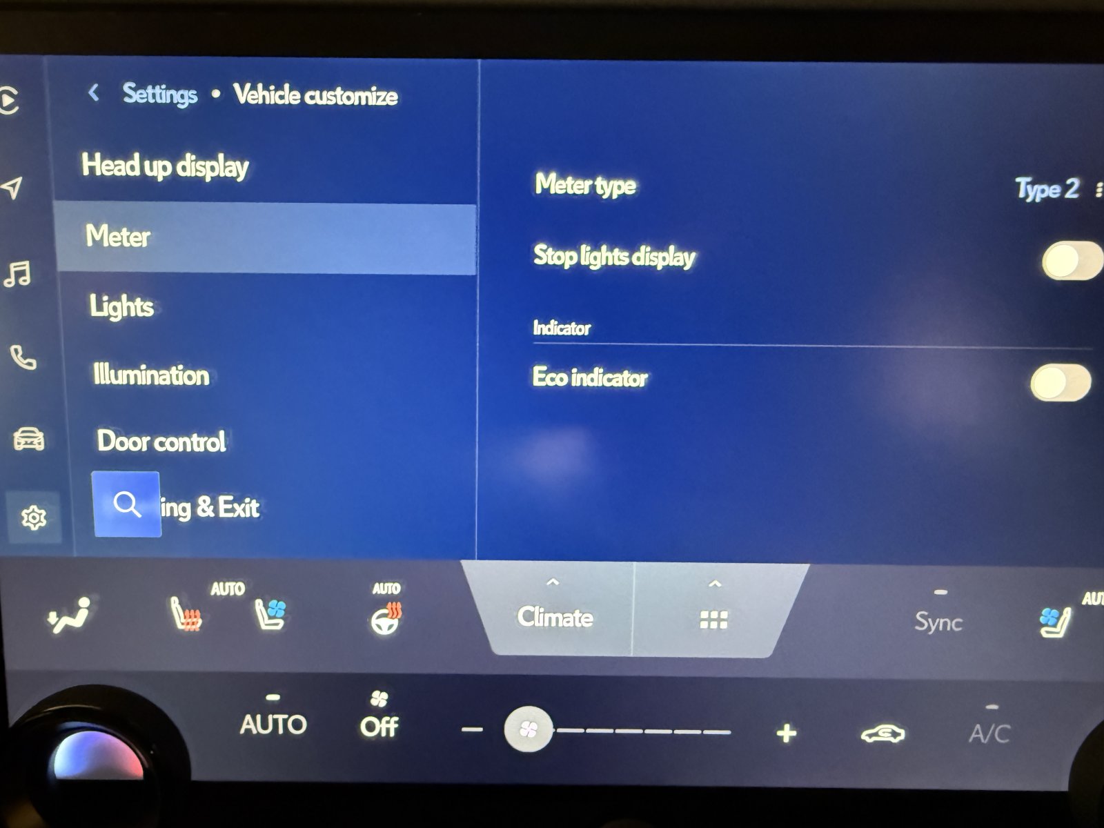

There are three screens (pages) that can be customized. Which screen (page) are you guys @Bluegill @Jabber customizing? I wouldn't expect that to make a difference, but who knows...
We have Meter 2 in settings selected (Display Settings/Vehicle Customization/Meter). It's the only one with the tach left and the speedo right. As for Meter Display Customization (press/hold the ok button on the steering wheel), I've tried, and failed to resolve the issue< using all 3 custom setting groups.

Here's an additional observation: after engaging dynamic cruise, if I hit the Lane Tracing Assist button (right side of steering wheel, its icon looks like a car between two dashed lines), then the tach and speedo re-appear! Hit that button again and they disappear.

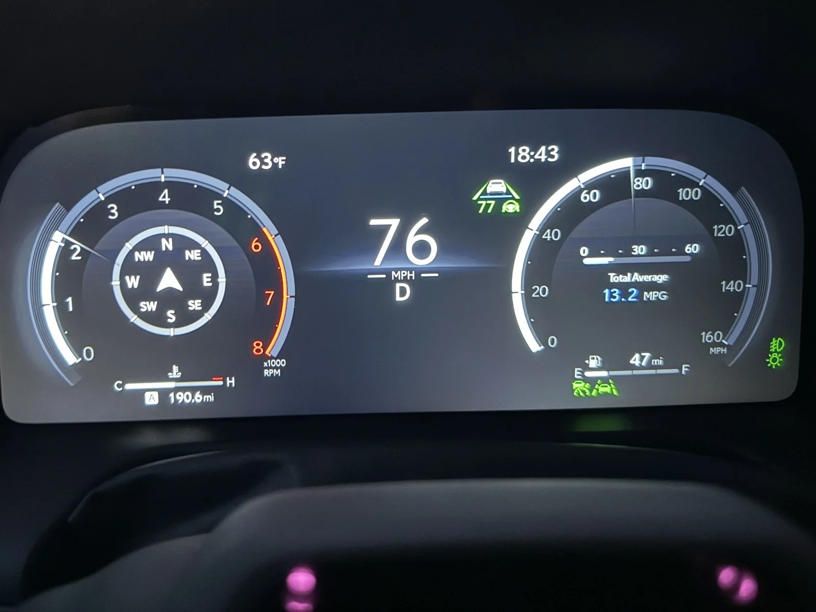

Thanks for that additional observation! Mine does the same thing. When DRCC and LTA are engaged, the Speedo and Tach disappear. Its stupid and clearly not intended to be that way. With both engaged, if you hit the LTA button on the right side of the steering wheel to turn that system off, the Speedo and Tach re-appear. Then hit that button again and they disappear again. The issue of the disappearing Speedo and Tach occurs when BOTH DRCC and LTA are engaged. Turn either off and they reappear.
HOWEVER, on March 4 2025 in this thread, you will see Bluegill posted a picture of his Meter Display with both DRCC and LTA engaged and his 2024 OT+ DOES NOT have the same issue. His picture shows both systems engaged and the speedo and tach remain.
