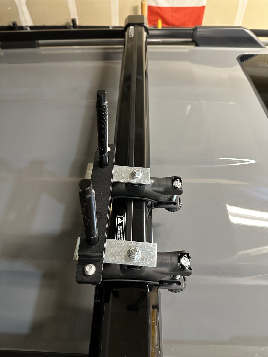

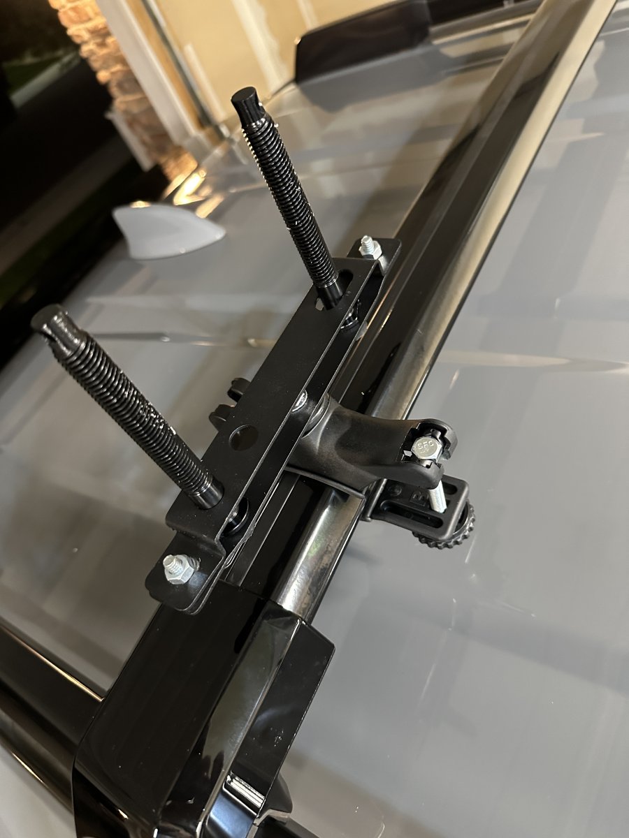

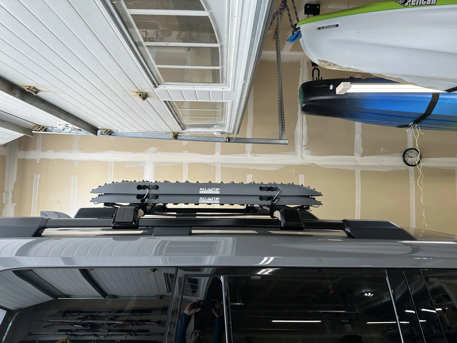

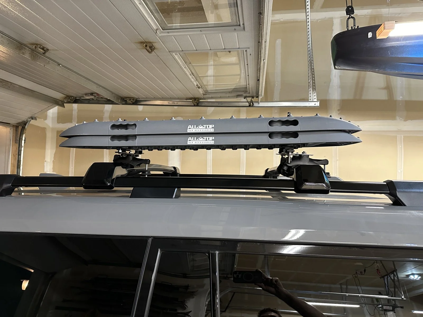

I succeeded, but don’t think I like it.
this ALL-TOP Recovery Traction Boards,... Amazon.com
Plus this
Plus a home depot run

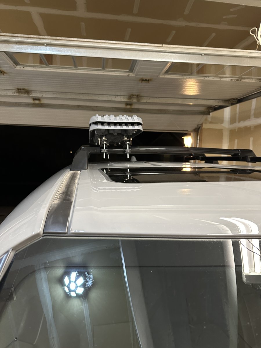

As you can see, it sits high, now about 84.5”, close to the 86” limit on the local carwash. Maybe its too risky to use anyway - might get snagged??
The crossbars are 26” spacing and are not adjustable, so I had to fab an offset to use with the 24” mounting holes.
Also, the stupid rubber strip on the bottom of the cross bars inhibit a good clamping. Between that and the noise, I’m starting to think they are just for show.
Should I ditch them and get a proper roof rack? I’d like to add Kuat Grip 6 ski mounts in a few months…
Plus this

IMO yes much to high

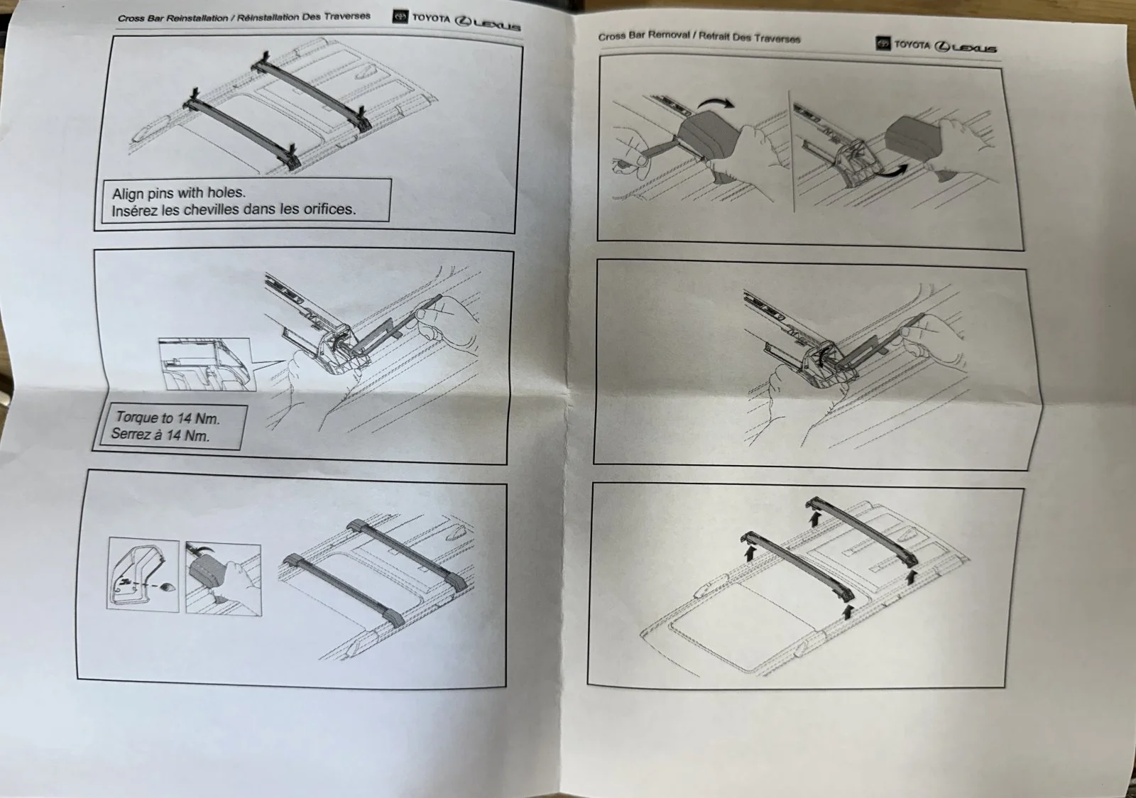

Nice adapting. I had assumed the OEM crossbars could be slid back and forth for spread adjustment. What is it about the way they are attached that prevents that?
I read they weren’t adjustable, but I tried anyway. Here is the page from the manual. I loosened the bars anyway and could feel the pin keeping the bars in place. IMG_1859.webp
Next I'm wondering if the pins could be ground off. That is, if the clamping mechanism is firm enough. The universal clamps from Rhino Rack for their cross bars just use screw compression clamping to hang on.
That would help to remove the offset bracket, but the real challenge is the height IMO.
I can probably reduce 3-6" with a proper roof rack, but some of them require removal of the rails. The factory doesn't but suffers from wind/cost.

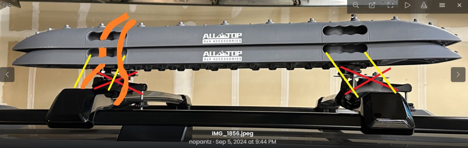

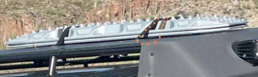

I'd just lash them directly on top of the cross bars. Maybe cut up an old bike innertube and lay the rubber between the crossbars and the traction boards so they don't scrape the crossbars or slide around, and dampen vibrations a bit (if any of this matters). I put at least one run of the strap through the grab handles so that the board really can't escape. See my crude 3rd-grade drawing below. The red Xs are get rid of the high mounts (return for refund). The yellow lines are line up the grab handles with the cross bars as best you can (they actually line up pretty well). The orange is my attempt at drawing a lashing strap. It's low tech, low on the rack, sleek, cheap, not very impressive to the Transformers Overlanding Zombie Killers, but it works. You'll likely never touch the traction boards and they can stay up there safe & sound during your off-road trips...but they are there just in case.
Here's what I mean about routing the strap through the grab handles - see the little orange dots tracing out the path of the strap.
That mounting plate would work, but man the accessories are expensive - they are the major profit center for all these off road items.

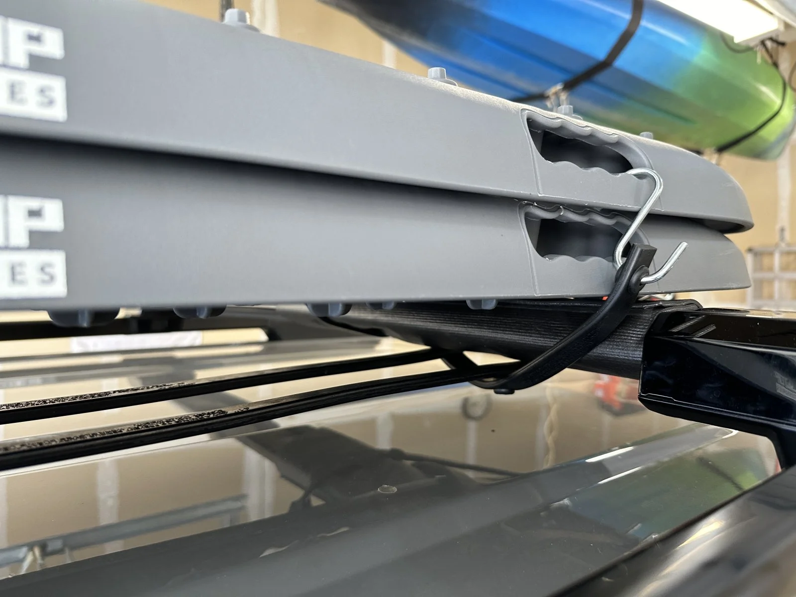

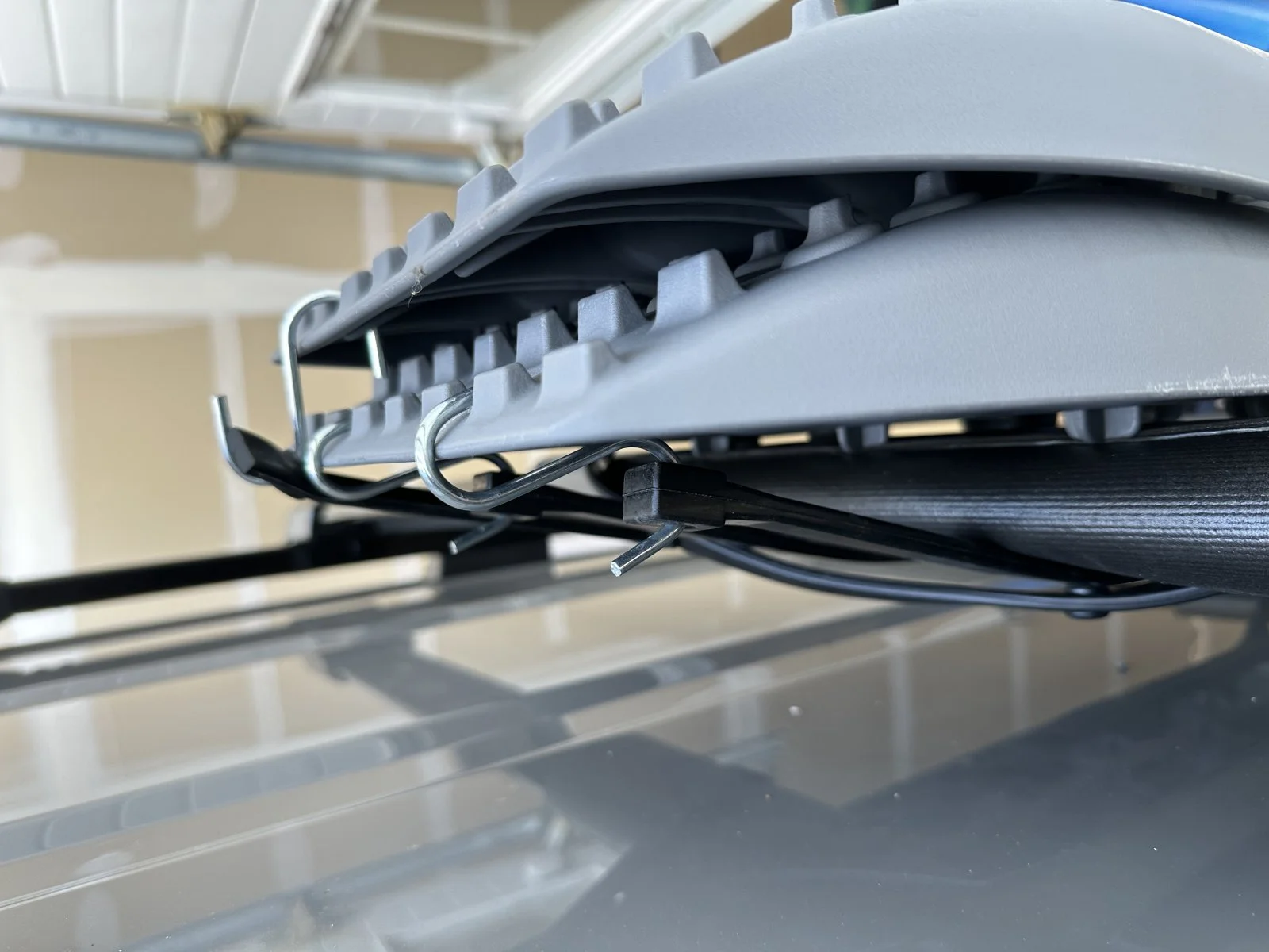

After a trip to HF for some shelf liner and 36”+41” EPDM straps, here is v2! I used double sided tape as I looped the shelf liner around the rails. Very solid and went through the car wash fine.IMG_1883.webpIMG_1884.webpIMG_1885.webp
