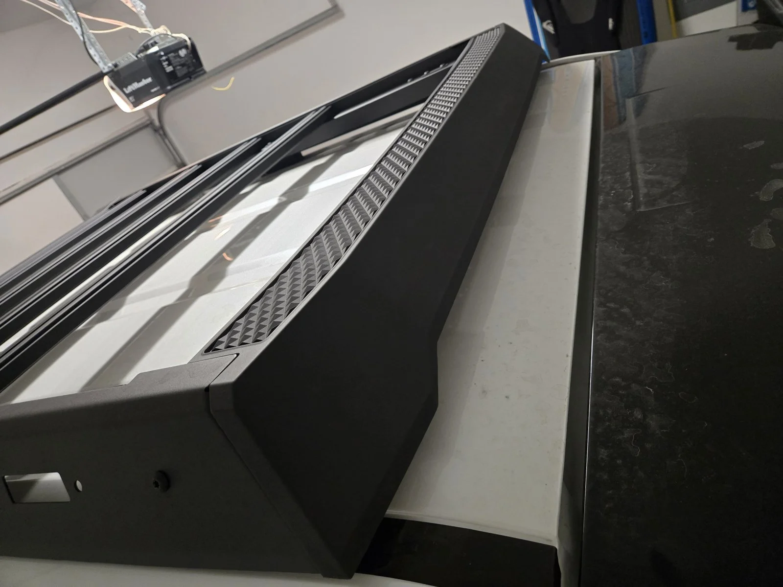

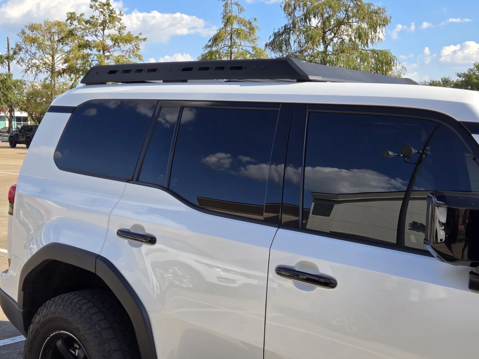

I recall seeing a photo in a post on facebook showing that the front wind deflector hits the giant glass sunroof, if your truck is equipped with that sunroof.
Here

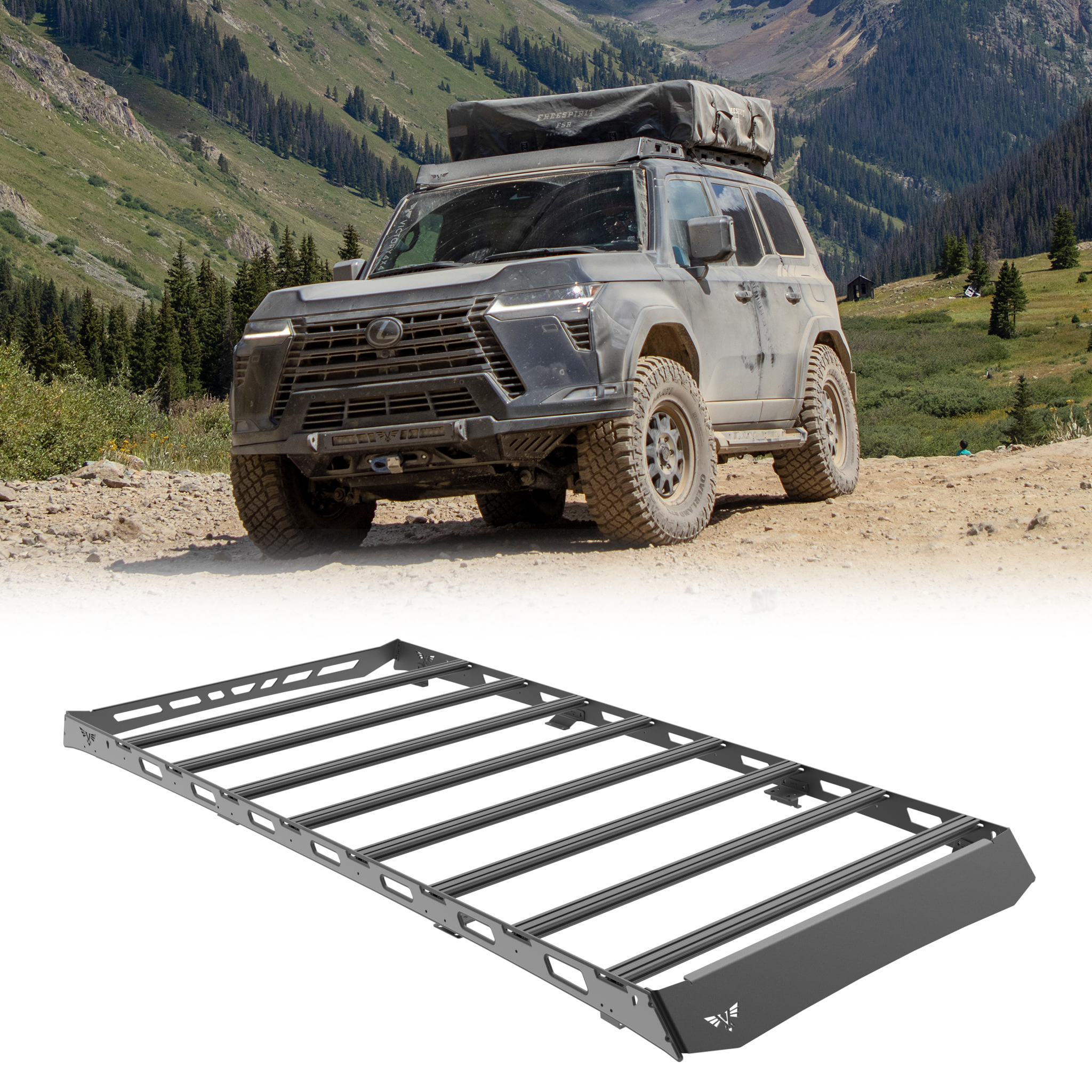

hardly anyone says the LC one is bad compared to the GX roof rack. Yes, it will fit. on the GX except for the slight issue if you have a LUX + with the large panoramic roof. Victory4x4 has a short rack as well that costs much less than the LC rack.

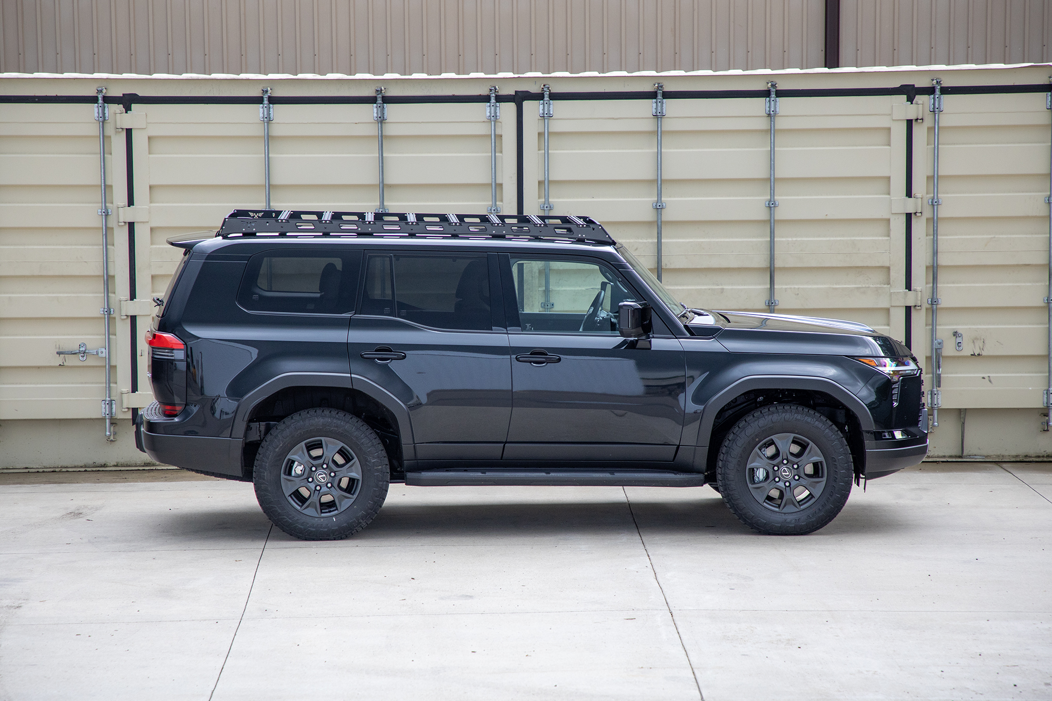

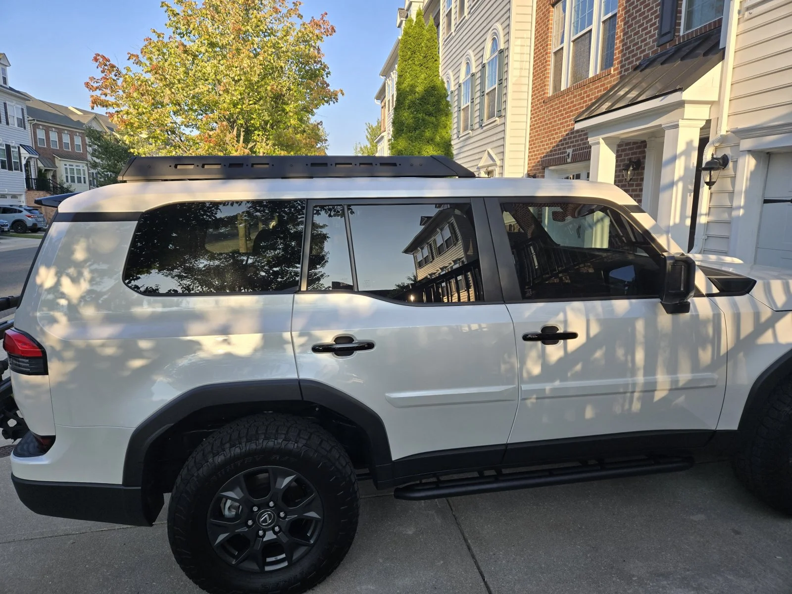

Yes, I have one on mine. It looks badass on the GX. This roof rack should've come with the OT+. Hardly noticeable extra wind noise above 75ish-80mph. Super quiet below 70 mph. Definitely recommend. Only downside is that there is currently a 4-6 month backorder for them.

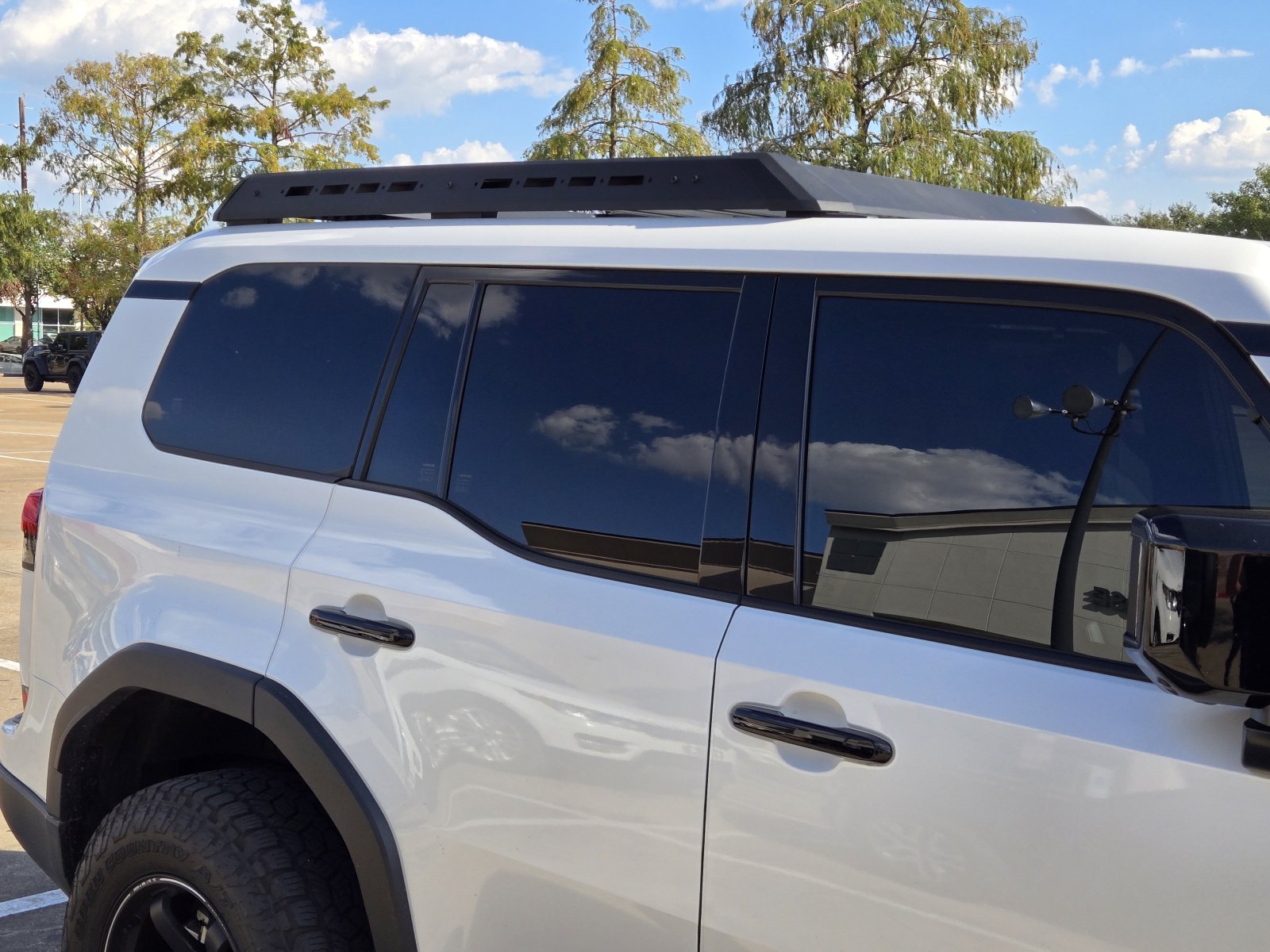

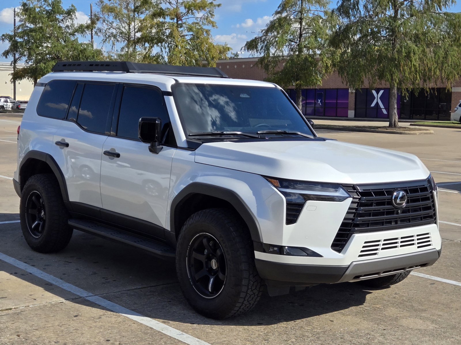

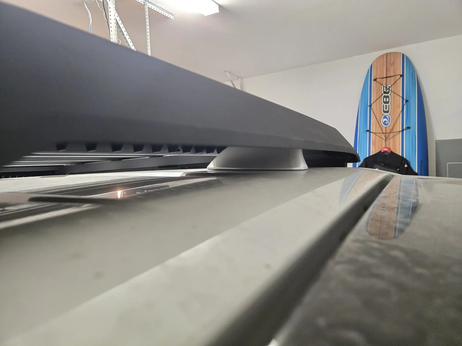

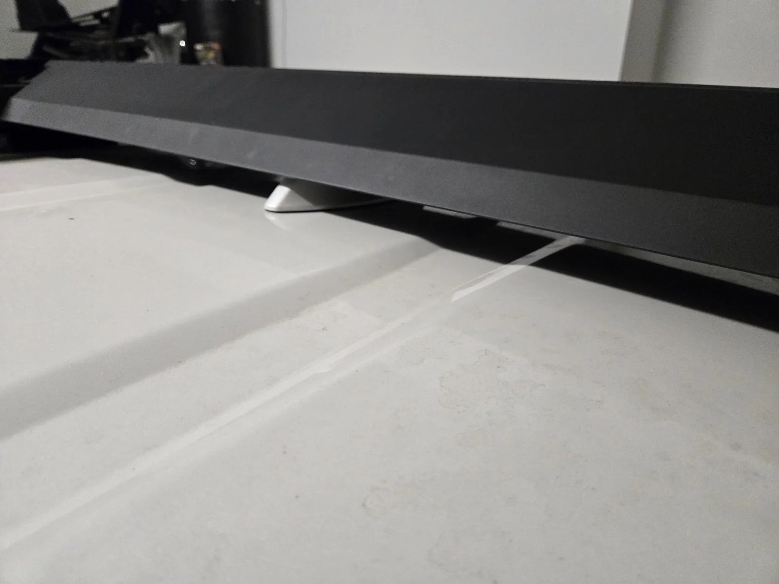

How does this fit with the sharkfin antenna? Does the rack cover the antenna? If so, does it interfere with the operation of that antenna?
Yes, there is a plastic shield that covers and protects the antenna. Doesn't interfere with reception.

What wheel and tire specs are you running? Looks awesome!

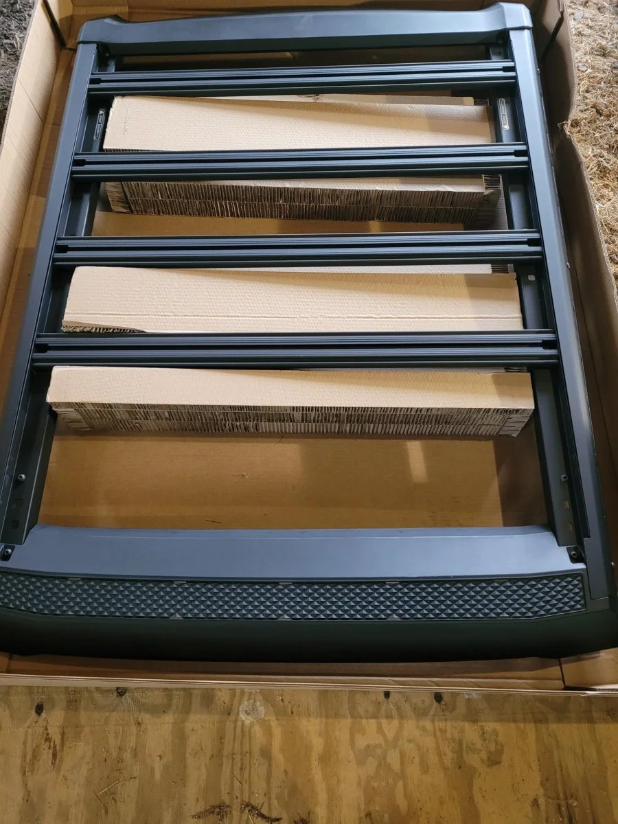

Do you know, is this the correct part # for the LC roof rack? And is it a direct fit on the 2025 GX Premium Plus? Thanks for your help!
Roof Rack - Toyota (PT970-60241)​

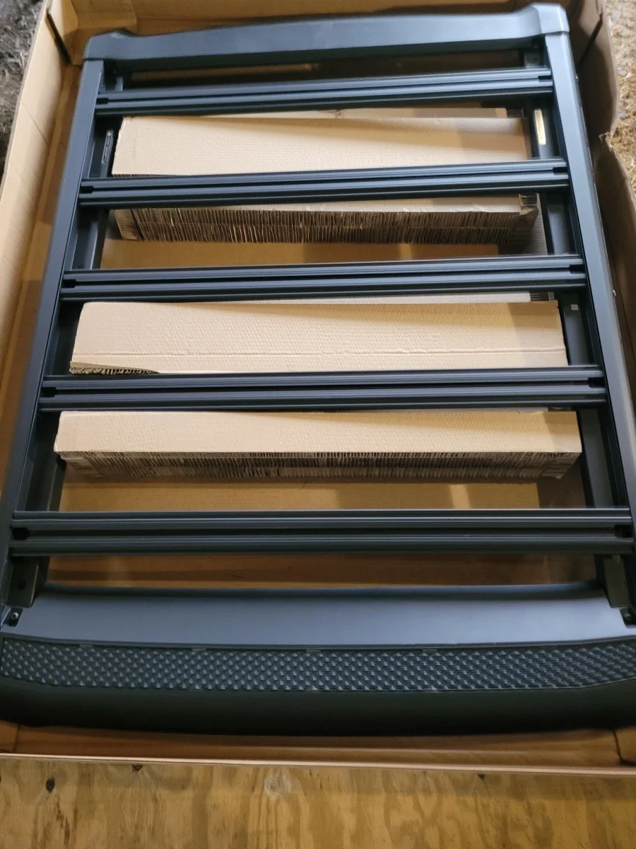

yes, that is the correct part number. I have that and also an extra cross bar. For some crazy reason this rack omits a cross bar that is at the rear of the rack. There is an obvious space for it and also the T30 screws already in the frame for it. The cross bar part # is same but has the letters CB after it: PT970-60241-CB. I could not buy the cross bar online since it is on back order, so I went to my local Toyota dealer and they purchased, only took 2 days to get. I'll post a couple pictures of the rack with and without this cross bar. (BTW, I'm expecting allocation delivery of my '25 OT in about a month, so can't show pic of it installed yet).
