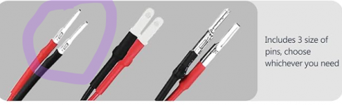

I ordered this wire kit on Amazon (no affiliation), Amazon.com.
Of the three wire options that come with this kit, I used the needle shaped wires circled below. You may just want to located and order the needle shaped wire harness.
As mentioned above, I inserted the black wire in the lower left most slot with the black wire from the GX wiring harness. I inserted the red wire immediately to the right of the black wire (second lower left slot) with the white wire.
Works like a charm and only when the ignition is on.
