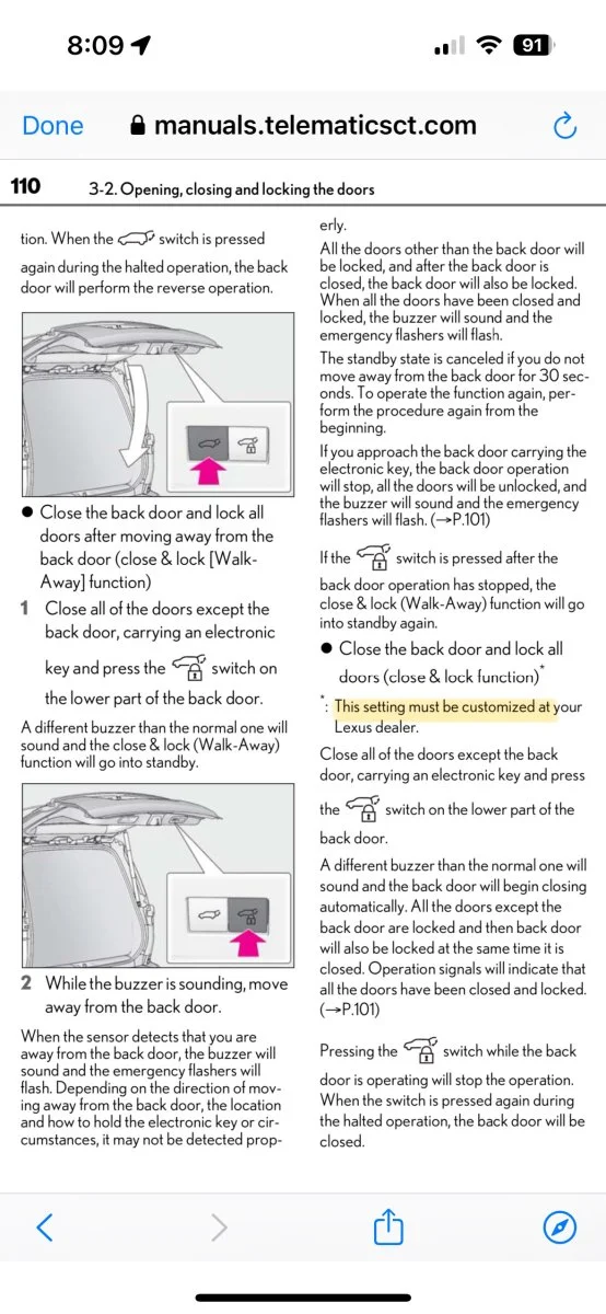

Per the manual, the default standard state is close and “walk away” and you have to step away from the vehicle for it to start closing. I haven’t tried this myself, but decided to go through the manual after reading your post
Will need to go to dealer to switch to the direct close and lock it seems

Have you tried stepping away after pressing the "Close + Lock" button yet? I tried it on mine and it will close after the key is no longer detected in range
