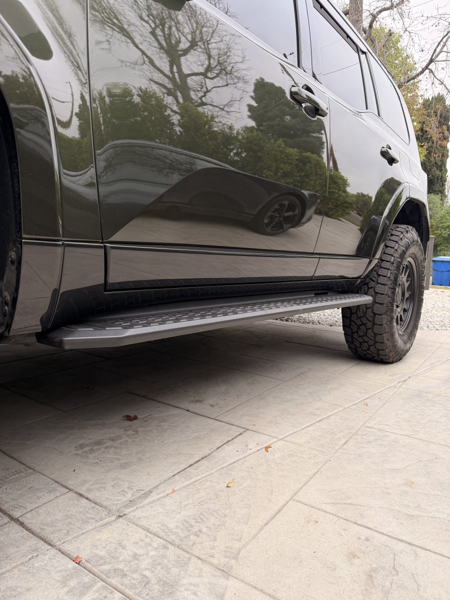

Removing and Installing both sides is a 20 min job max as a solo job.

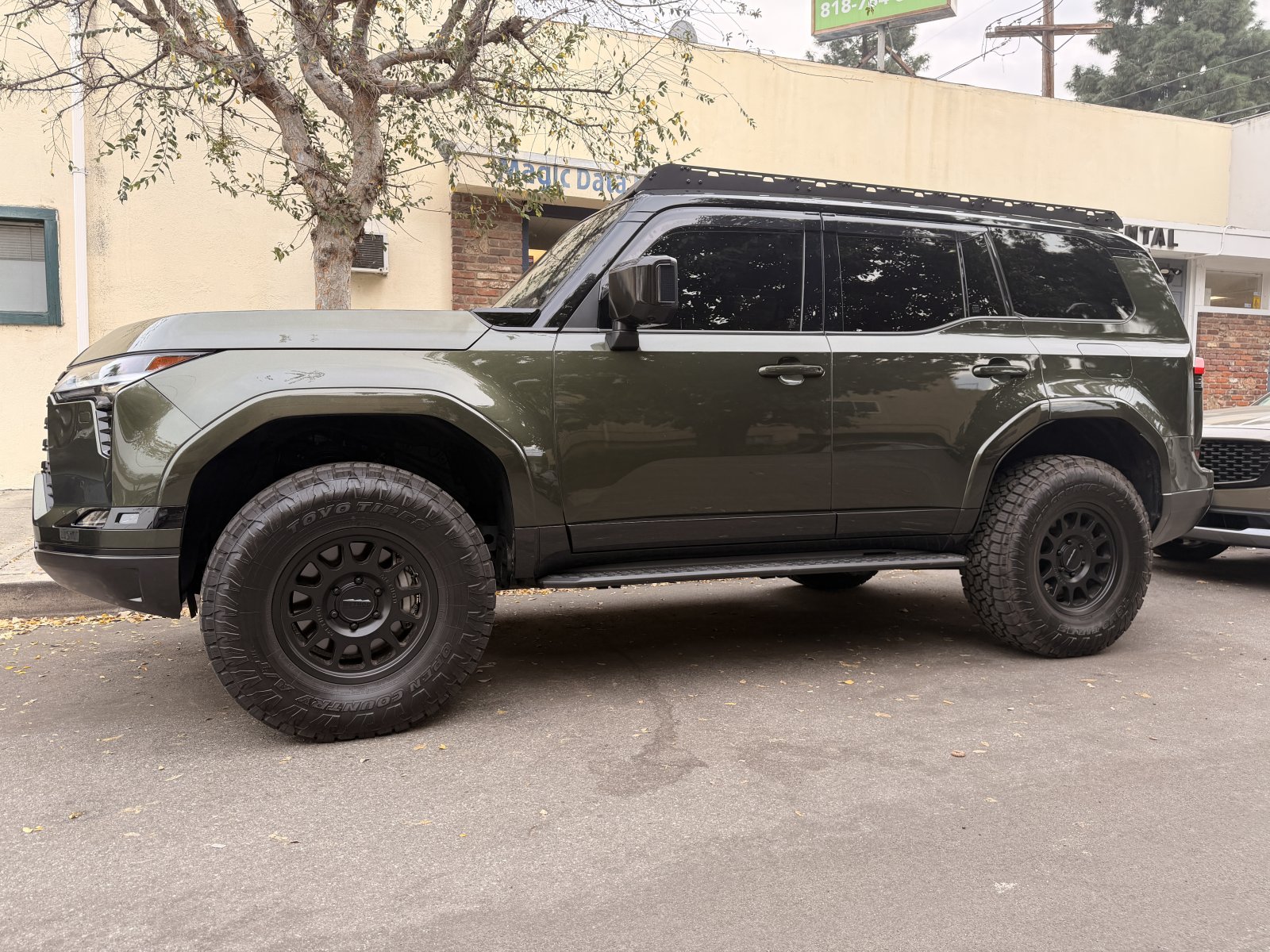

Your truck looks great! Nori Green+Black is a mean look.

Love the look. Do they feel sturdy? I feel like the GX running boards are very flimsy. Especially in cold weather, they crackle and flex... Are those the base standard LC boards? I will look into this myself.
Also, wonder how they align with the OEM mudguards in the front...
they are definitely lighter, but just as sturdy. I didn't have feel much flex in either step. Yes, these are the standard LC illuminated steps (I think they have unlit ones too - 1958 model?) and they bolt/plug in as a straight swap.
The front mudguards don't line up at all (the LC steps are a couple inches shorter at the front) and you'd have to buy the LC front mudguards which are cheaper than the Lexus tiny flap indented ones
