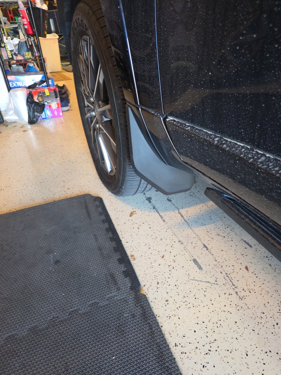

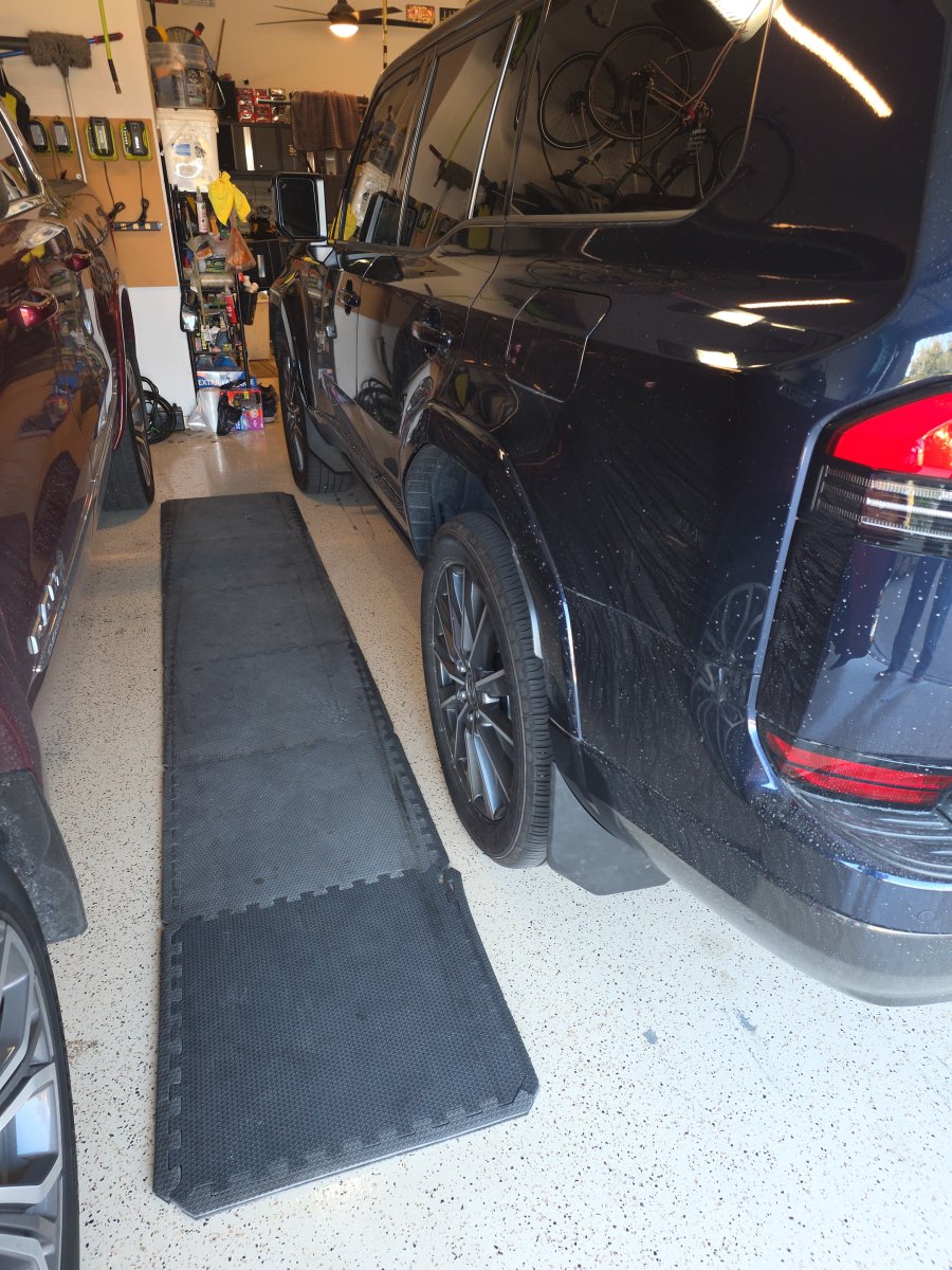

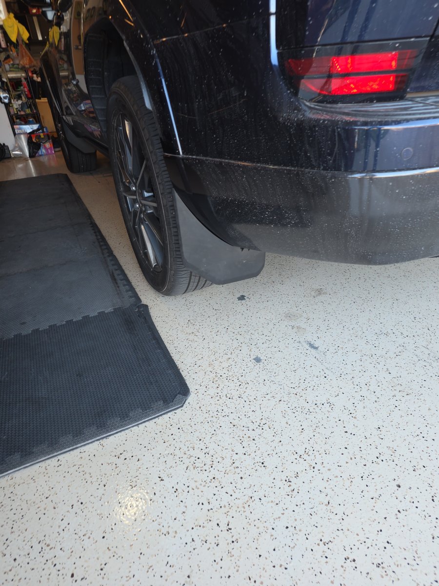

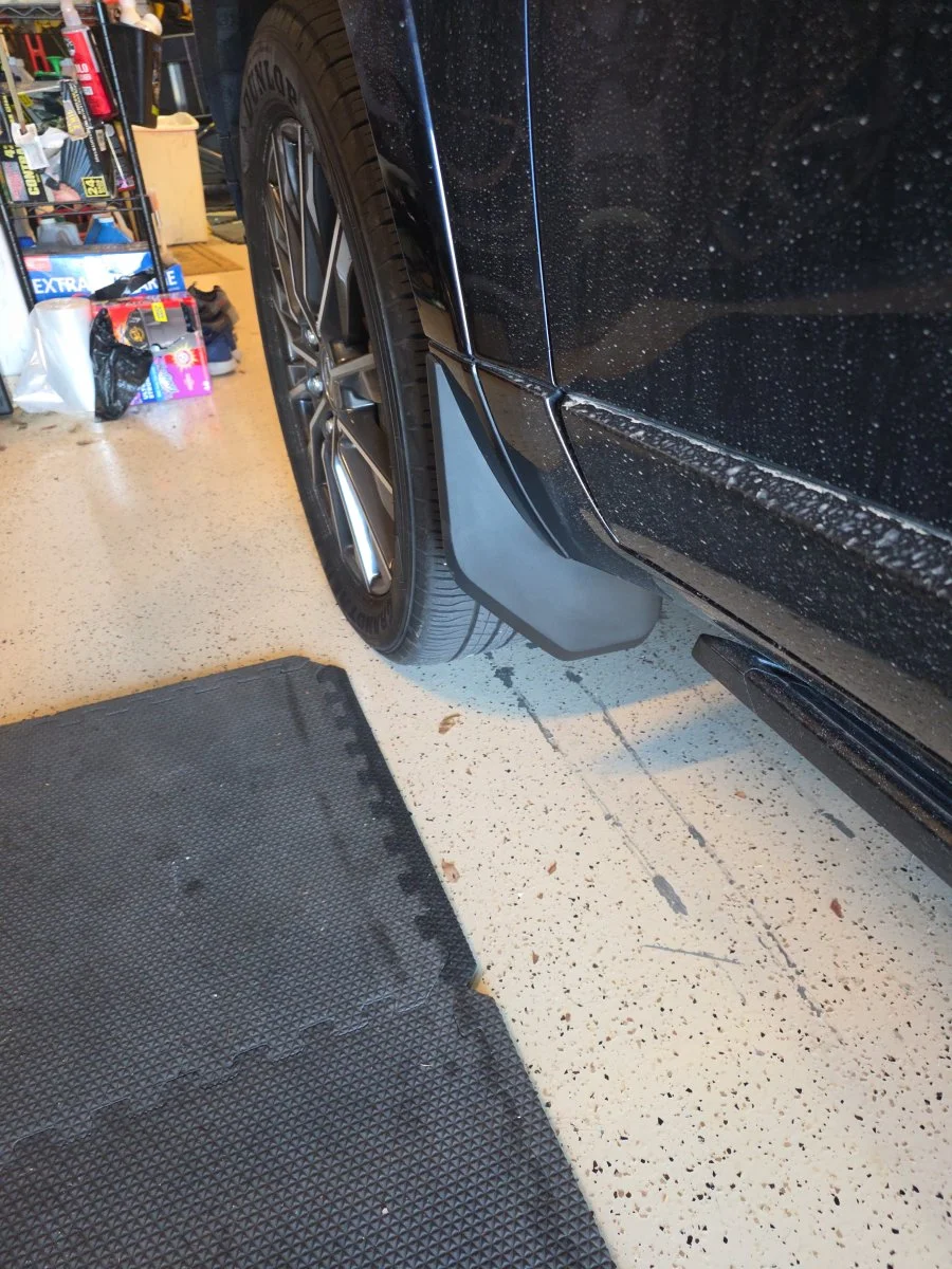

Here are the installed pictures of the GX550 rear and Toyota LC fronts. Fits perfect on the Luxury plus. You will have to do some drilling on the rears and one spot on the front to install. The rest is removing the existing screws and plastic push pins and reinstalling them. Took about 30 minutes from start to finish. Excuse the dirty car.
Toyota parts for the front..

Thanks, looks nice. Did you need an angled drill or did you need to remove the wheels to drill?
I used an angle adapter to get to the screws and drill the front holes. The ones in the back are too tight to get the adapter in there so I just used my hand to twit the drill bit and that worked just fine. The plastic is pretty soft.
Thanks. I used an angle adapter to get to the screws and drill the front holes. The ones in the back are too tight to get the adapter in there so I just used my hand to twist the drill bit and that worked just fine. The plastic is pretty soft.
