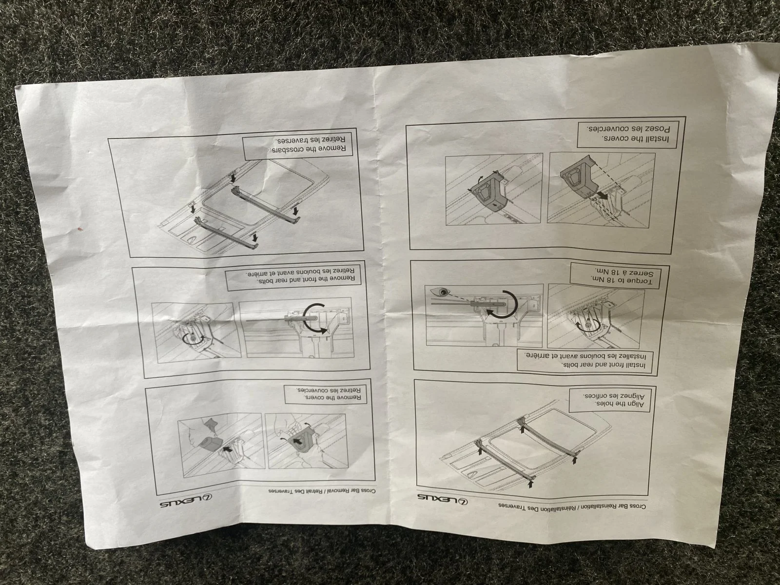

When I got my lux + the dealer provided a kit with the tool, instructions and the plastic covers. It’s pretty easy took me 10 minutes to remove my rails.

Unfortunately I am in southern cabin vacation, won’t be back at my domicile until next week, I can get you pictures of the tool and instructions. I know the tool is a torx bit.
If I remember correctly each end of the roof rack has a removable plastic cover, remove the cover and the screws, roof rack comes out. The covers that you found fit the openings where the roof rack was at.

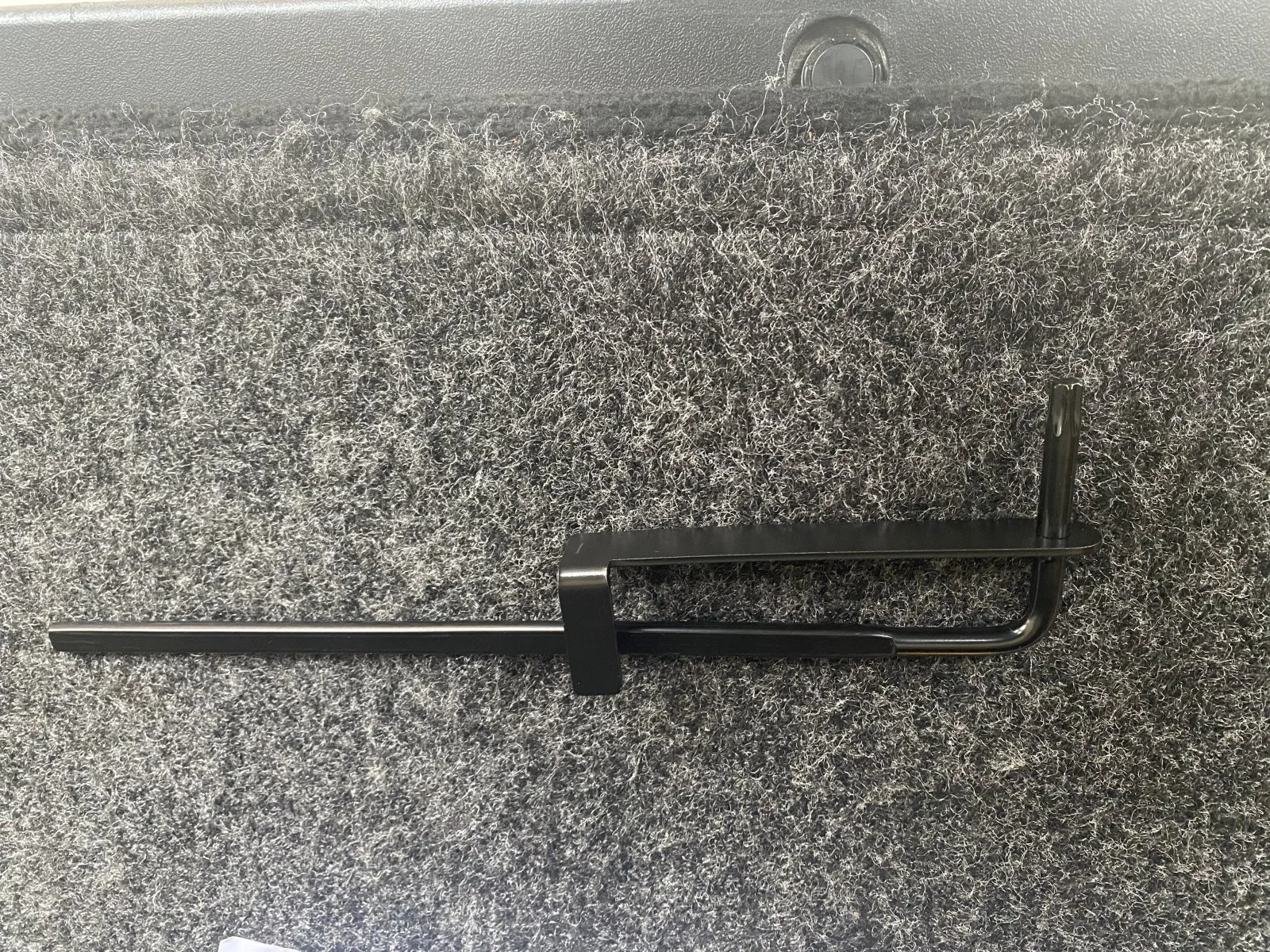

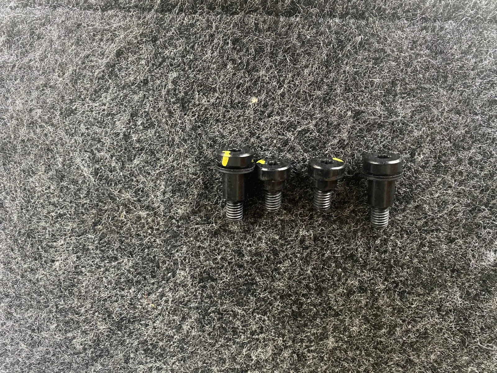

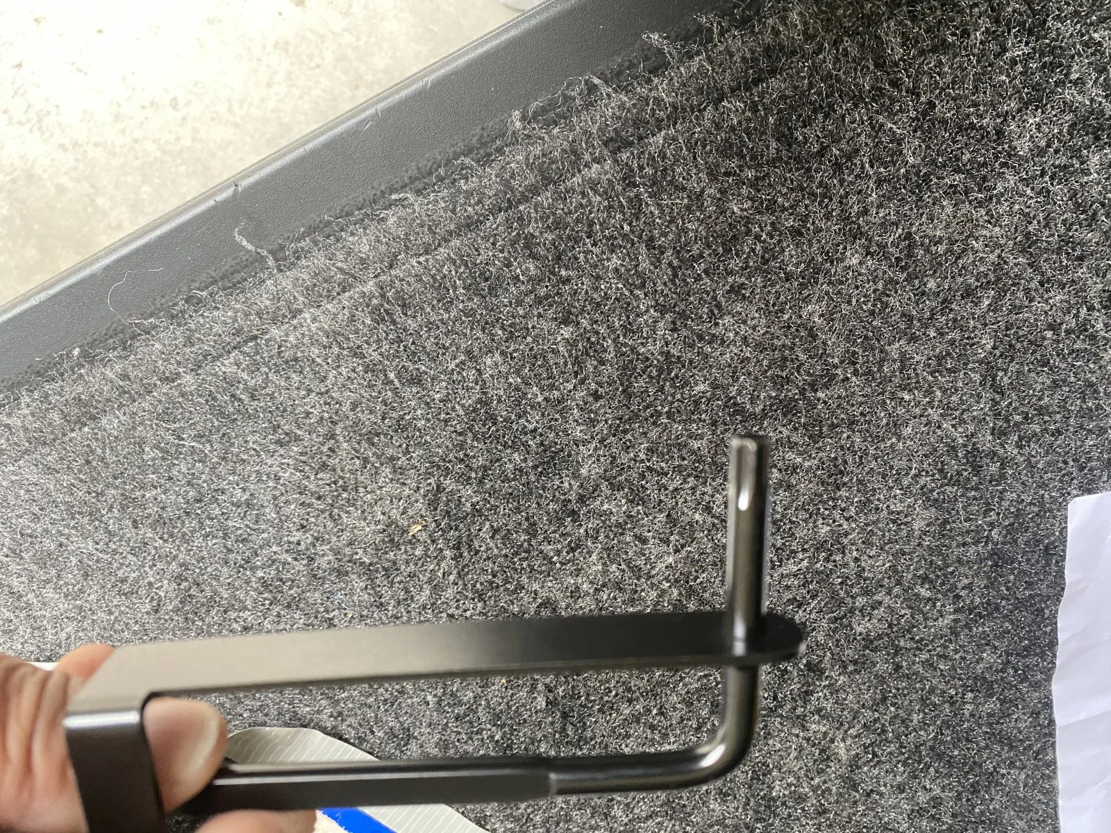

Pictures of removal kit attached with instructions and picture of the removal tool. Also picture of the four screws removed from roof rack.

No tool with mine either. The bolt is a Torx T-40. I just got a small T-40 bit. For a 1/4” drive set and used a 1/4” wrench to remove the bolt.
Interestingly, the wrench that came with the roof rail kit was too tall to fit in the roof rack tower.
