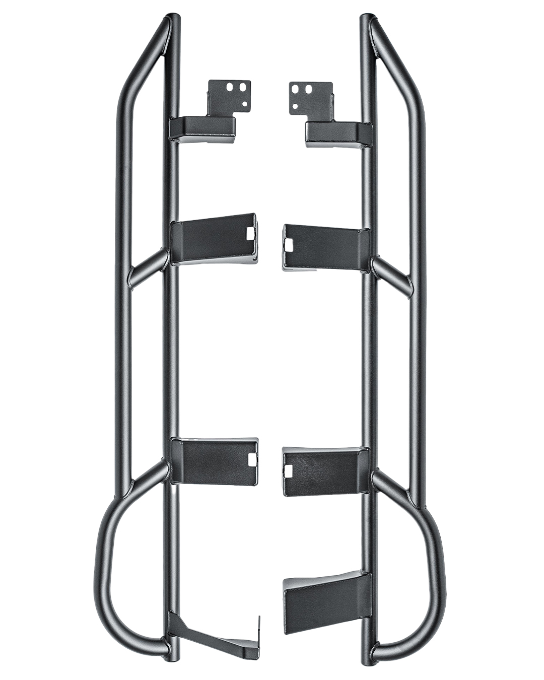

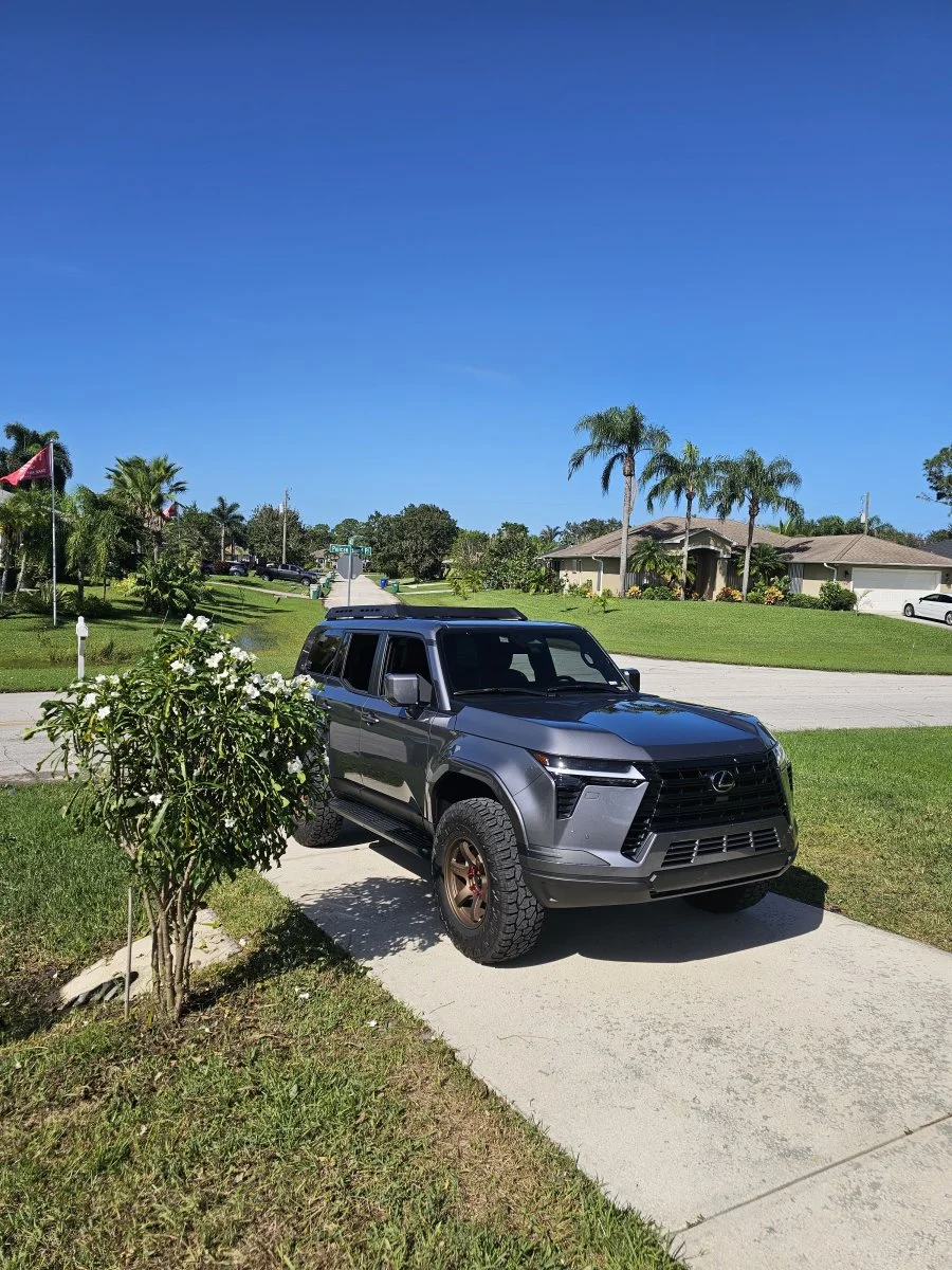

Hello everyone, I'm located in Orlando Florida and I've met up with another Forum member from the Land Cruiser forum, we met up yesterday and swapped out my roof rails and crossbars for his first edition Land Cruiser roof rack. Everything went smoothly with the roof rocks. Next we were swapping my OEM running boards for his Land Cruiser first edition Rock Rails. My running boards fit perfectly on his Land Cruiser but his OEM Rock Rails did not fit on my Lexus GX 550 premium😵 the corresponding holes on the frame of my truck are there but they are not threaded so the 14 mm bolts used to attach the rock rails to the frame simply pop in the hole. The holes seem to be oversized versus what's needed to attach the rock rails to the frame of my Lexus. Has anyone else encountered this issue or is my truck a one-off defect from the factory? I've gone on Toyota's website as well as Lexus website and the part numbers for the driver and passenger side rock rails are identical. Am I missing something? Or does my Lexus require special Hardware?

Westcott has told me that their sliders fit "all trim levels" but I just don't see how based on their install video. I sent CBI some pictures to see if theirs will fit, but I really think non-OT owners are SOL. There are some threaded holes on the frame, but not enough it seems.
I wish some of these sites would post their actual installation guide so I'm not having to estimate holes/attachment points.

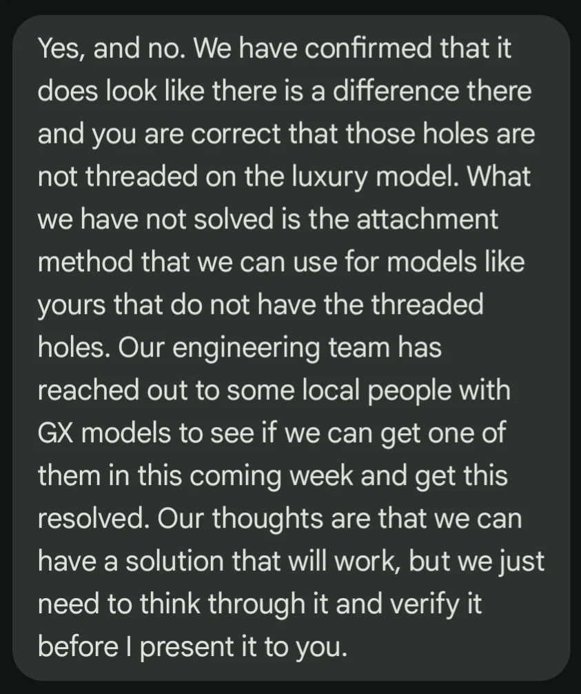

From CBI... there's hope! I've been corresponding for a while with the fools hope that they may have a solution and it sounds like they're at least trying! I'll be interested to see what they come up with. Fully accepting that bolt on sliders aren't REAL sliders but also realistic that I'm not looking to ride these suckers over REAL boulders either.

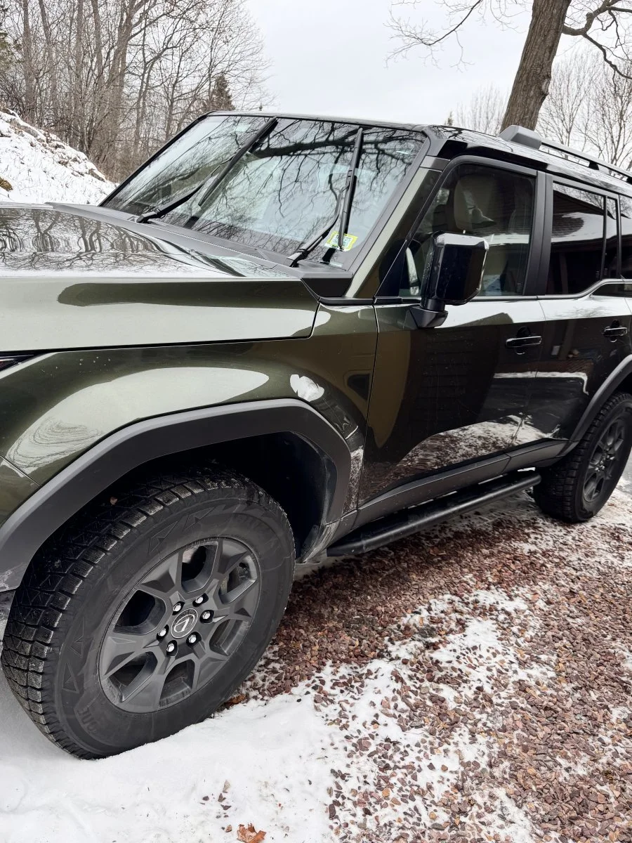

Had local Toyota dealer do the swap today. I can officially confirm the FE rock sliders and the Overtrail running boards are easily swapped. That has made both my wife (her’s is the FE and her girlfriends complained about the “climb”) and me happy (I had dealer delete rock sliders thinking I’d get them later from an independent fabricator but hadn’t found the right set yet).

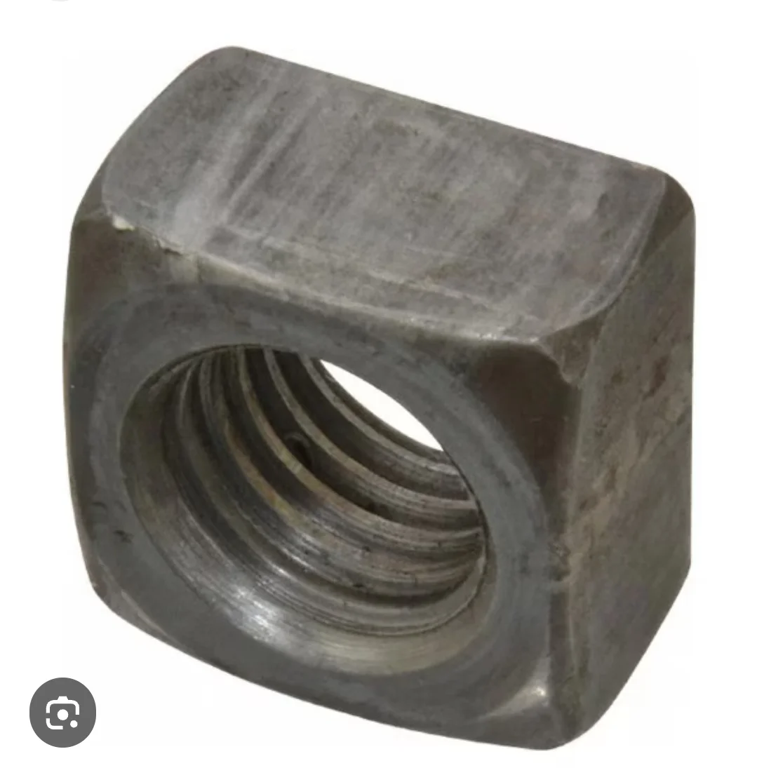

Local shop is offering to put "nut-serts" in those non-threaded holes to allow for rock slider attachment. I know that won't provide near the same protection as true sliders, but it's better than busting up the auto-steps. I'm gonna talk to them tomorrow morning and see if that's a direction I want to go.
