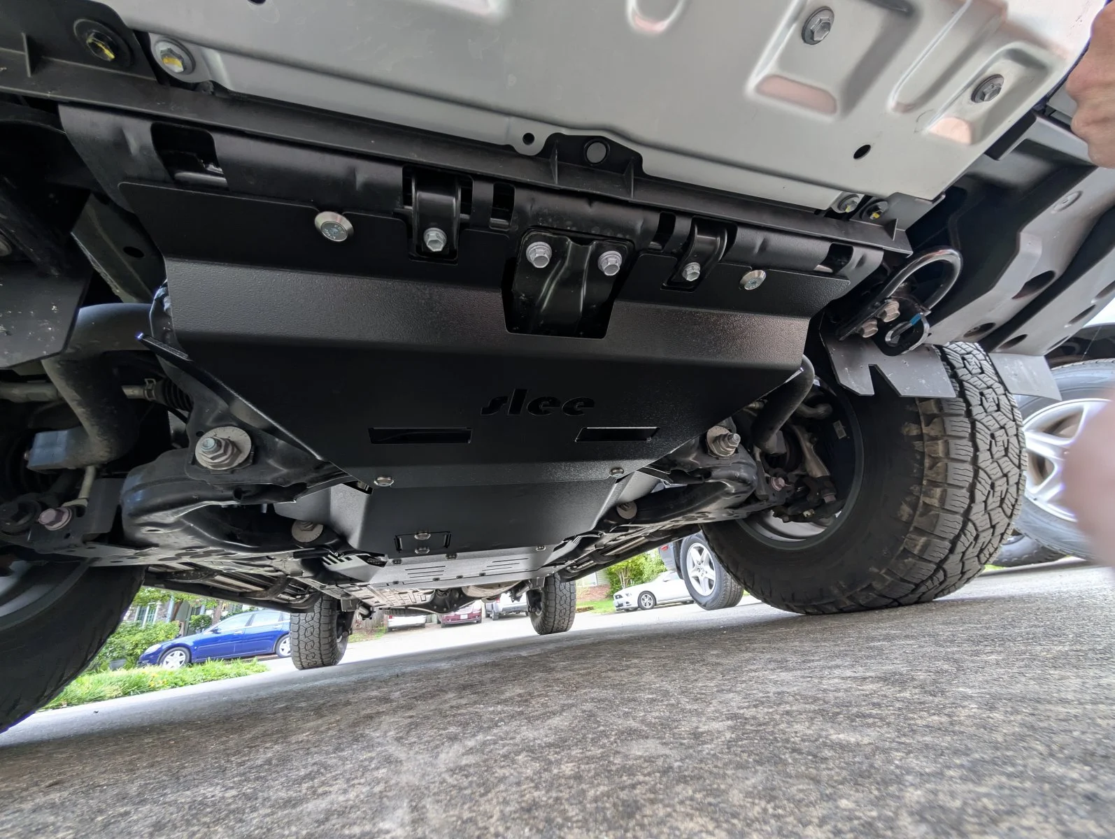

Slee skid plates showed up today.
Beautiful welds, conturs to the chassis unlike the others.. the hardware kit is awesome!

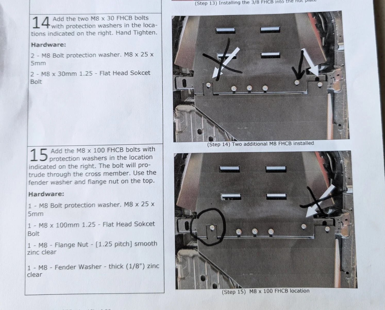

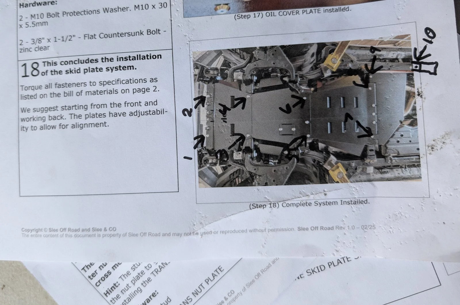

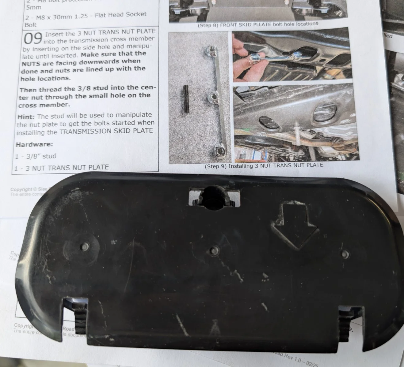

I just received my Slee skids! I'll update with pictures once I get them on the rig, hopefully tomorrow!
Has anyone installed them? Thoughts, tips/tricks

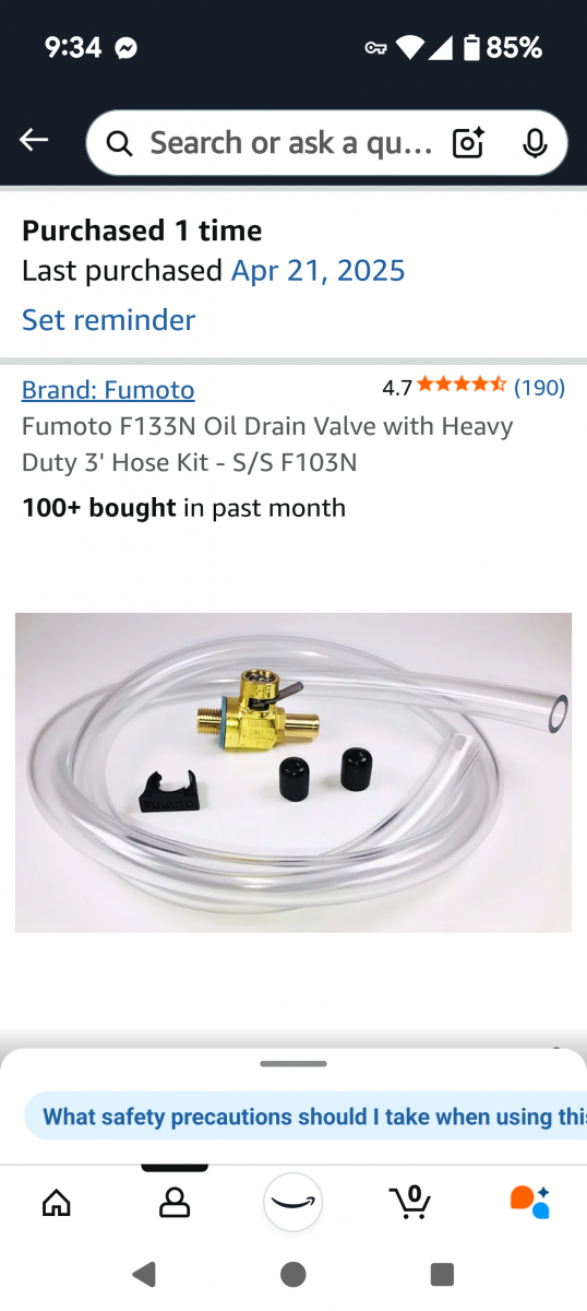

Finally got around to skid plates and looking at the Slee package. Looks like a good solution that give total protection plus an easier way to do oil changes. Are you happy with your Slee package?

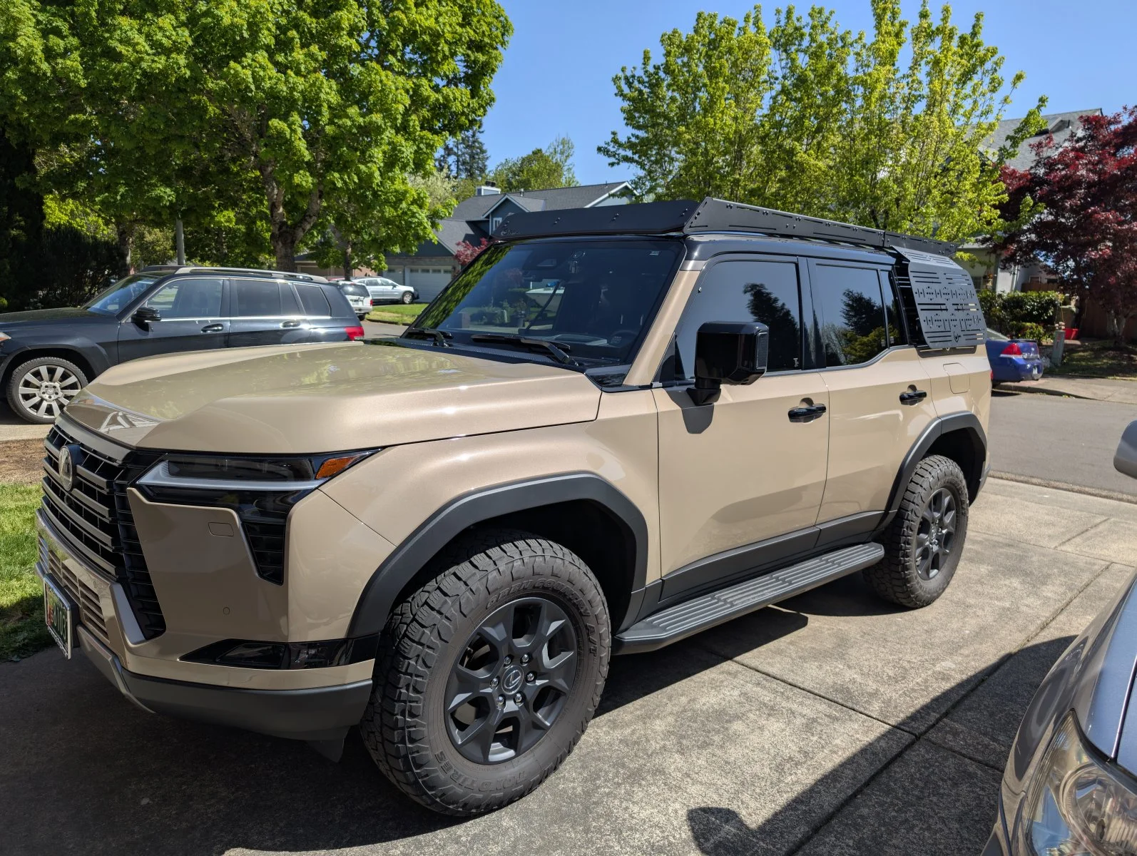

CBI bumper and sliders will make it a lot more capable. Need to start looking at suspension and tires now, whether I like it or not.
The rig is looking awesome so far! Don't hesitate to reach out if we can help you with sourcing your tires, suspension or armor for the next phase!
