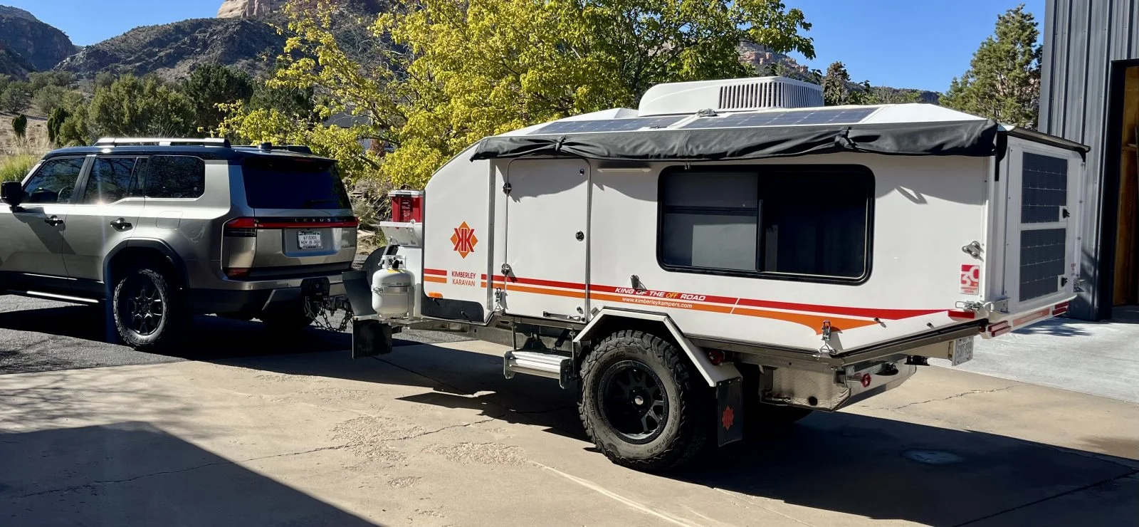

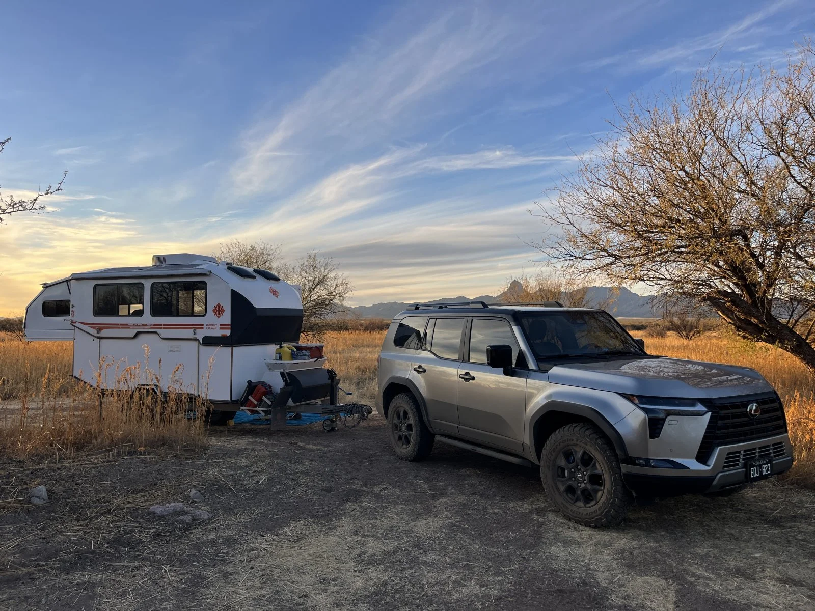

That’s interesting. Driver assistance is disabled when I connect my trailer and use Tow/haul mode. The screen notifies me that it’s unavailable. I get lane departure notifications but not lane centering or adaptive cruise control. I’m towing a 5,000 lbs trailer as well and haven’t experienced any swaying issues. I’m towing an off road camper so I’m not using an anti-sway hitch. I’m sure you already know this, but make sure the tongue is at a slight downward angle and that you have enough weight on the hitch.

What off road camper are you towing? I’m in the market for one and would love to hear your experience.
Sorry for the slow reply. I’m towing a 2024 Kimberley Karavan. It’s a major upgrade from the Taxa Cricket that we had as
our last camper. Honestly, the only negative this I can say about it is that it’s insanely expensive, IMO.
