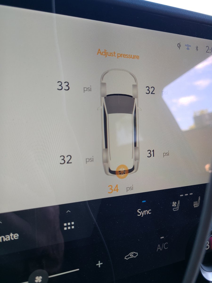

Some time ago after I rotated my tires, I received a tire error icon showing my spare was a couple of psi under the pressures of the other 4 tires. I lowered the spare and used my onboard compressor to pump it up a few psi over the other 4 tires. The error went away. Yesterday, the same tire error icon showed up and the attached image shows the issue? WTF?
I have an issue with Spare tire. It shows alert and i have it at 33psi which exact what recommends
What needs to be done to?
There is way to reset the set point for tire pressure including the spare. Use the "Setting using the current tire inflation pressure" feature under the vehicle customization tab. Make sure all the running tires are adjusted to the correct cold pressure and this function will take the current tire pressure as the correct ones so the warmings won't show up.
That is been said, I still recommend overinflate the spare to about 40 PSI as it will gradually lose air over time.
