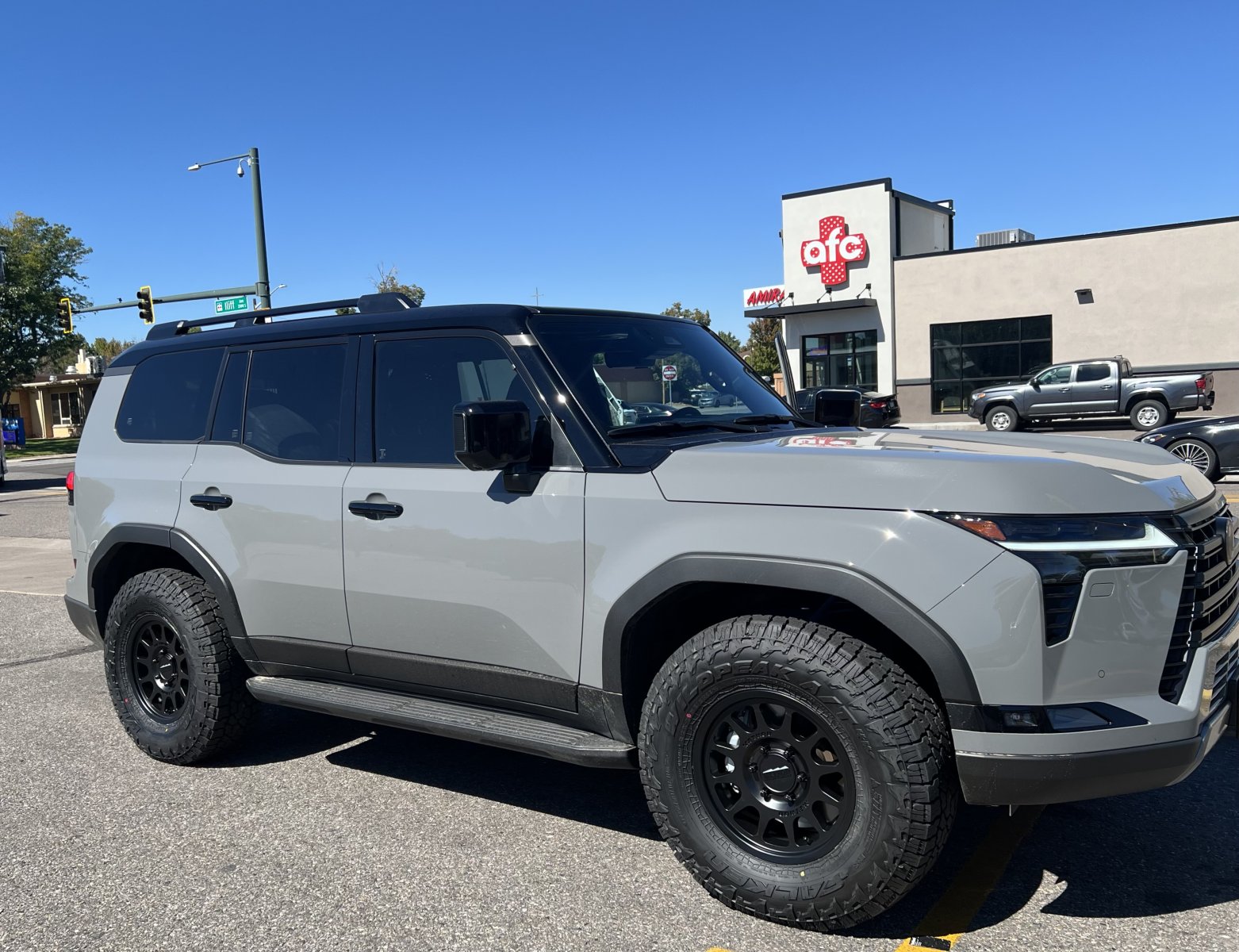

From FB. Said he hasn’t flexed it out but 285/75s clear
What tyre make are these? Also what did you remove (I.e. flaps) to fit them cleanly. The stand tyre that comes with the OT is supposed to be 33 but when you measure it you get more like a 32 and the 3 ply tyre wall I am worried the open countries won’t do well here in Australia with the amount of deflations we need to do over rocks and sand.

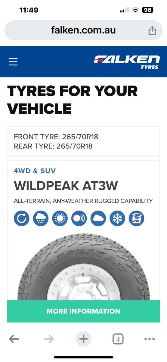

I am getting the OT with 18 inch but want to fit Falken AT3W but when I put the vehicle into the Falken website it only offers 265, they only seem to have 275 on 17 inch rims

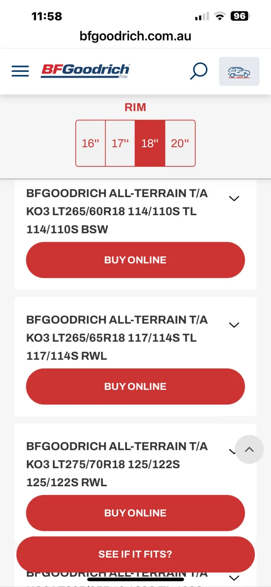

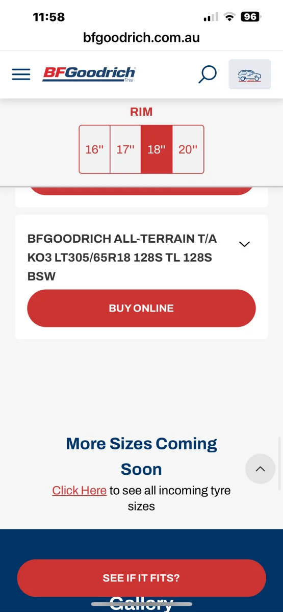

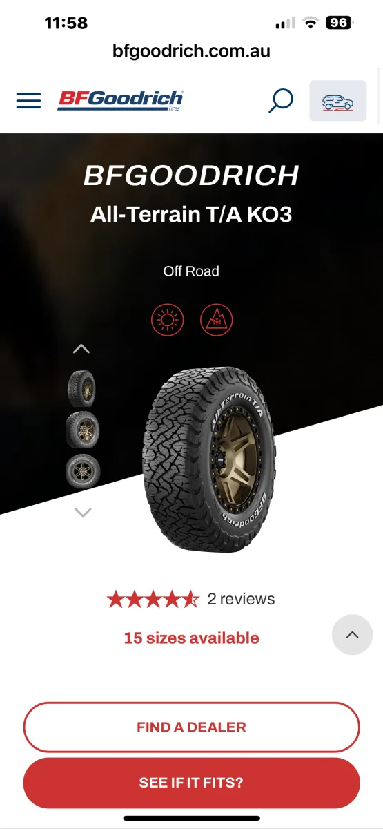

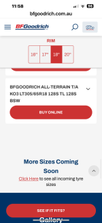

The other option I have is GD K03, but not sure which 275 option fits the standard 18 inch rims without tyre poke:

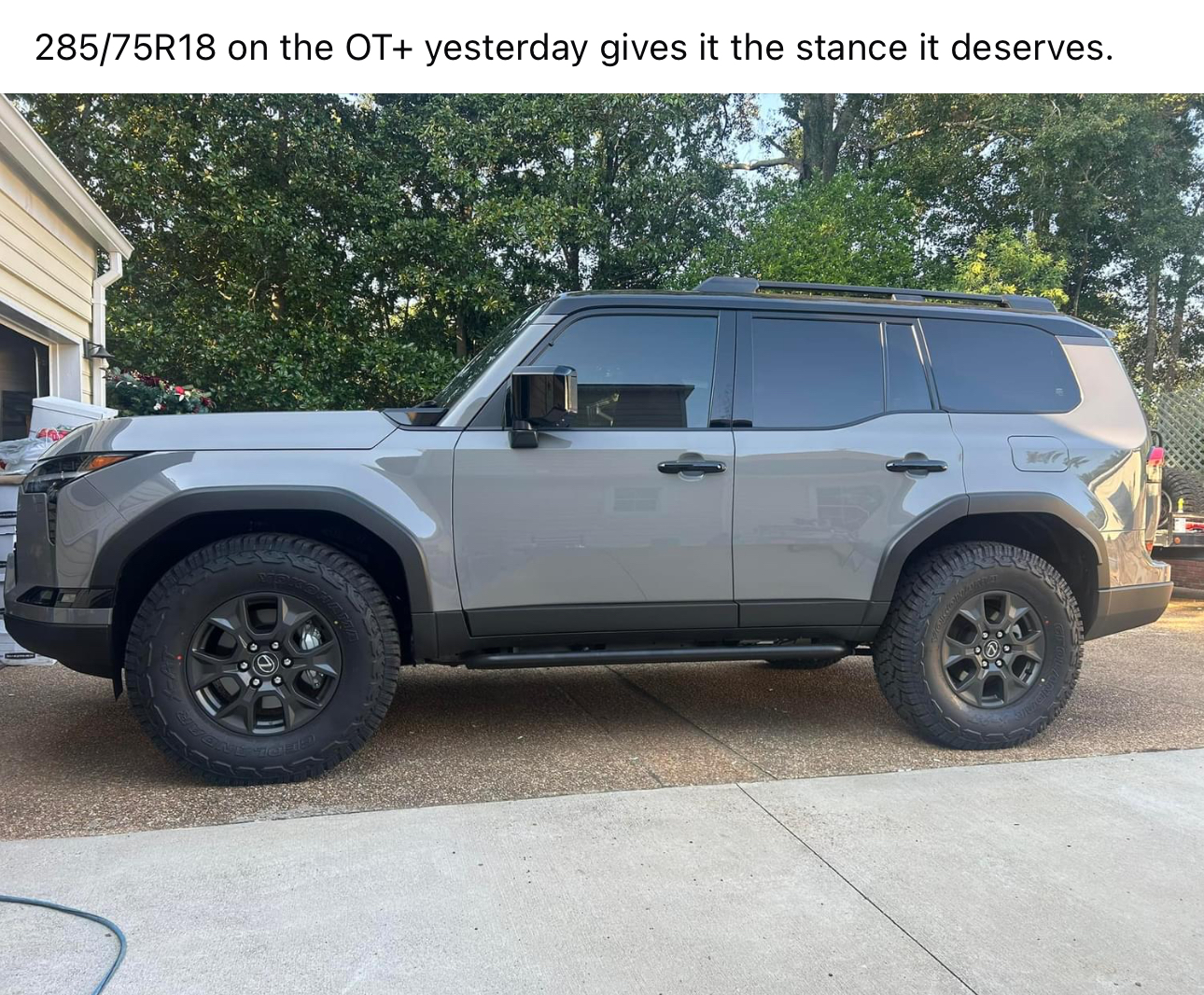

I have the 2025 OT plus so I assume no modifications if I use the same tires, 285/75 18’s KO3’s?
What about the spare tire?
Won’t fit in spare location unless deflated. Won’t rub on stock ‘25 OT+
