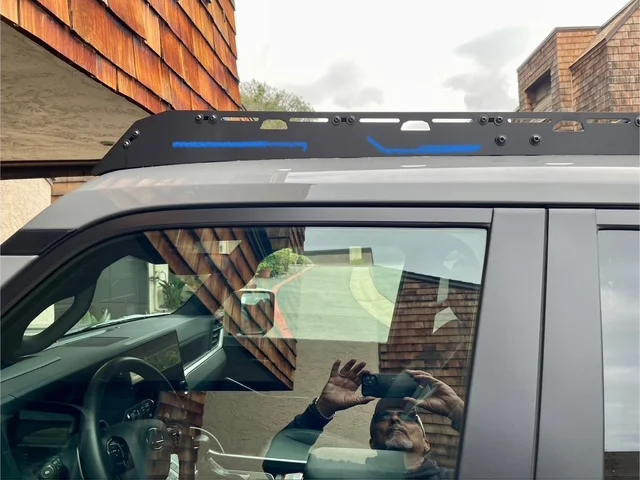

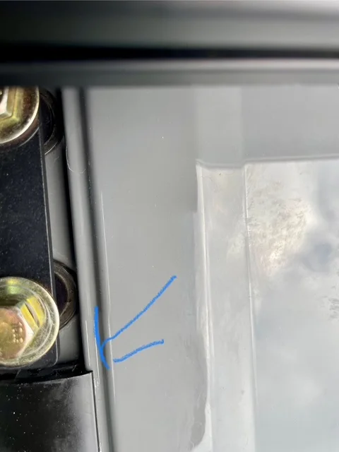

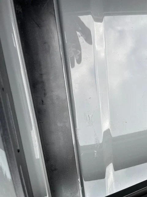

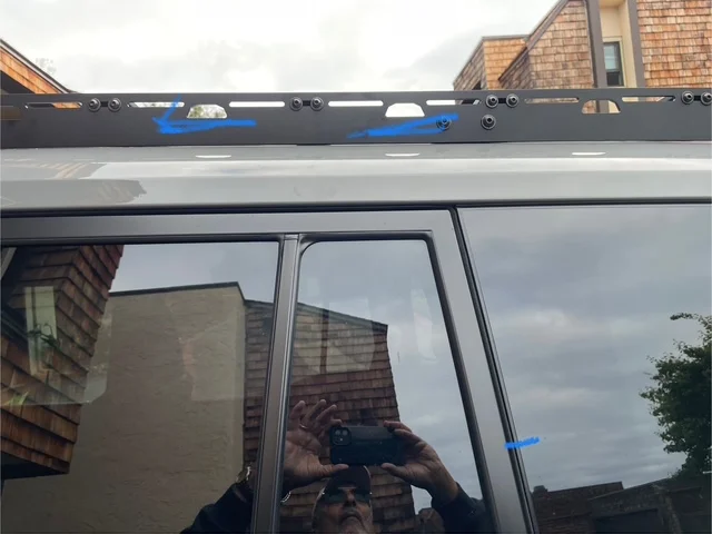

Mine came loose after installing the Westcott roof rack. I resealed it with a few dabs of silicone I bought at ACE
Would you mind sharing a pic of where the weatherstripping is coming loose. Hopefully the dealership fixes it with minimal/no charge.
Yes, I have a few things to do this morning and I will post a few pics shortly
the front and rear are clipped on the ends, but the middle pieces are just pressure fit and held on the ends by the Rack mounts
Yes, that's that was the same with mine. However, when I installed the new Westcott roof rack they must have removed the middle piece and removed the adhesive that held it in place. So I just applied the silicone adhesive to all three pieces and they are all very secure now. Hope this helps. It's a pretty easy fix

yes, mine came off after a rack install, it is only really held in place by the roof bar brackets and maybe sort of press fit in. For now I just pulled the pieces out all the way out they are sitting in my garage. I don’t see how they are actually weatherstripping, more just a trim pieces for the roof “slots”???
The dealer informed me today that they ordered the wrong parts and the weatherstripping was not $1100. They order the roof support bars???? They did replace both sides of the weatherstripping under warrantytoday and all seems good for now.
