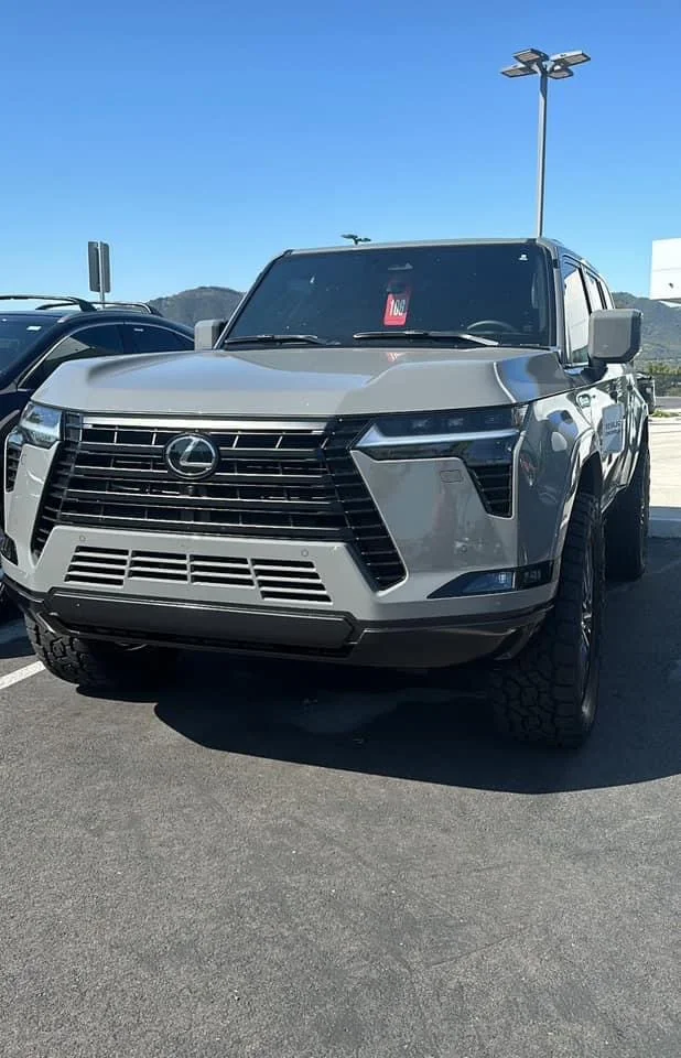

For what it’s worth, I saw an overtrail at a dealer this past weekend that had 33 inch tires, 275/55/20, with no lift kit and it looked great/taller
I probably would have kept the 18’s and went with a 275/50 , but that’s just me.

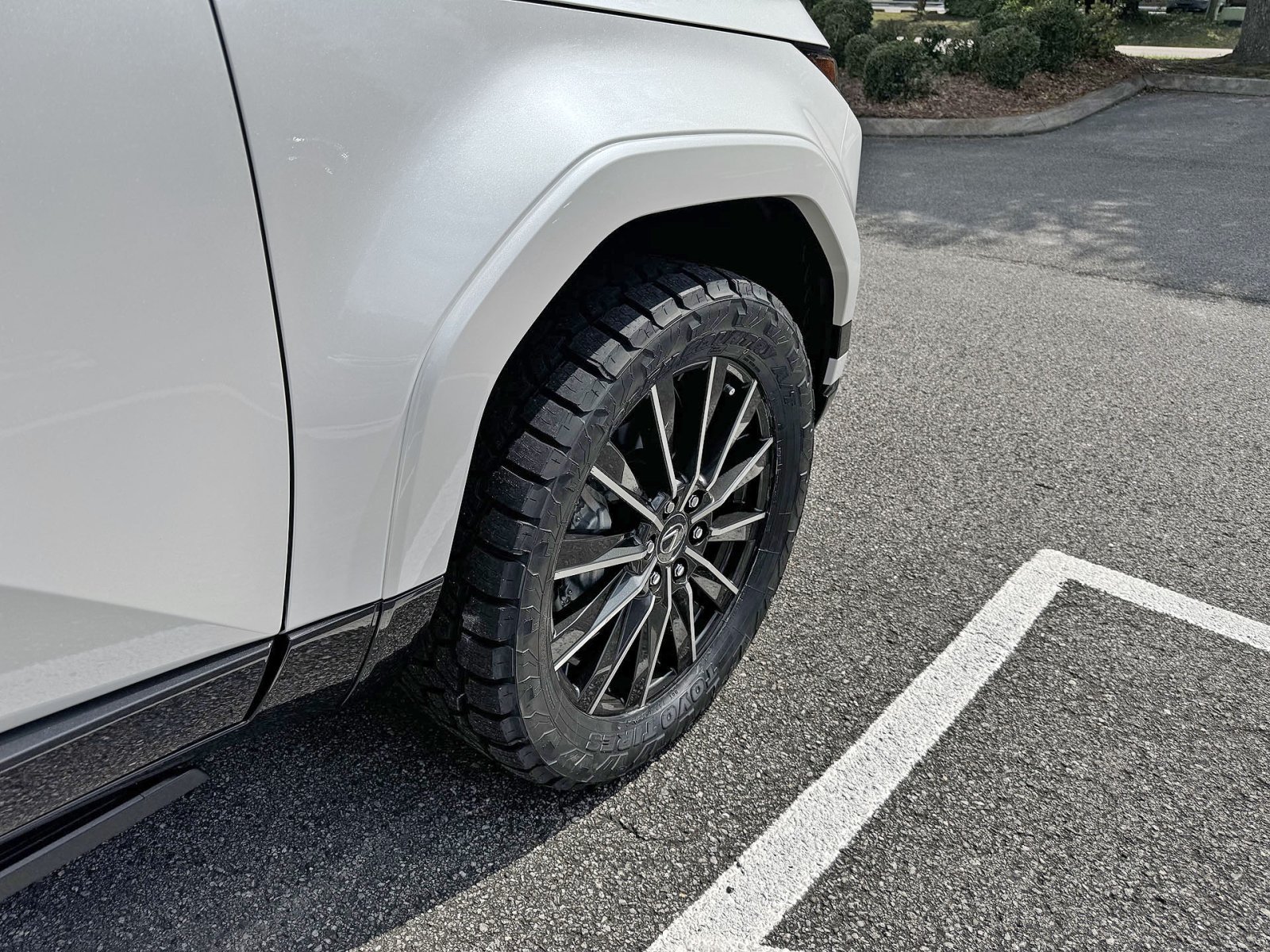

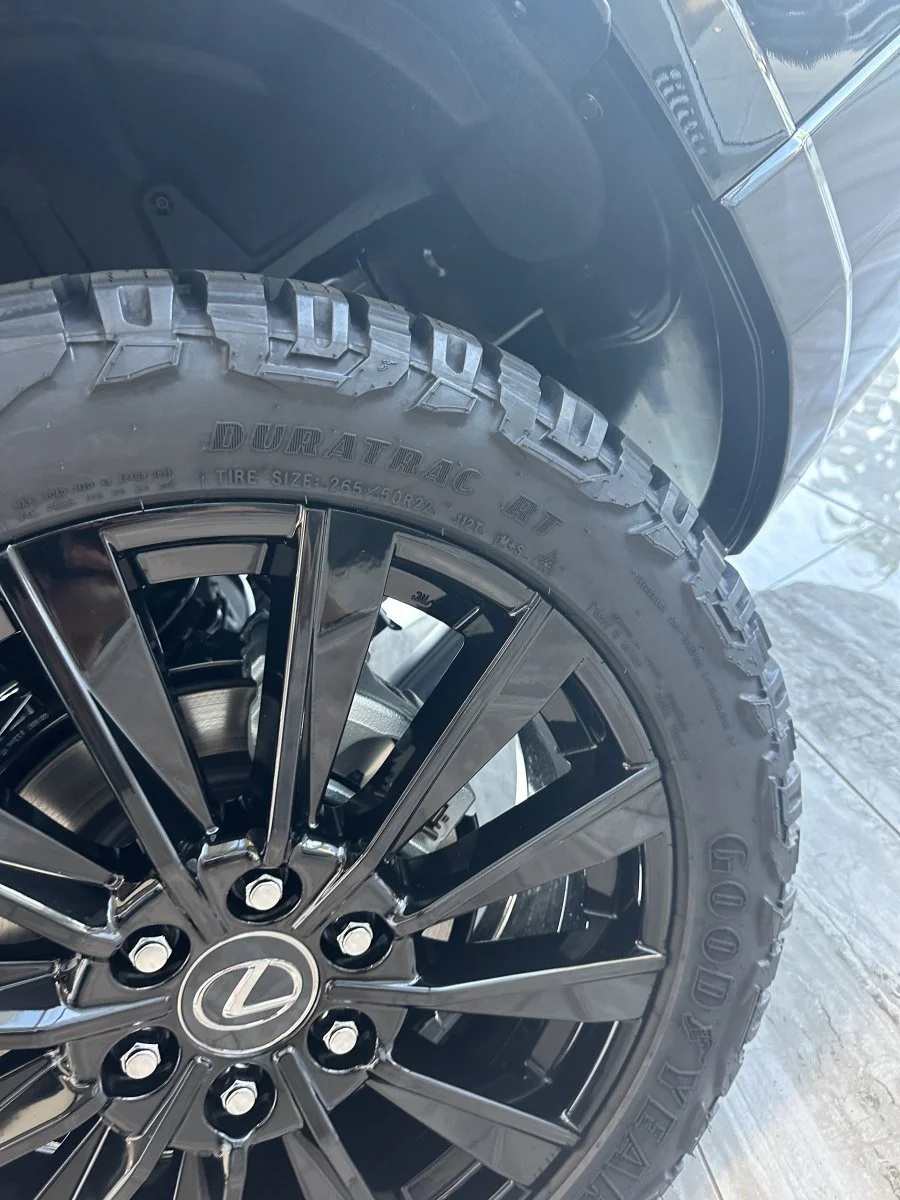

Anyone seen an upgraded tire on the luxury + wheels(22’s)? I recently purchased mine and it looks like a 275/50 would easily fit with no rubbing and give more cushion/sidewall.
Side note, Snapped this pic at my dealer of duratracs on an OT with the Lexus 22’s from an LX. 265’s though.

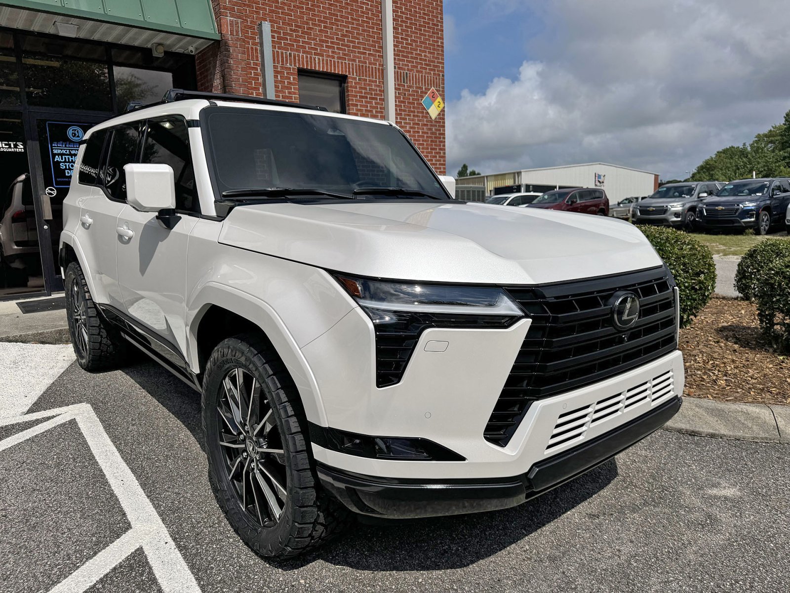

That’s an easy fit. This one is on 285/55.
I’m running 285/70/17.

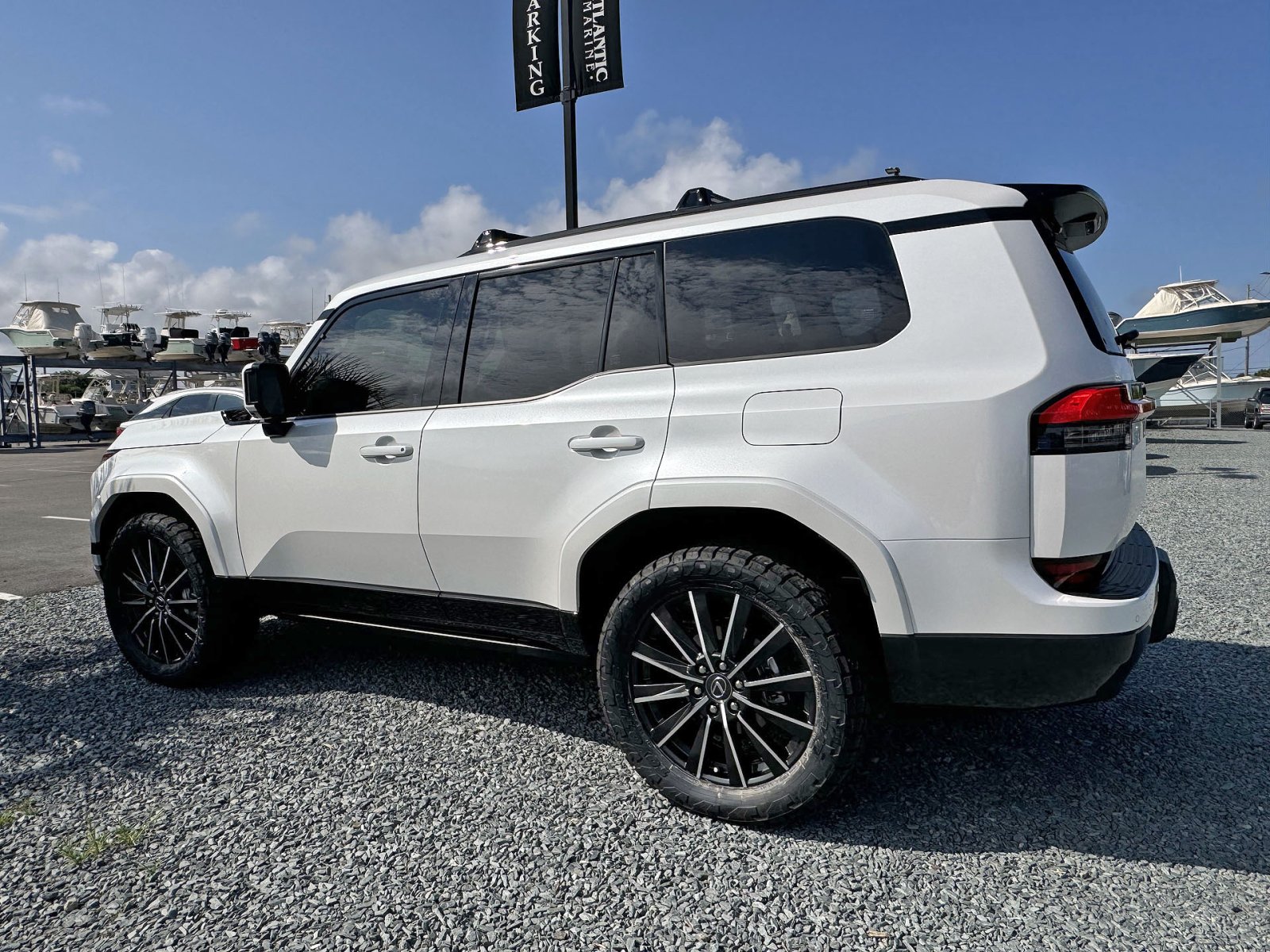

Trying to figure out is that full stock without trimming? Rubbing like hell? I have lux plus and really want the 285/55s, but worried it is too much tire over the 50.. Any help would be sincerely apprecaited on the details of that truck?
I’m worried about the same but looking at that pic, it doesn’t look like the tire hangs over the stock 22s that much. And if it does fit without rub, imthats what I’m going to with.
Anything 285, 55 or a or 50 asks for an 8-10width but in my experience with 4Runner stock wheels that were 7’s, it’s usually not a problem. They just wear weird.
There’s a pic on Lexus IG with a GX for a good festival running 285/50 on 22s but they look like maybe a wider rim.

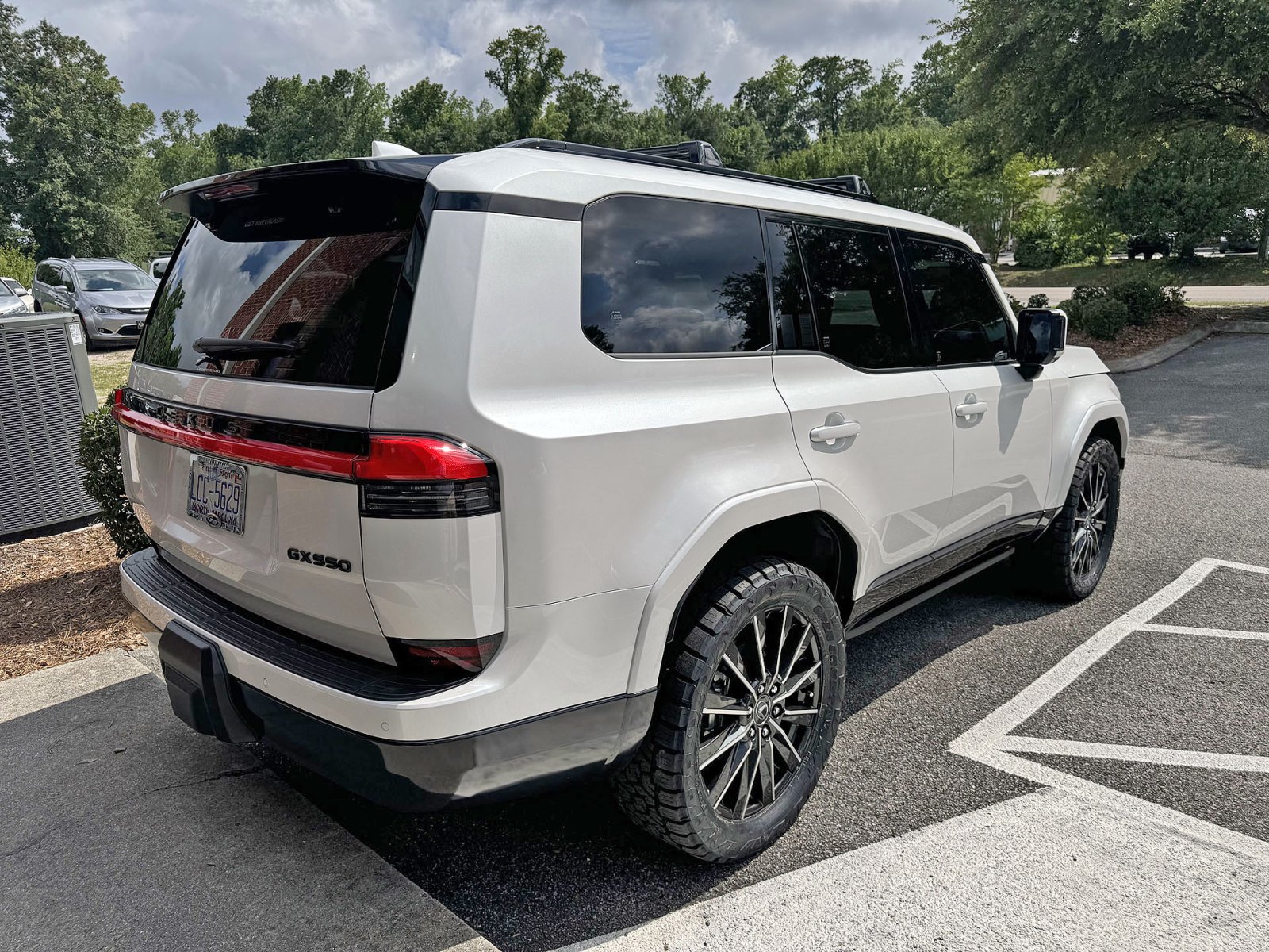

I ended up going with Toyo AT3 285/50/22. fits like a glove with zero rubbing. 33.3 x 11.7. the 285/55/22 would have been too much tire at a full inch taller in my opinion. I am currently running 38lbs of air and all seems great.
View attachment 1636View attachment 1634View attachment 1635View attachment 1637
This looks pretty nice. I have the stock 22s as well. Is the speedo off with this setup or does it have same diameter? Also how’s the road noise compared to stock?
