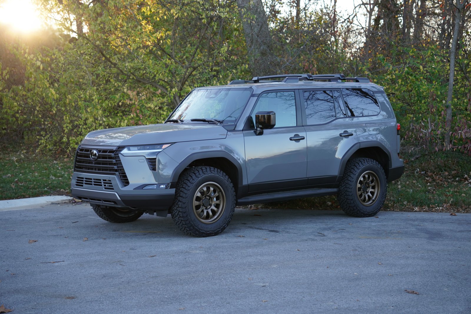

The wheels fit perfectly.
The GX550 Center Bore / Hub Bore is 95.1 mm, so I ended up buying some hub centric rings from Amazon. And the stock lug studs are super short, so I ordered some extended lug studs. As many of you already know, it's a common complaint for aftermarket wheels. I was only able to get thread engagement on about 12mm. I'll be installing the extended lug studs soon.
Size: 18" x 8.5"
Offset: +20mm
Bolt Pattern: 6 x 139.7mm(5.5")
Center Bore: 106.3mm
BFGoodrich T/A KO3
LT275/70R18
I have a set of Titan7 AK2 with the Falken Wildpeak A/T4W LT285/70R18 that just barely rub on the stock safety frame. I'll start another thread for that.

I'm planning to buy the same tires using the factory wheels. I believe this tire size is the largest that can fit in the spare slot. Your vehicle looks good. Thanks for sharing.

Do you have a lift or does 275/70/r18 fit with no rubbing and no lift?
