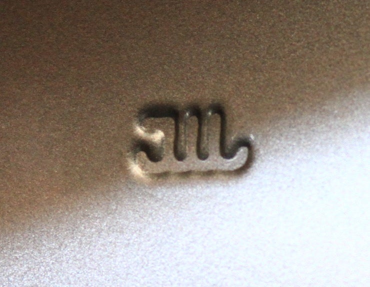

Pretty cool if true but the 22's are made by Rays. The OT wheels are made by Enkei based on the logo.
*EDIT they aren't Enkei. I mistakenly thought the logo that looks like an "m" were Enkeis since I've seen them before. Turns out it's "JWL" or a Japanese wheel certification.

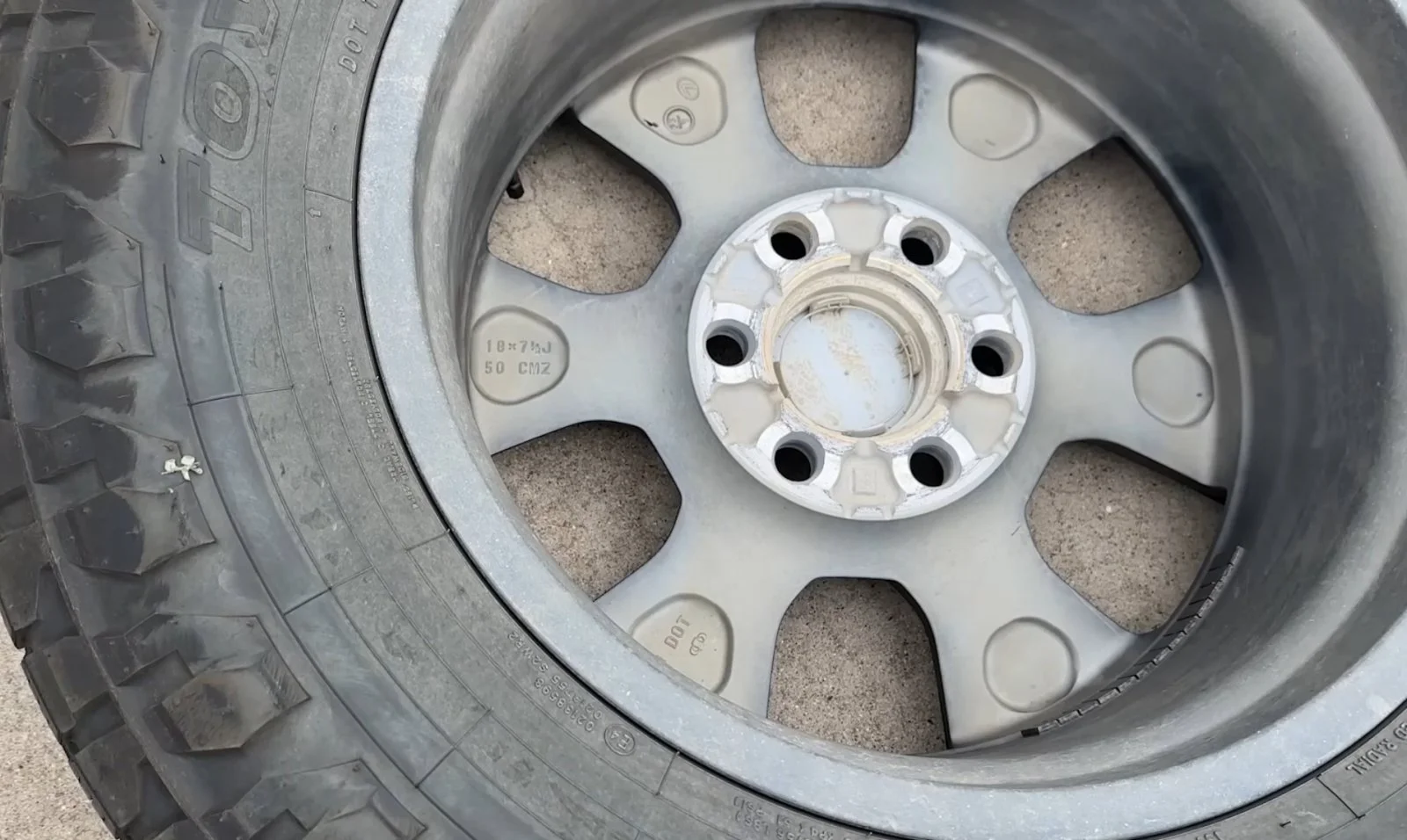

Hello, I believe the OT/OT+ 18"x7.5 wheel offset is +60??
Edit: it is +50, for Land Cruiser its +60
Just wanted to toss this on here because to this day I keep seeing controversy as to what the stock OT tires specs are.
C&D did a good suspension deep dive and included a shot of the back of the rims with the stamp.
Can confirm we are 18x7.5 with 50mm positive offset.
Figured some might want to see it for themselves with so few trucks out in the real world still.

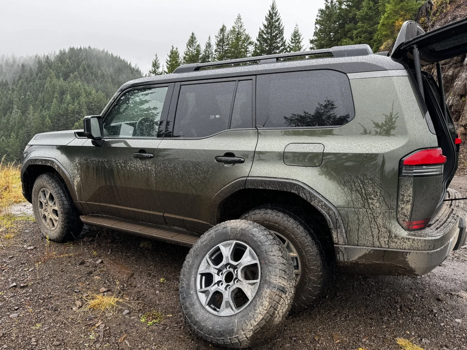

Got a rock puncture on the first time I took my Overtrail+ out on the Oregon forest roads... roads that I've been on many times with my Rubicon with Nitto Trail Grapplers with no issues. So, I'm worried that these tires just won't hold up to basic off-roading; considering BF Goodrich or Nitto replacements if I can find the proper size...
