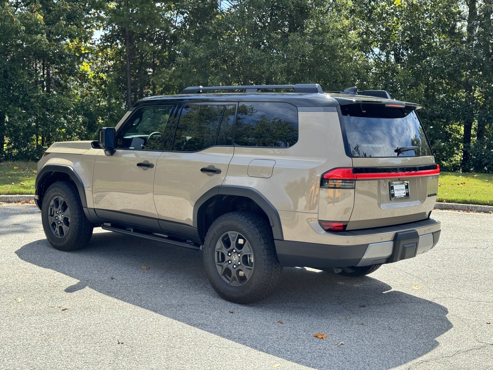

New GX550 OT+ with 1700ish miles on it. So far it's been great and a huge upgrade over the car it replaced.
Not planning to go too crazy with it since I like how it already sits from an exterior standpoint. Mods so far include:
Exterior and Interior:
Xpel PPF Wrap on Front Clip
Full Ceramic
35% Tint of Front Glass
Leather Shield Ceramic for Interior
Fake engine noise coded out (SOOOOOOO much better)
Performance:
JB4 Map 2
Initial Thoughts:
Getting rid of the augmented engine sound was a HUGE upgrade for me as far as interior comfort. For my ears, it drones especially in the Sport+ drive mode. Fortunately, it can be disabled at the dealership without impacting the noise cancelation.
The JB4 running on Map 2 really woke the GX up. Part throttle driving is vastly improved with acceleration feeling even more effortless than stock.
Full Ceramic
Performance:
JB4 Map 2
Initial Thoughts:
