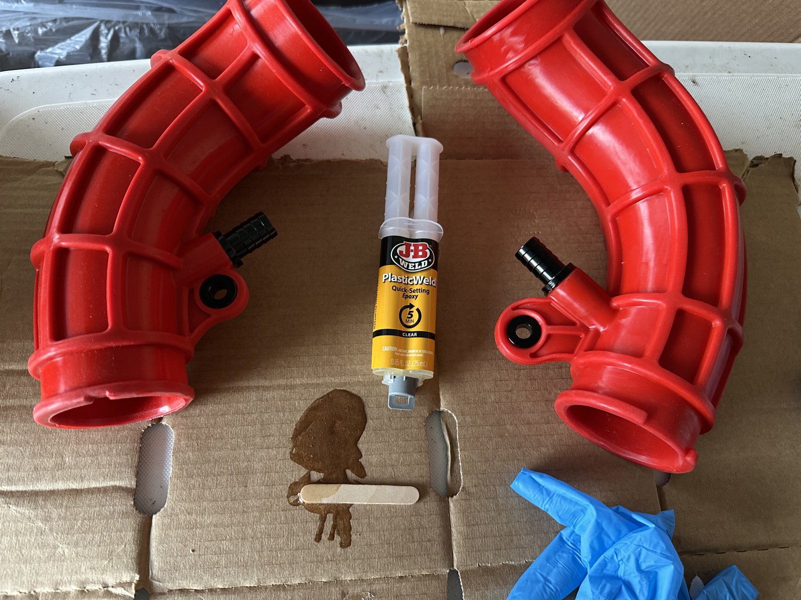

i tried to do that before i installed but they gave me the run around.. i showed them my CEL and code and they finally sent the pieces

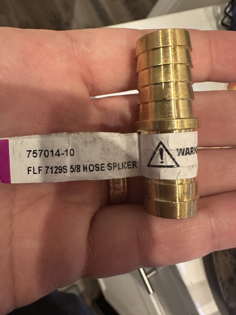

5/8 inch brass. I tried it, but it pulls out easier than the vinyl ones that came with the kit.
is there a chance any of the RTV will break off and get sucked into the engine?
