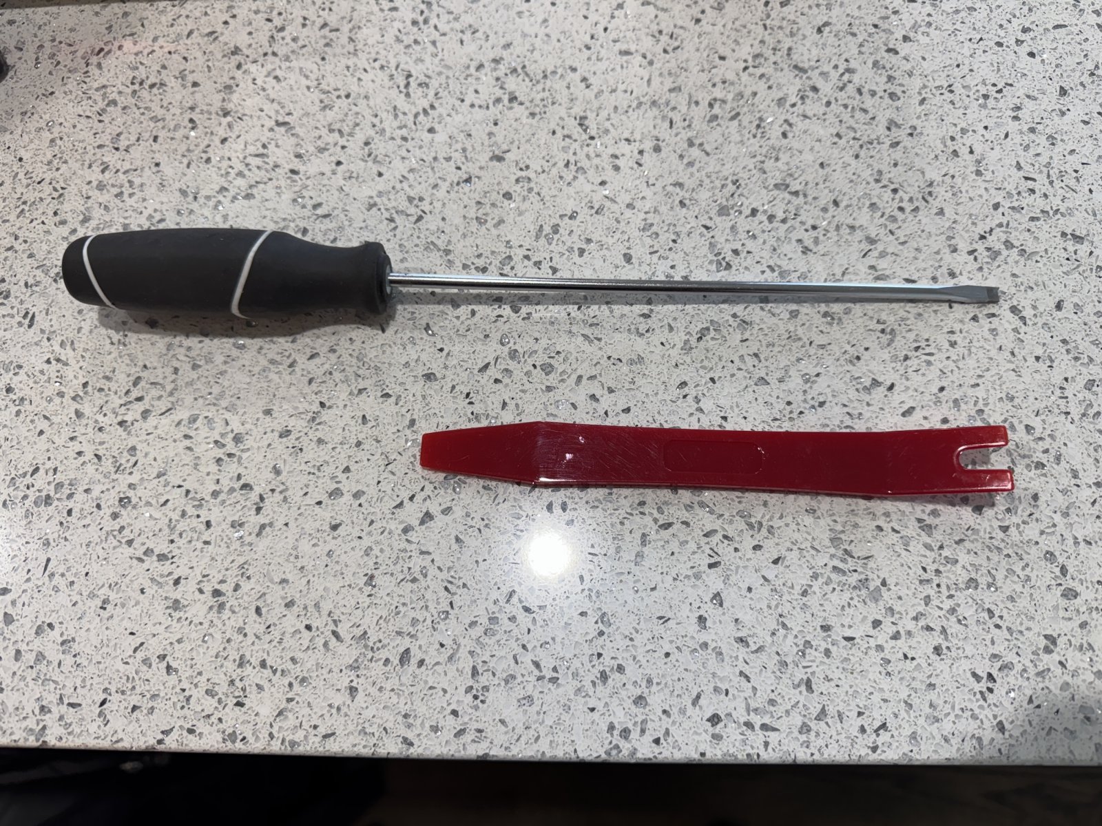

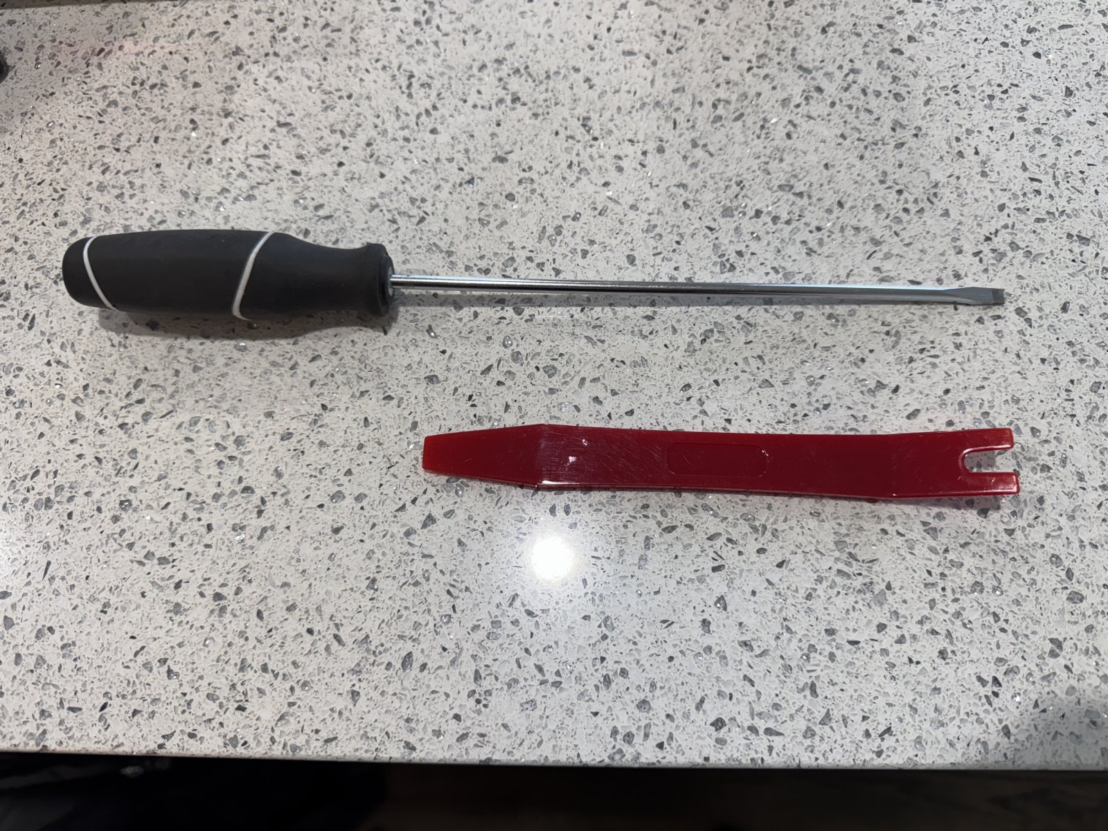

Ugh, I can't get it off for the life of me. Holding it with pliars and already broken the plastic tab on one side.
Oh lord. No. Don't use pliers. You'll want a small tip long screwdriver to depress the locking tab. It will slide apart pretty easily then if you take that approach.
There was no way I could hold onto the end plug without using pliars. And I couldn't find any slot that could be depressed to release the end plug. Information that should included in the instructions. I even emailed them for assistance and got nothing back.
You hold the plug in place using a trim removal tool that slides between the plug and the white clip. You'd then use the flat head screw driver to depress the locking tab. It will then slide apart.
These are the tools.
Thanks! I was able to finally get it off. Connected the CAN cable and connected it to my laptop. Then it got dark, so I'll finish it tomorrow. But after I unplugged everything. I got a Check Engine Light and System Malfunction. I'm going to assume I'm going to be able clear those codes?
Yes. You can clear the codes using the Diagnostic tool in the VF Tuner software.
