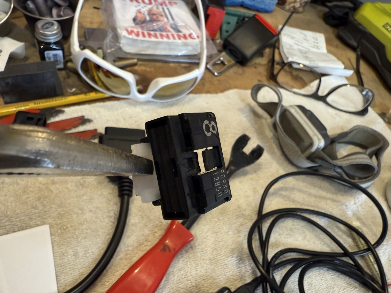

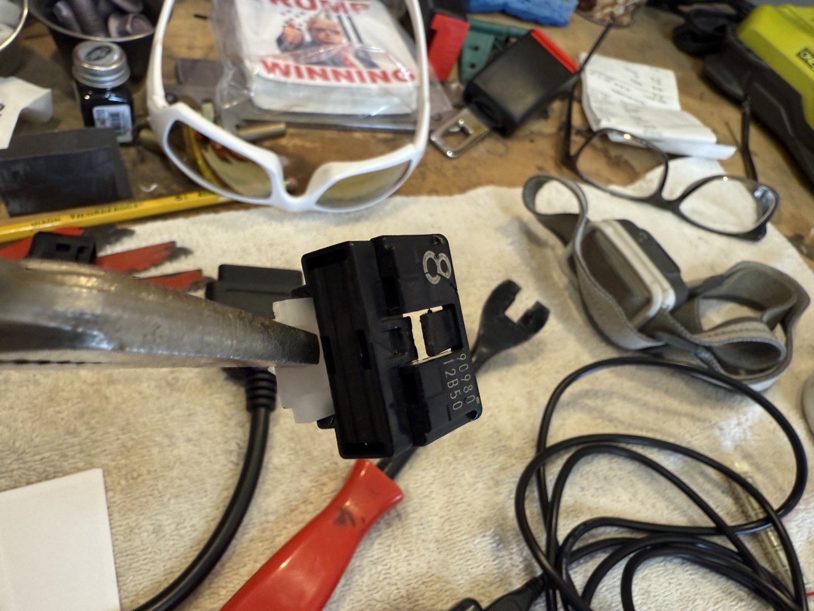

Finally, got a chance to work on this. On page 4 of 5 of the CAN connect guide. Any tips on disconnecting the End Plug from the harness? I've tried using a screw driver and trim tool and can't dislodge the end plug from the harness to connect the CAN cable.
That plug is hard to remove - hard to even get to it. I tried to use one of my tiny flat-head screwdrivers but it wasn't long enough to get in there, so I used a long screwdriver with the smallest flat-head tip I could find. I used a trim tool to kind of brace the clip because it's so wobbly and I jammed the screwdriver tip into the plastic and it eventually gave up the fight.
I had a little pic that I used to lift the tab up with, then bent it over with a flat head screwdriver. I used a bigger flat head to lever the white clip out of the hole it is inserted into. Damn hole is pretty freaking tight for my hands.
