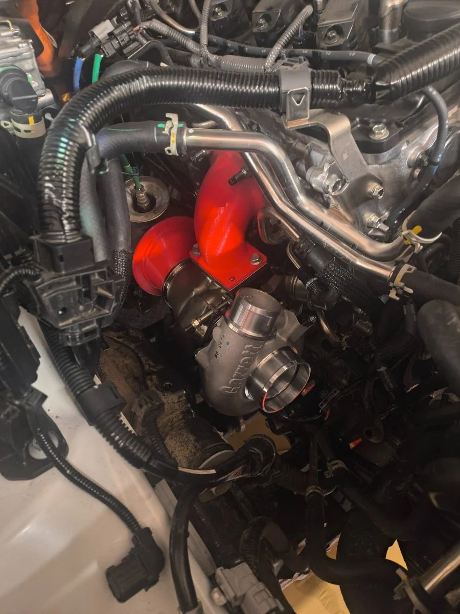

Also, not GX related..but GX goodies are coming too...
here's whats coming for our Land Cruiser :)

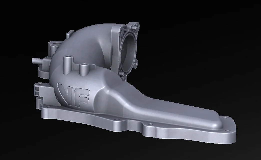

Coming soon for the GX550 ... we will have a full bolt-on power package (upgraded intercooler, intakes, catback, VF Big-Mouth UIM, intake Manifold...and other stuff ) (26% increases flow limit vs stock)

What is the ETA on this? Reliability estimations? Power estimations?
VF Tuner made my GX way way way better. This is how the GX should have left factory.
The kit (tuning kit) is available.
The hard parts ~ June is likely.
