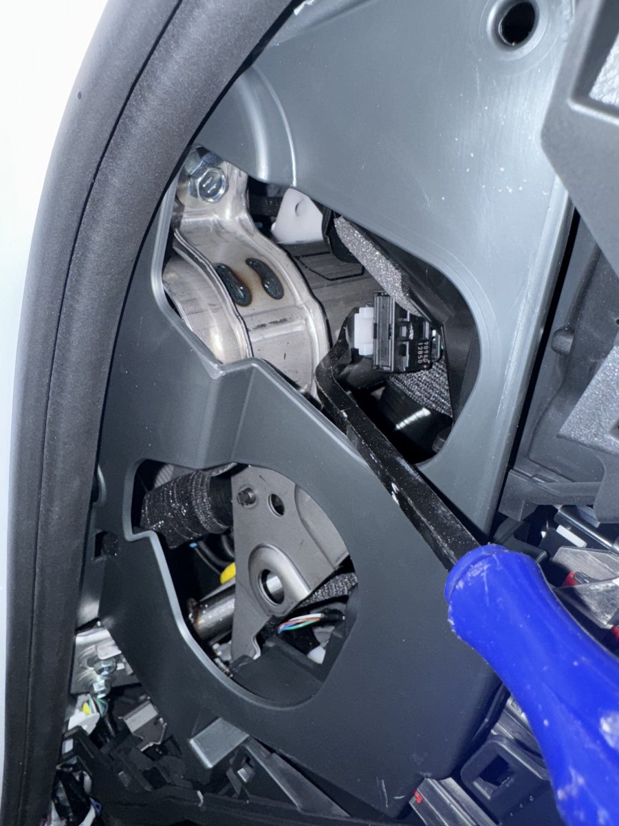

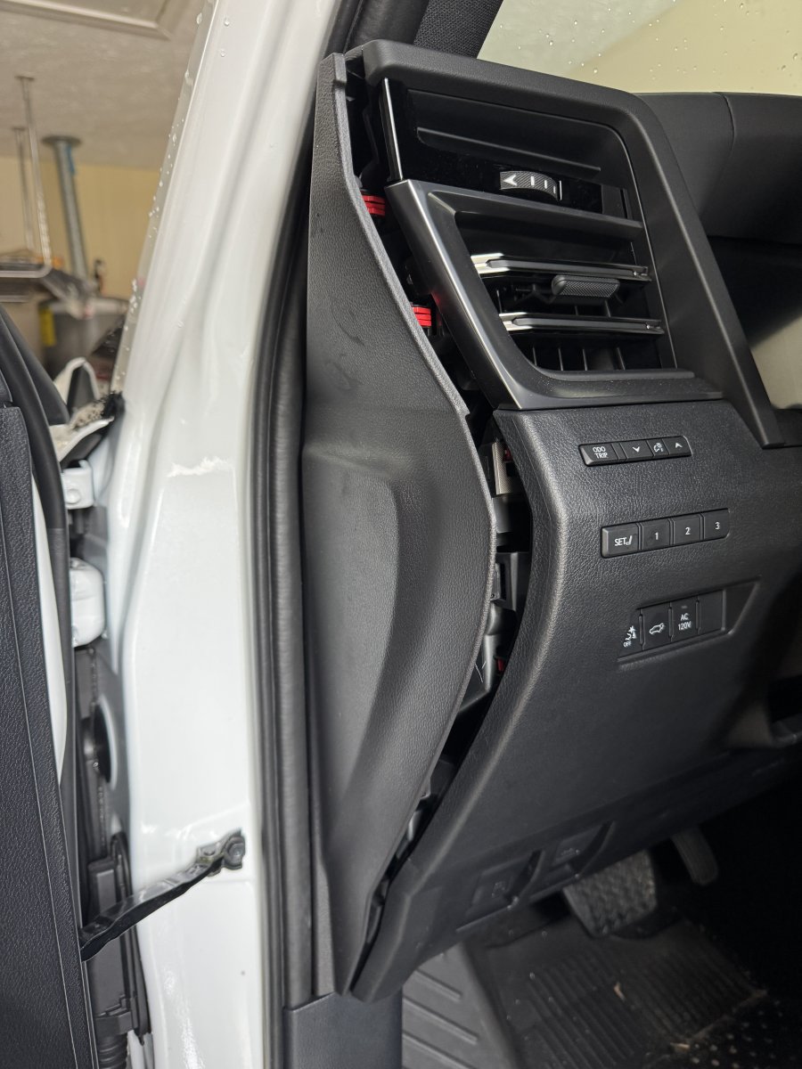

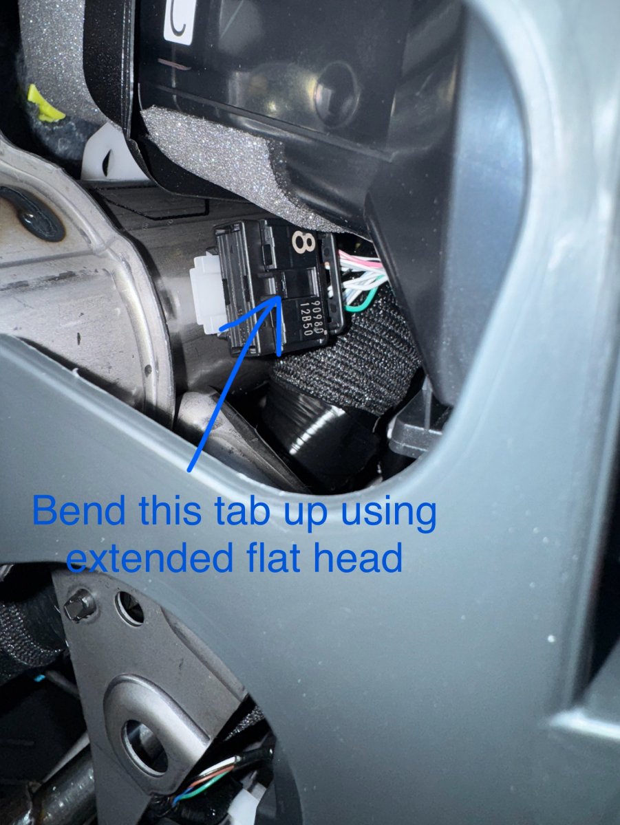

Thank you for posting this - I could not find any info on connecting the CAN cable on VF's website. Getting the blank cap off and then getting the CAN cable connected is a major pain.
I got everything connected and I zip-tied the flash device back there like thankcu35 did in his pictures above.
I tried reading the ECU and ran into some errors. Now I have a check engine light and multiple system malfunctions. Not going well over here. I shouldn't have tried this on a weekend!

From here on out, you will need to install the CAN Connect cable to your vehicle (attached in this email is the guide) and your WiFlash device should be connected to that CAN Connect device for ECU Read and Flashing.
This is where you have to get behind the dash and remove the blank plug from the CAN connector and plug in the VFT adapter. I had no idea where to find this plug - VFT's email said a guide was attached but I've had problems all along finding and opening VFT's attachments - as munkeeboi already mentioned, the attachments are embedded in the emails and they don't show up like every other attachment I get via emails. I found thangcu35's photos posted earlier in this thread and that showed me what I needed to know.
