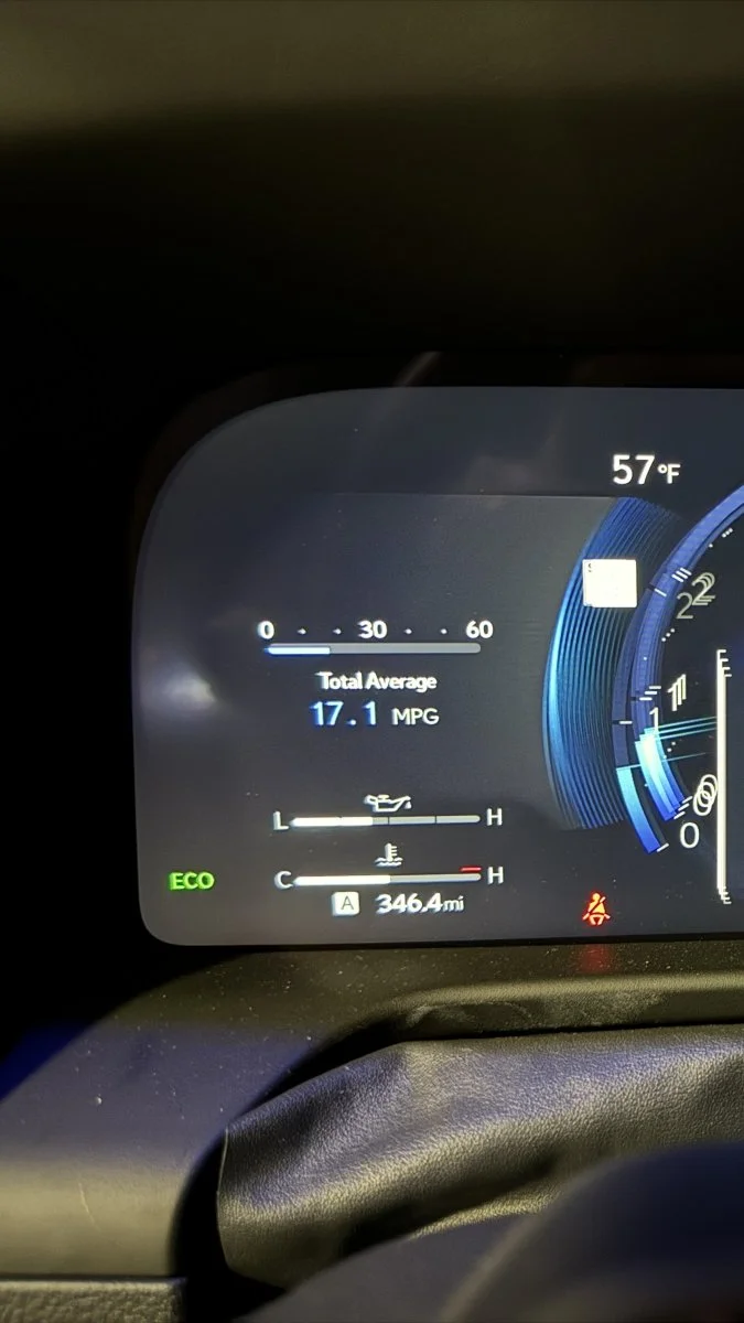

Report from halfway from my trip. Mileage is slighly better +.5 mpg on this trip compared to last. Avg speed was 70 mph on cruise control. Plus side is this better mileage is after installing the westcott lift. Interesting part is that I went 346 miles before the gas light went on. My fill up when it clicked off was 17.6 gallons. Hmmmmm…
