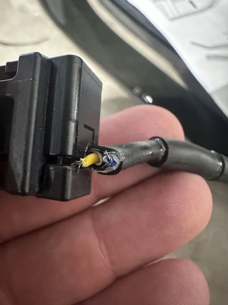

My cable snapped as well…very very light twist to put the cable into place to receive the connector. This happened a week ago, I emailed a few times and the response I received was that a free invoice would be sent for a replacement with a shipping label for the broken one. It’s been 3 days…I have yet to receive this invoice.

The CAN connectors have only 2 wires for the CAN on them, we going to try to make them stronger / more robust. I will be back in office tomorrow,
the CAN Connect instructions were emailed to everyone and will be on our website as well.
Yes I mentioned because I was not in office, in that email. You should have it now.
The CAN connects are a little fragile but I am surprised they are breaking so easily. The wires are thin ..but shouldn't just snap at the slightest bend. We will fix it and replace.

VF Will get the broken CAN connects replaced this weekend as well.
Thanks for this. I don't think duct tape is a good way to secure the cable and the connector. Perhaps shrink wrap to ensure there's minimal movement of the wire might help?
We used electrical tape to secure the wire sheath, but it seems to not have held,
We don't use duct tape. The new one will use some additional secure backing

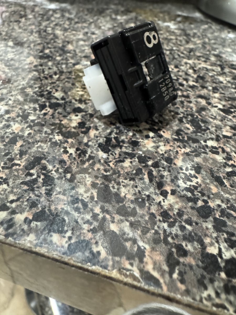

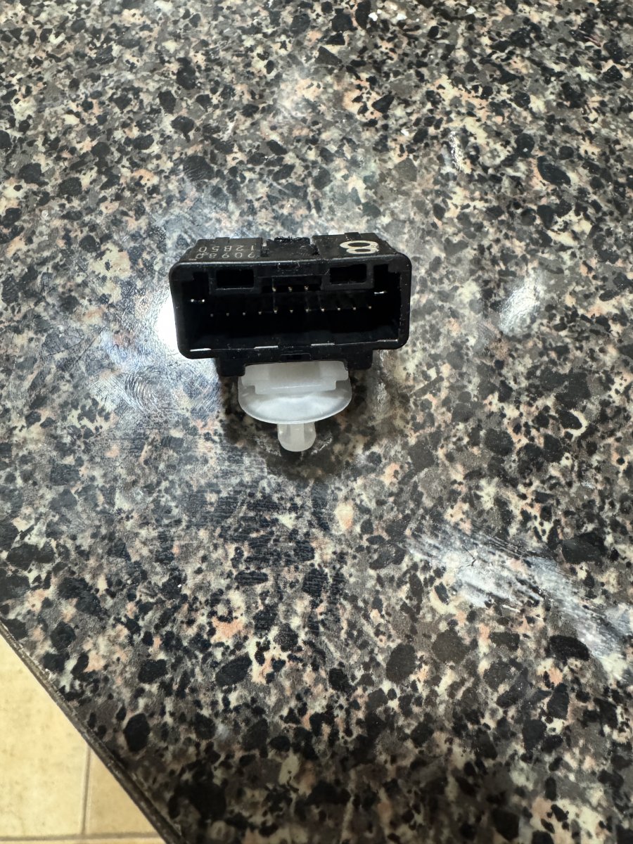

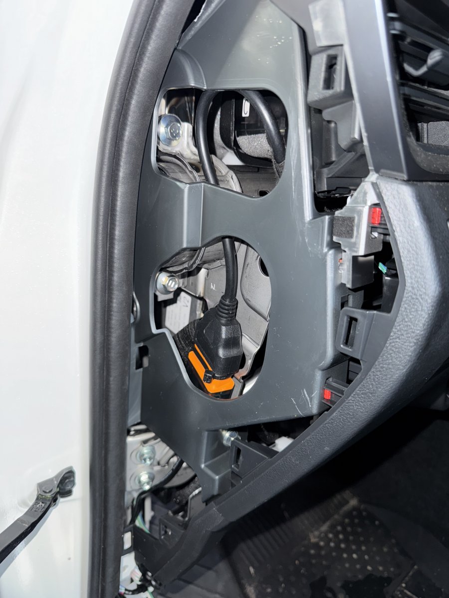

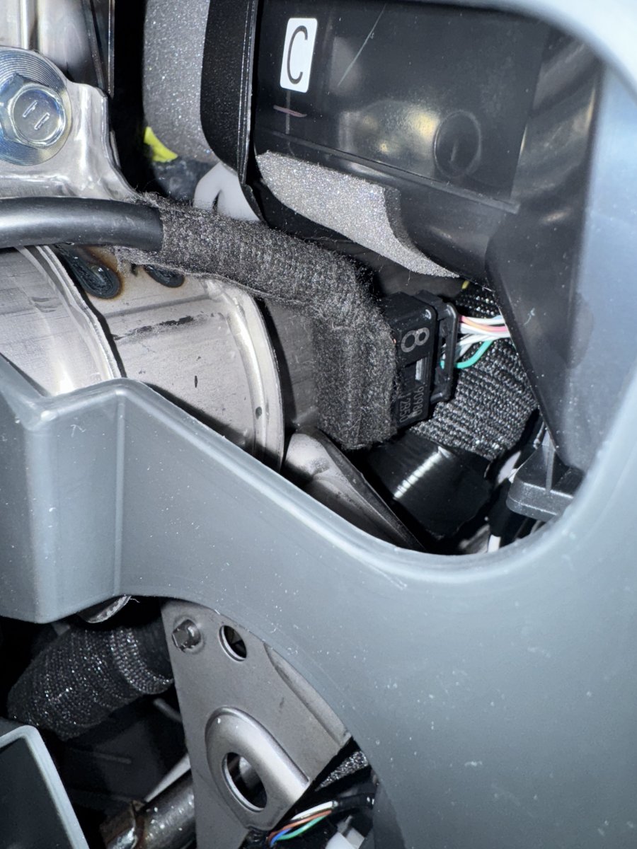

The vehicle’s CAN connector has a black cap that is secured to the frame using the white plastic clip. Since there is limited room to work with, I left everything intact to allow the white clip to hold the CAN connector firm in place. I then bent up the small tab that holds the connector to the cap using a long flat head screwdriver. Once the tab is bent, you can then pry out the white clip and pull on the black cap (with the white clip) to disconnect it from the harness side connector. Attaching the VF’s CAN cable to the vehicle’s connector also requires some finessing. I secured the Wiflash to the area with a zip tie and ran the usb cable down to footwell where it is tucked away.

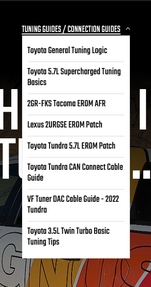

you can go to resources > new customers start here guide on our site
are the CAN connect instructions on the website yet?
Yes sir, under tuning guides / connection guides
