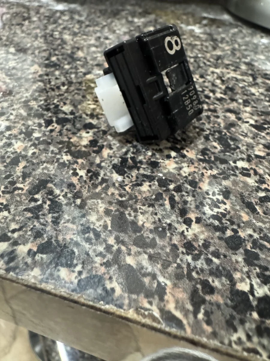

The unplugged cable doesn't connect to the CAN connect cable. Can you confirm this is the correct male that's to be plugged to the CAN connect?

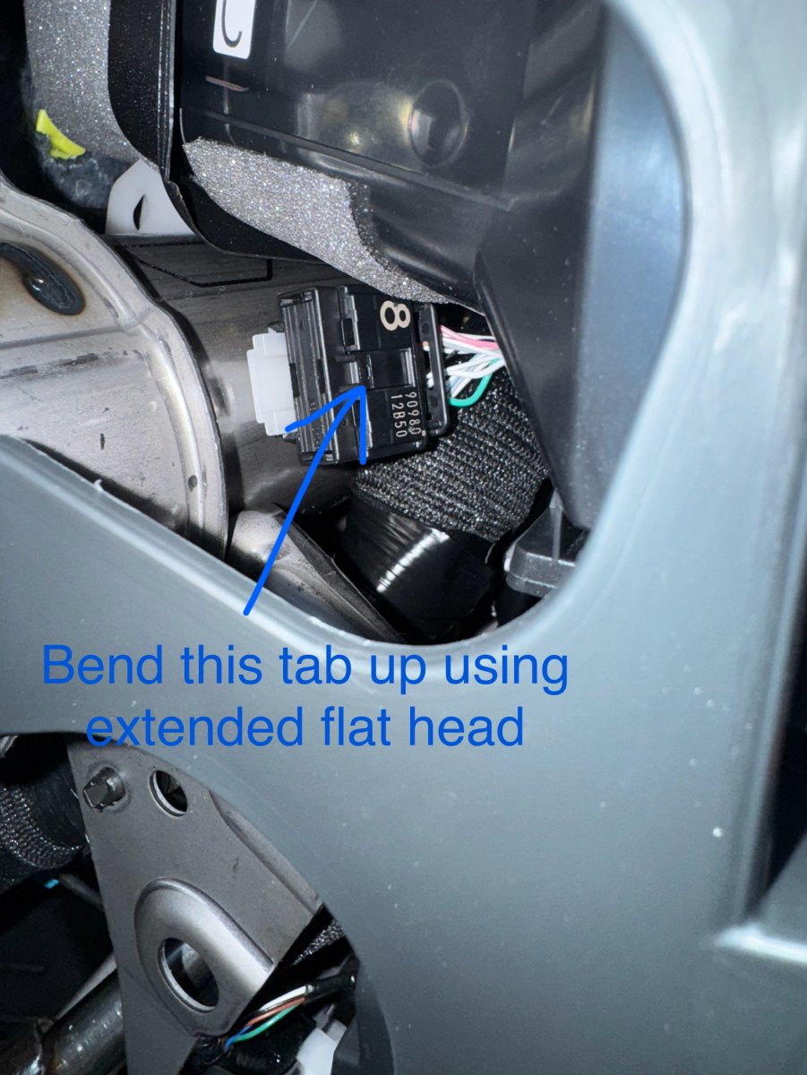

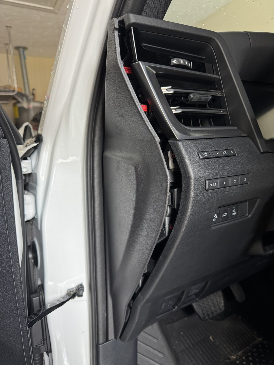

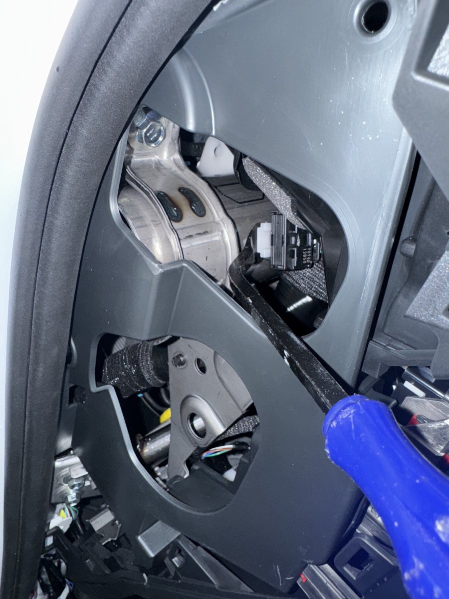

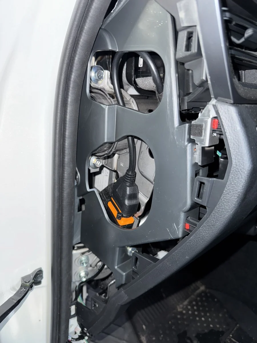

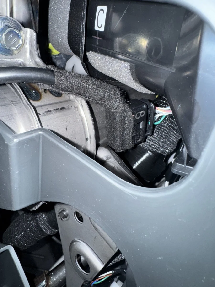

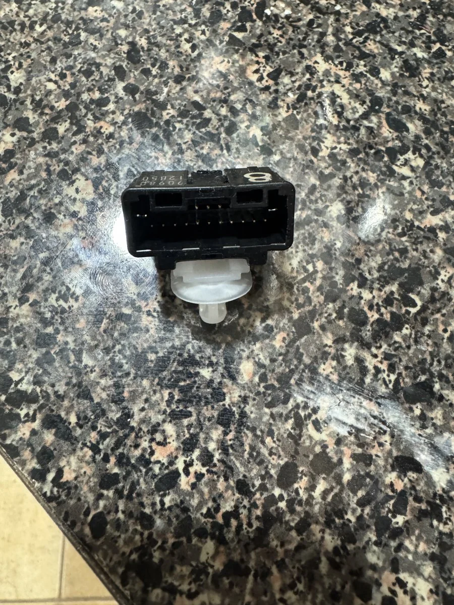

This is very helpful! How did you disconnect the CAN connector from the white clip that holds it to the metal? I lifted the tab and the entire end of the connectore fell off, but the CAN is stil connected to the white clip. I also wish this was included in the instructions.
The vehicle’s CAN connector has a black cap that is secured to the frame using the white plastic clip. Since there is limited room to work with, I left everything intact to allow the white clip to hold the CAN connector firm in place. I then bent up the small tab that holds the connector to the cap using a long flat head screwdriver. Once the tab is bent, you can then pry out the white clip and pull on the black cap (with the white clip) to disconnect it from the harness side connector. Attaching the VF’s CAN cable to the vehicle’s connector also requires some finessing. I secured the Wiflash to the area with a zip tie and ran the usb cable down to footwell where it is tucked away.

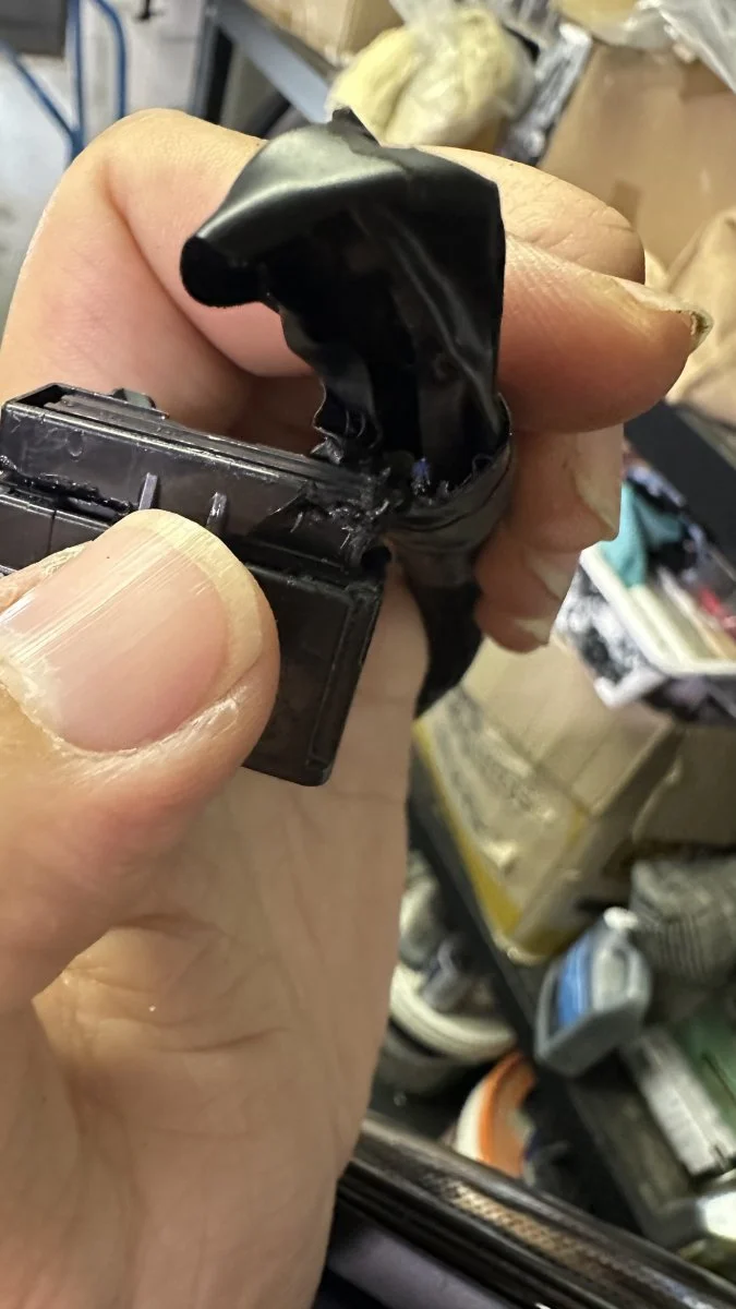

Have just emailed VF. Mine came with a faulty CAN connect cable. Wifi unit lights up directly when connected to the OBD.... but didn't light up via the can connect cable. The one that came with mine had duct tape and a very average welding job. One of the wires that were welded had snapped ):
