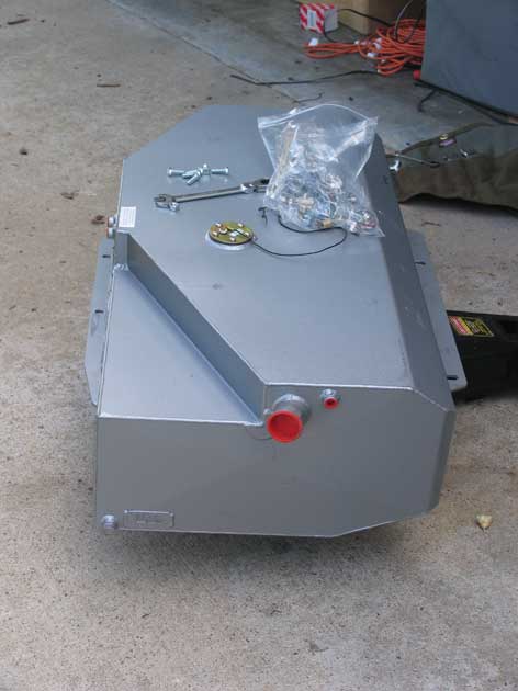

It will likely be pretty similar to the build of my 80 series with their tank, which was imported by Man-A-Fre. That required removal of the spare tire and its repositioning. This link is to the placement on my 80 series LC.

I added an auxiliary fuel tank to my 80 series Land Cruiser and like it. It required moving the spare tire, a rear bumper to hold the tire, a fuel gauge/switch to power the pump and a new filler neck. A lot of work but it has been in for many years and still functions well. I can carry enough fuel to turn it into a really long range vehicle. A description of my vehicle install is here Man-A-Fre 24 gallon auxilliary tank
