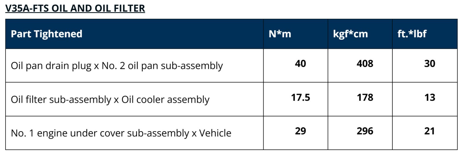

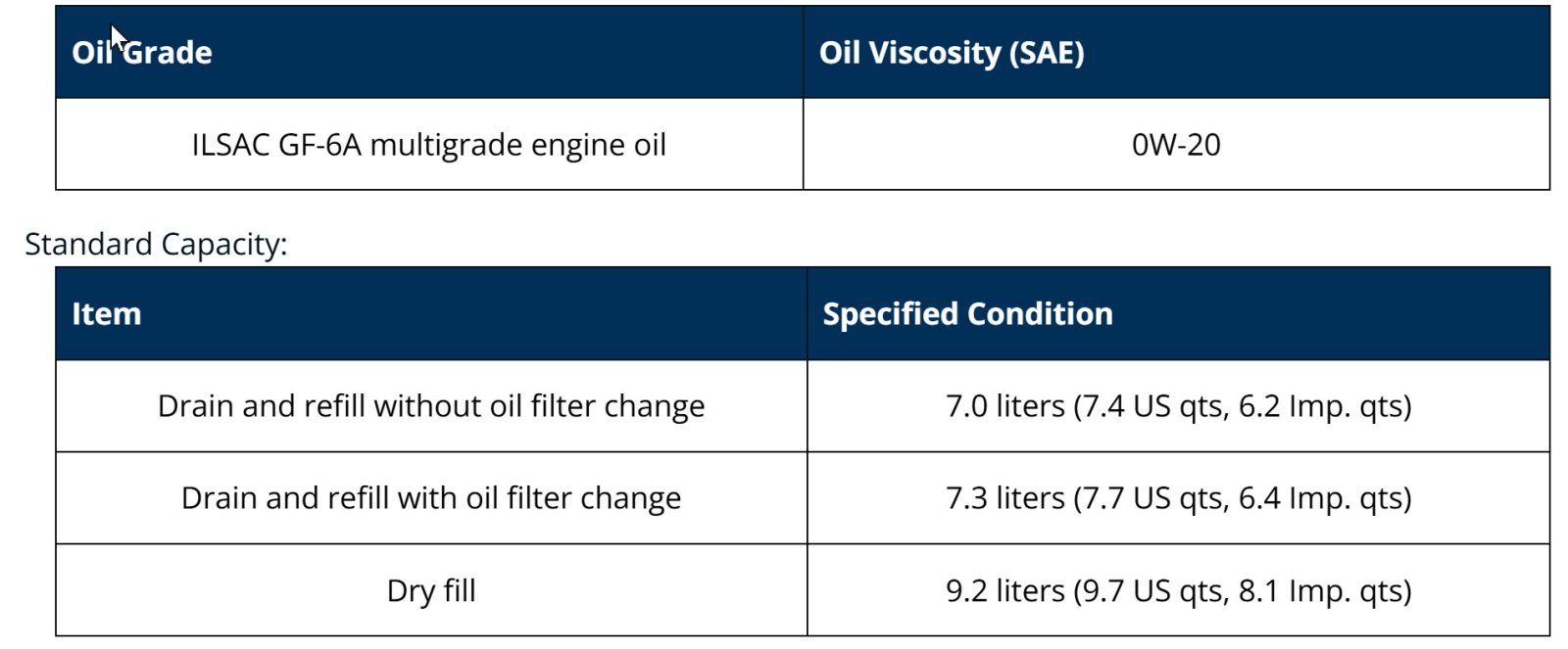

Here's some helpful specs from the Auto Repair Source manuals. For the record, I don't think posting these snips will violate any T&Cs or copyrights.
No. 1 engine under cover sub-assembly is Toyota/Lexus speak for "skid plate."
