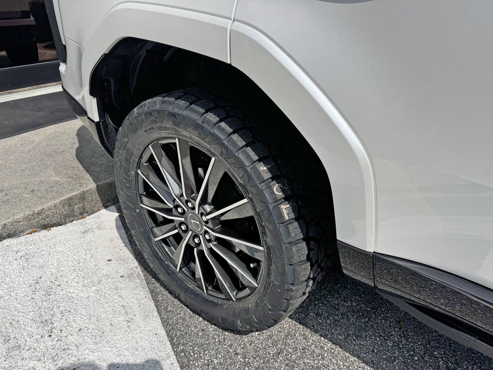

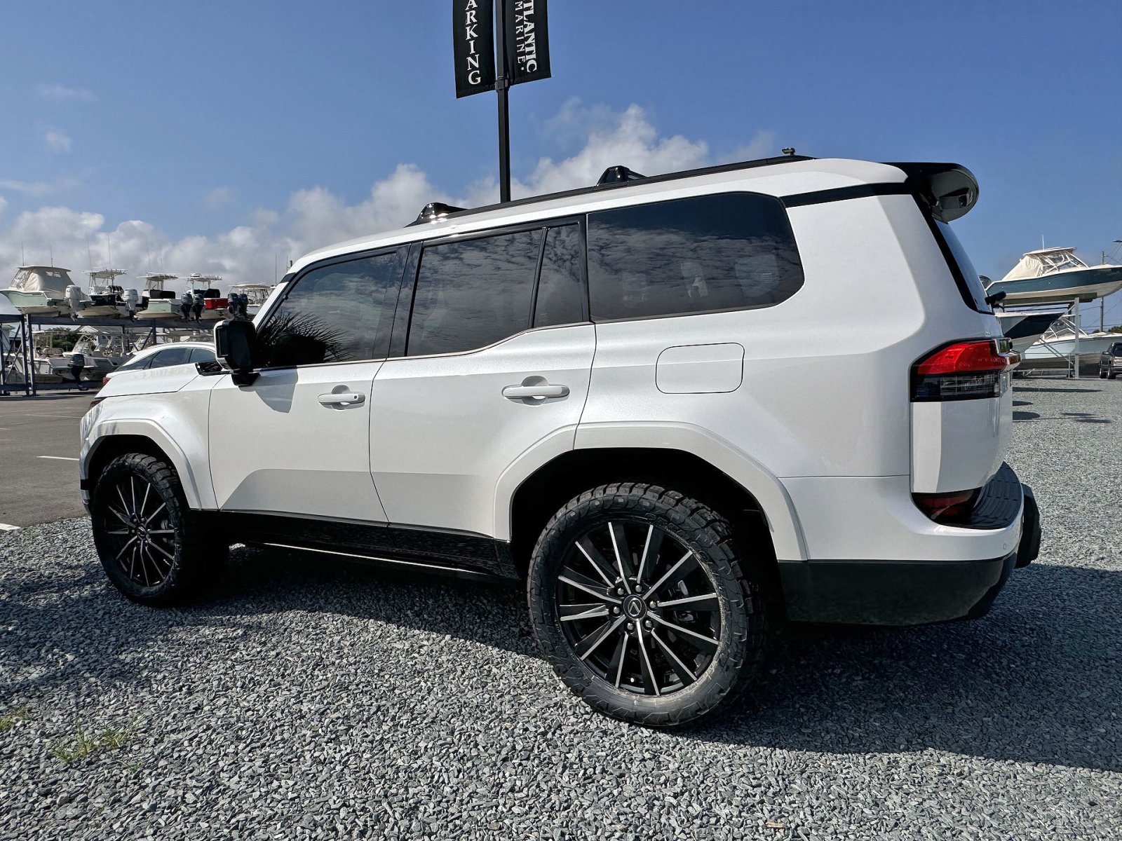

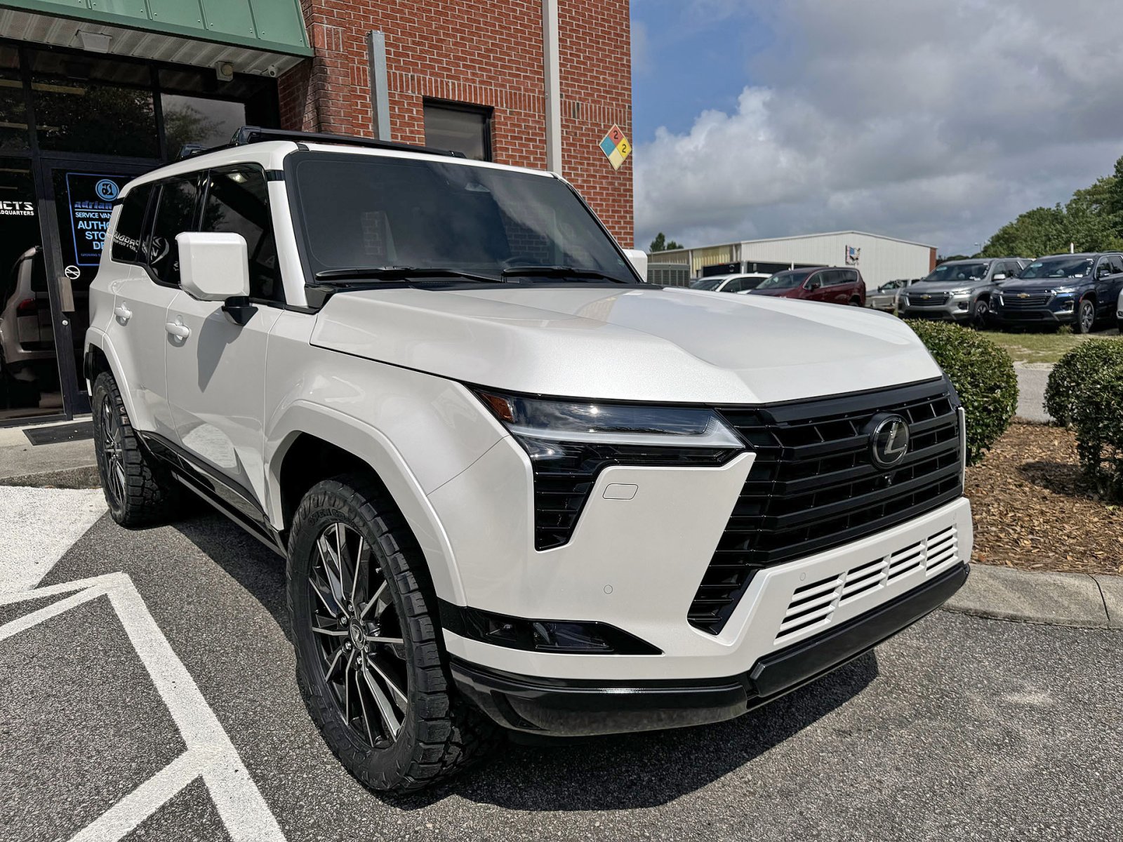

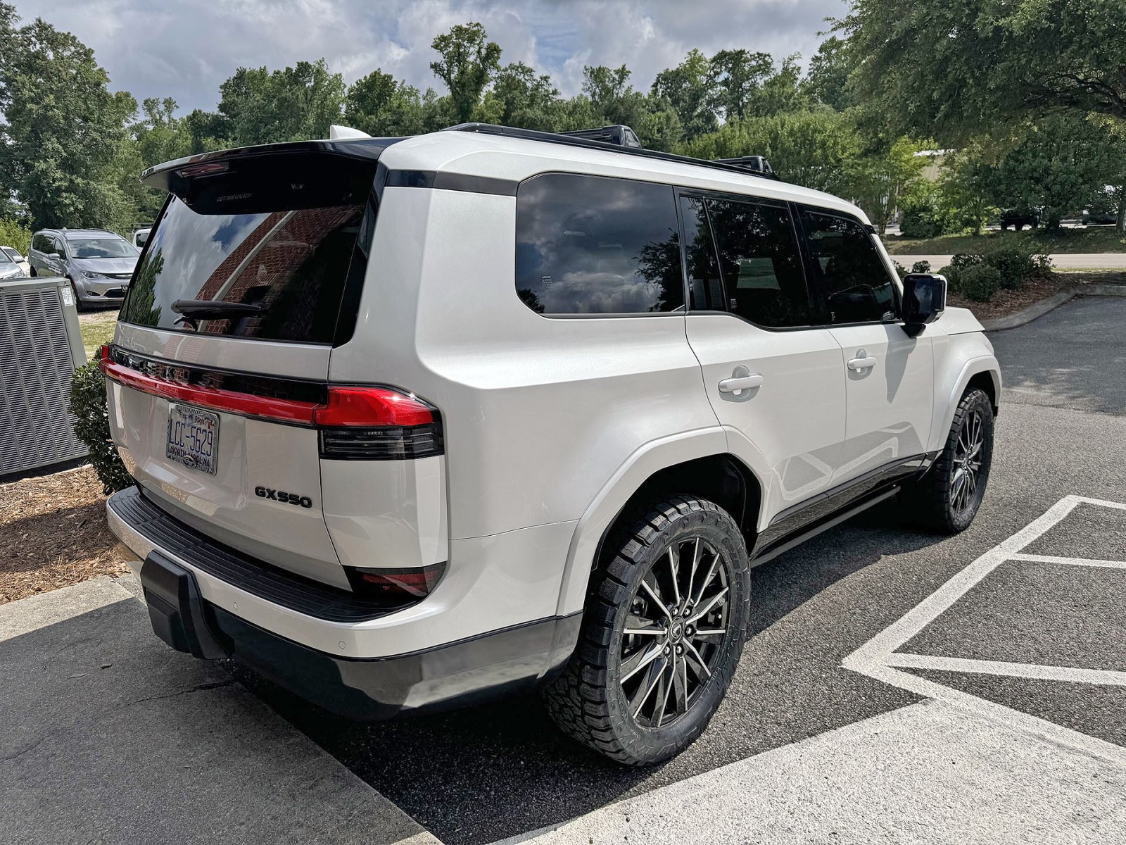

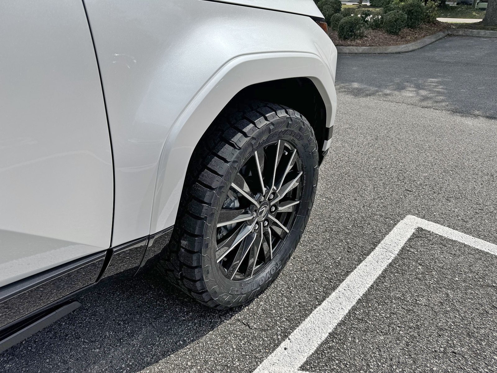

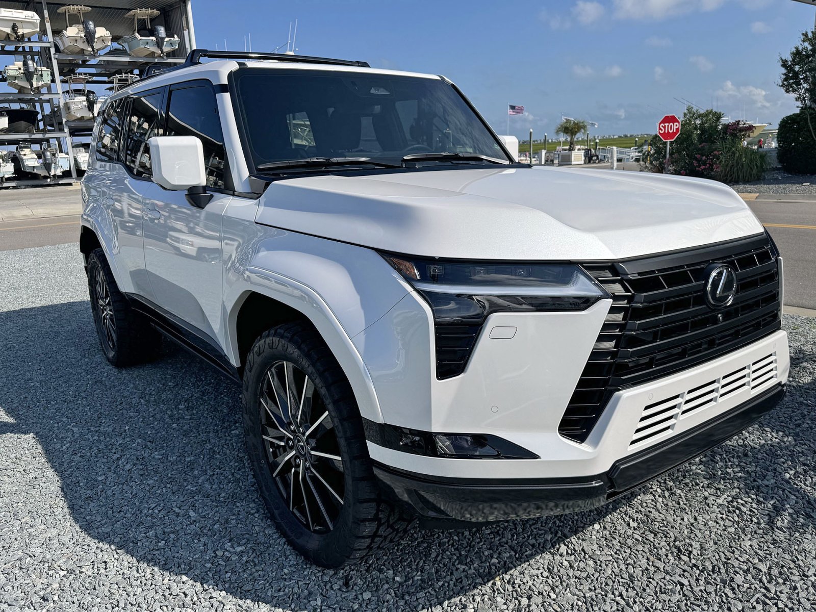

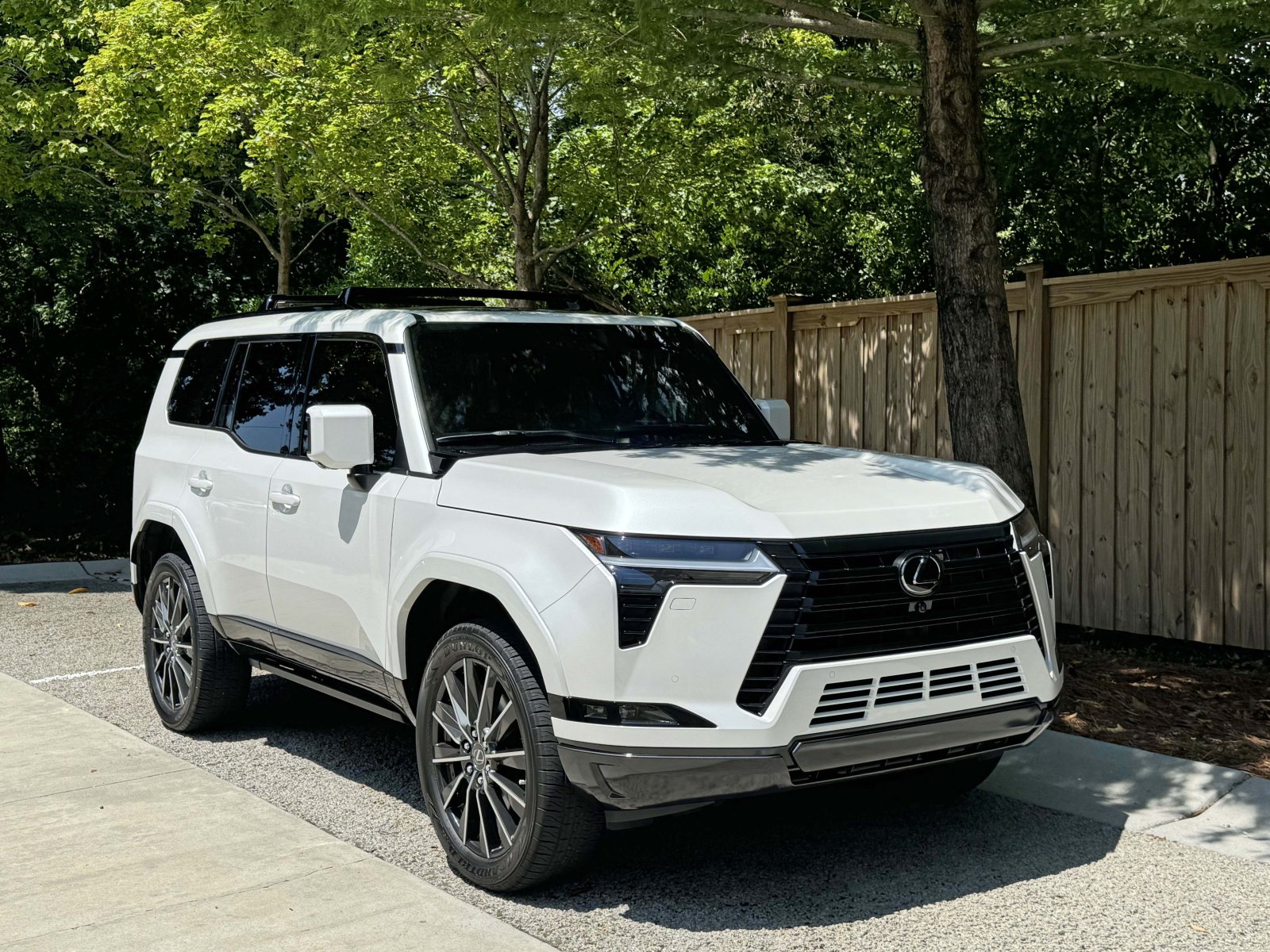

285/50/22 Toyo Open Country AT3 on oem Lexus 22. Zero rubbing, fits great and dressed wheel up tremendously.
33.3 x 11.7
I looked for others like this for weeks trying to find best size with very few out there on 22s. I hope this post helps others with interest.

Thanks for showing pics of your GX! We are ready to make our tires purchase and again see 285/55r22 are too wide for the stock 7.5” wide Luxury+ wheels. The size says 8.0” minimum. Didn’t u run into this when you chose your tires? Any rubbing at all that required some minor trimming?
I think the “55” sidewall height will be the bigger factor in the wheel rubbing in this case. Floyd had “50” height tires I believe.
Yep his original post stated he had the 285/50 size.
I'm torn between the 275/50 and 285/50 for my Lux+, but leaning towards the 275 as this is a non LT tire and rides better/lighter - Cant beat the looks of the 285 though! ..... tough decision
The 10mm extra is nice. But I decided against that for the reasons you mentioned. I like the 275 a lot and it feels like OEM+ for me with the toyos. The g stock dunlops were garbage.

Can you comment on the tire noise at highway speeds? I really like the concept of an all terrain tire on the Luxury model. Thx, Ron
It’s definitely noticeable. Expecially going above 65 mph. That said for me it’s worth the looks and performance.
I have a Luxury trim not the plus. Correct me if I am wrong but these should still work on it as well with no rub. Did you also look or has anyone else put the same size of the BF Goodrich All-terrain TA KO3's would work as well? Thank you!
Yes, functionally the trims are the same as far as wheel/tire fitment is concerned so you'll be in the clear. Both the Toyo and the BFG run fairly true to size so while I haven't personally seen the BFG setup in that size, I'd expect it to fit nearly identically.
