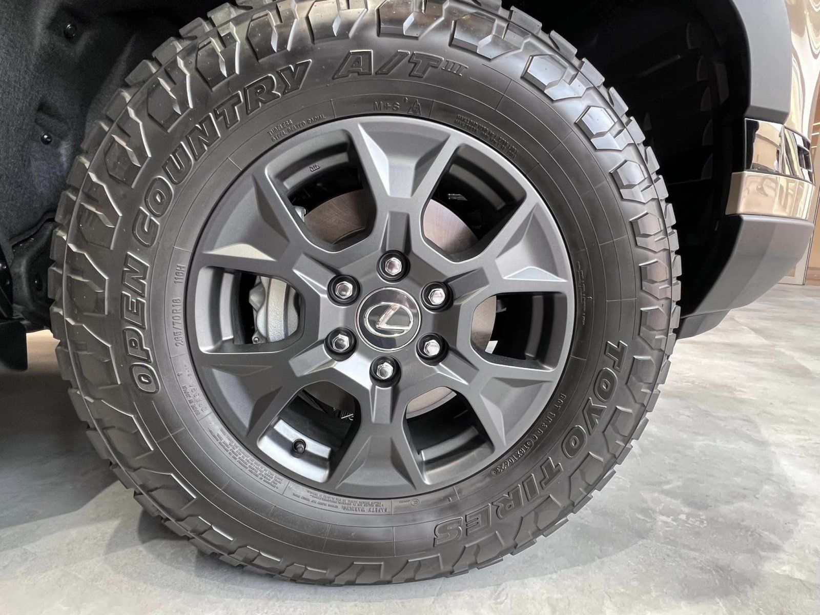

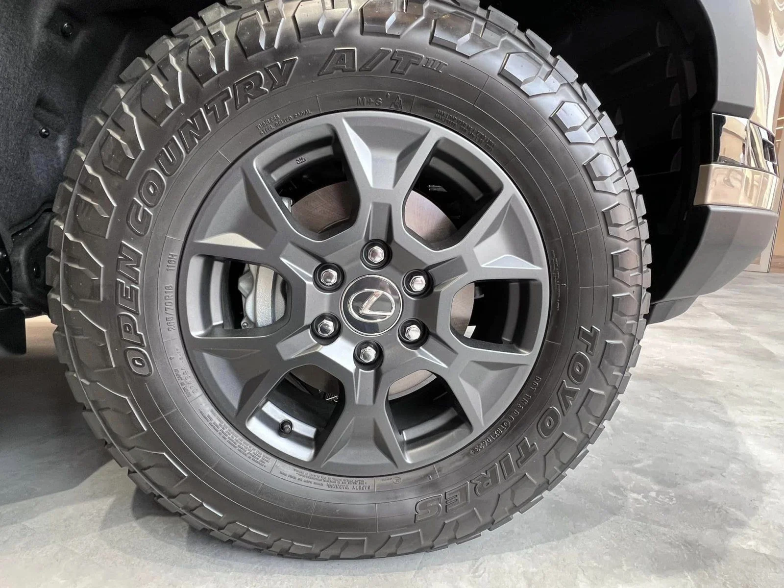

I saw the tires in person, it's your typical standard 4-ply P-rated tires.

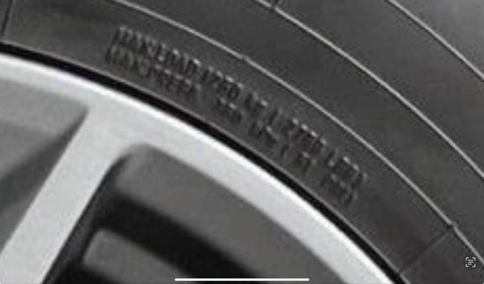

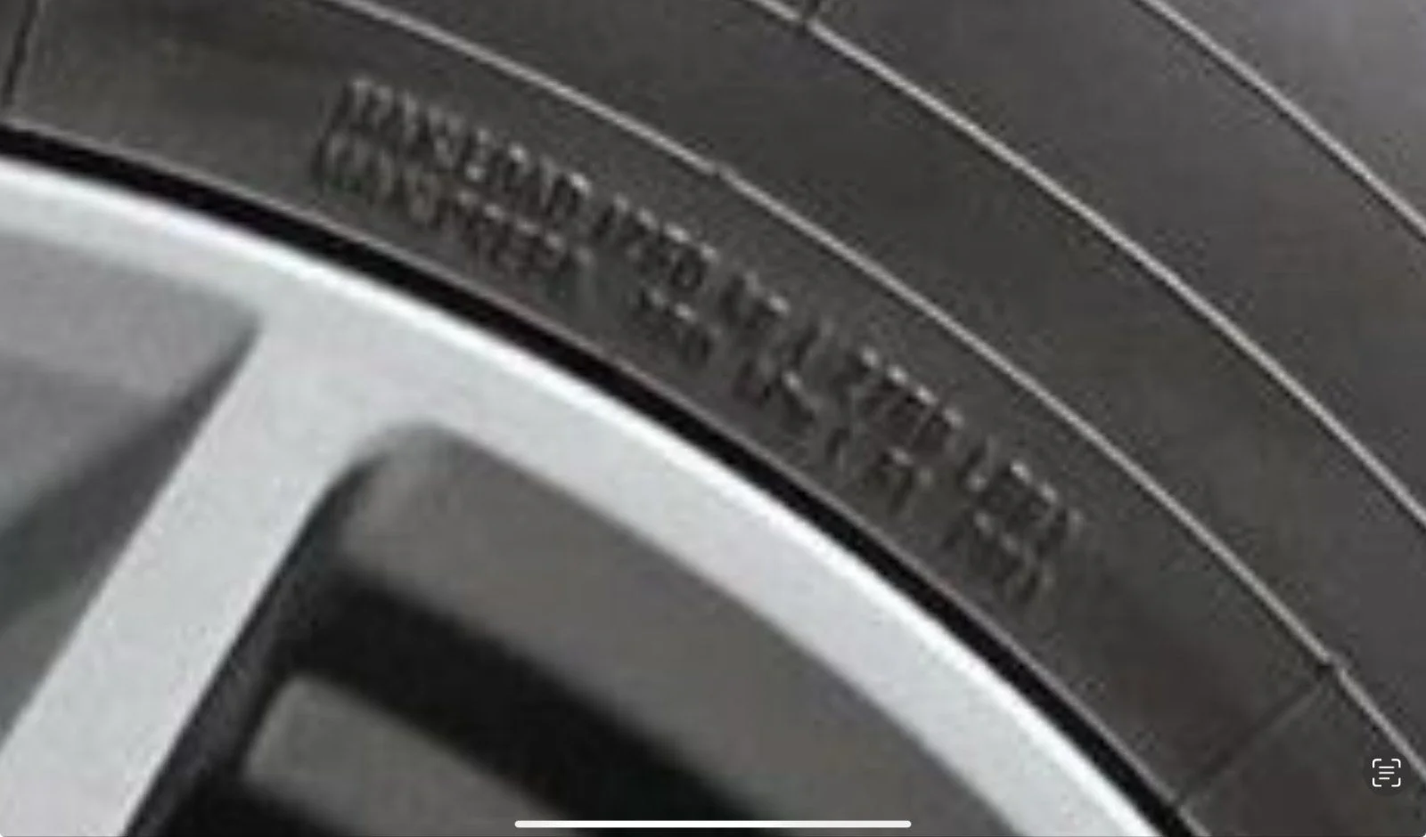

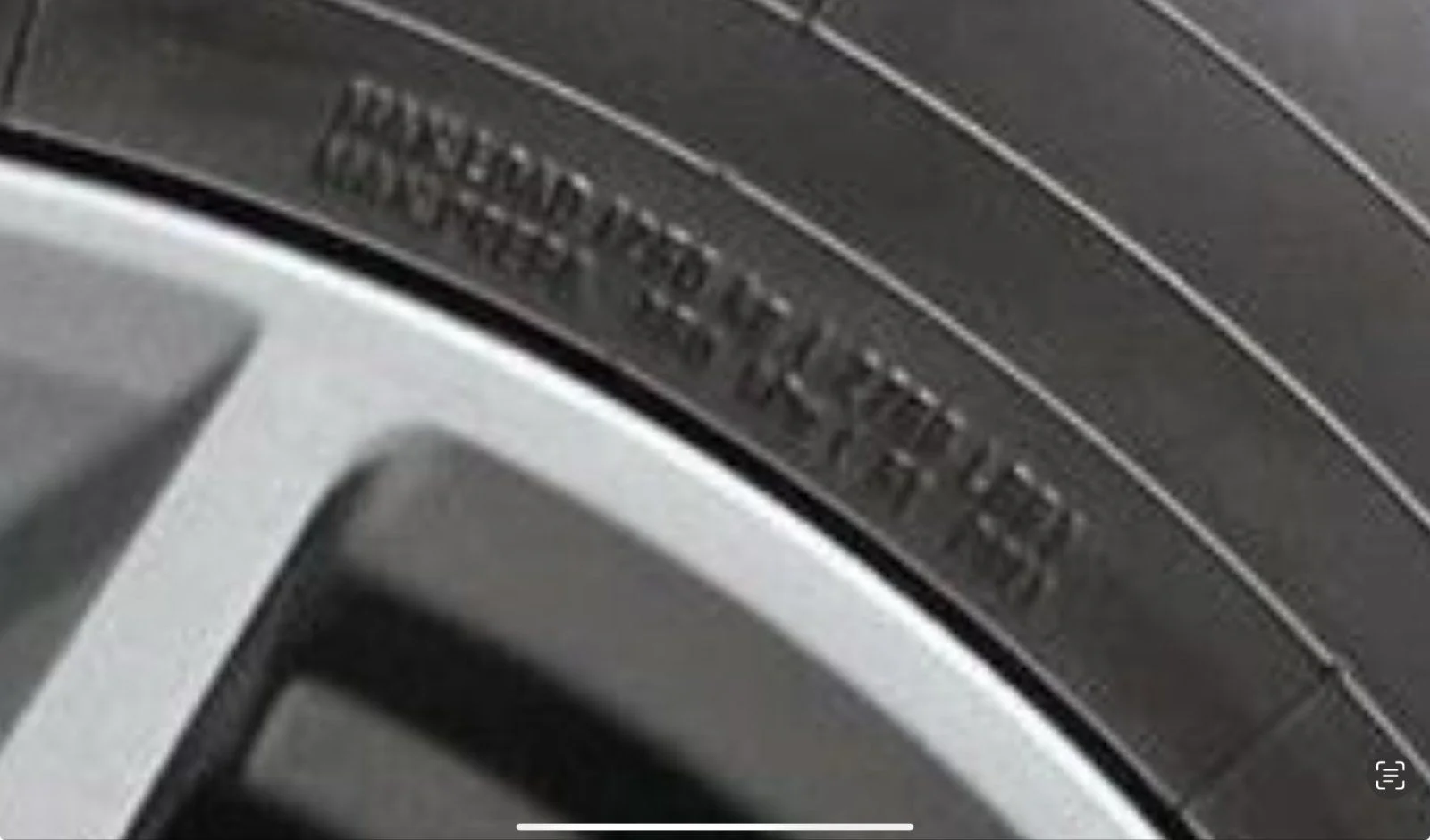

The tire pictured at the top of the first page is no P Metric tire. It is a little hard to make out, but here are the tread specs and max pressure. It is D Rated (51 psi).

I'm glad to see Lexus equip the overtrail models with a good versatile tire. They will come with Toyo Open Country A/T III 265/70r18 tires.
Here are some additional specs from Toyo:
Diameter : 32.6"
Width : 10.7"
Weight: 51 Pounds
Tread Depth: 16.4
Revs/Mile : 636
(From TireSize)
Sidewall : 7.3"
Circum. : 102.4"
