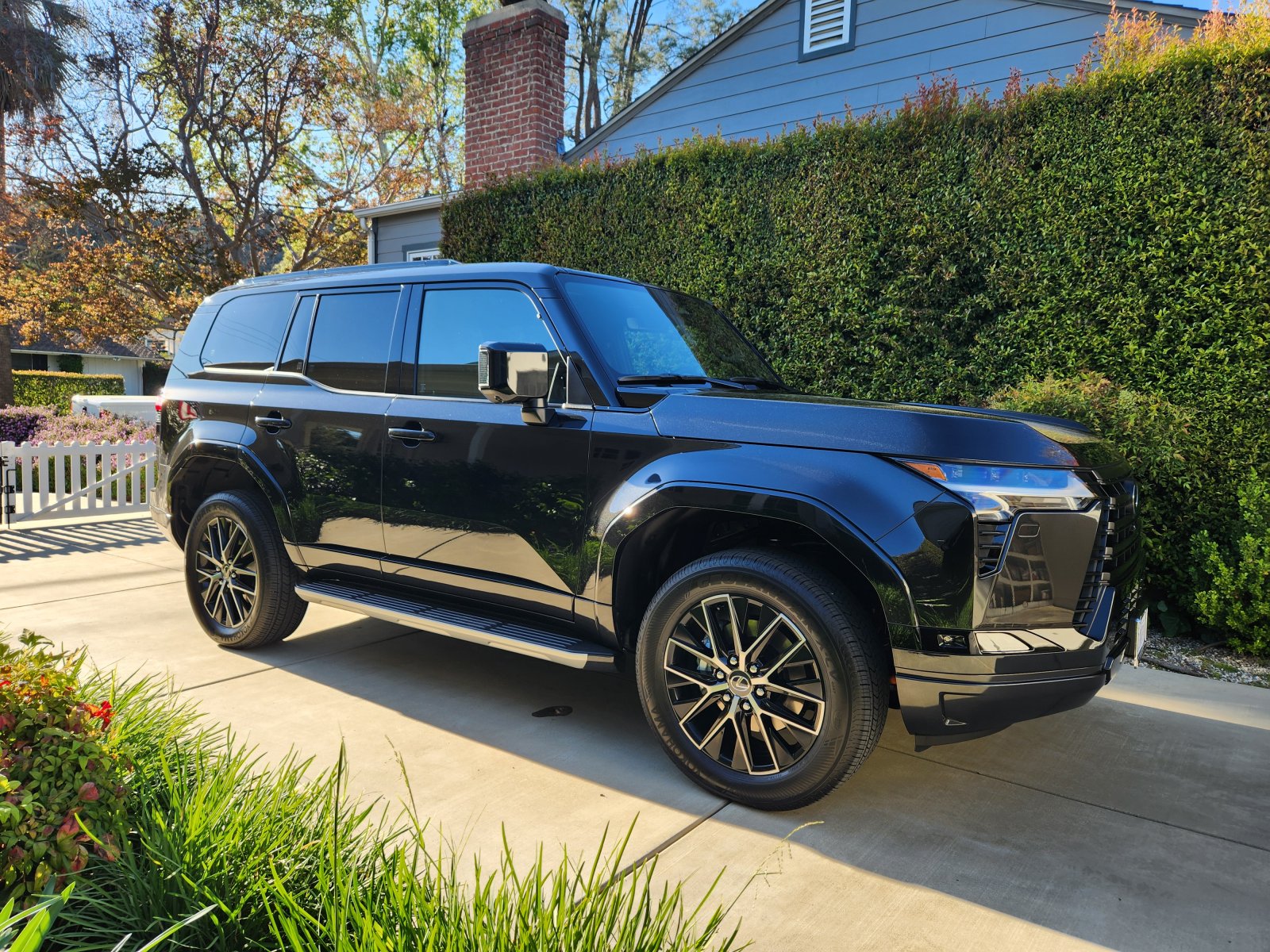

I just took delivery on my new GX550 Prem Plus. I'd like to upgrade the tires to something bigger. Does anyone know the max without lifting my vehicle?

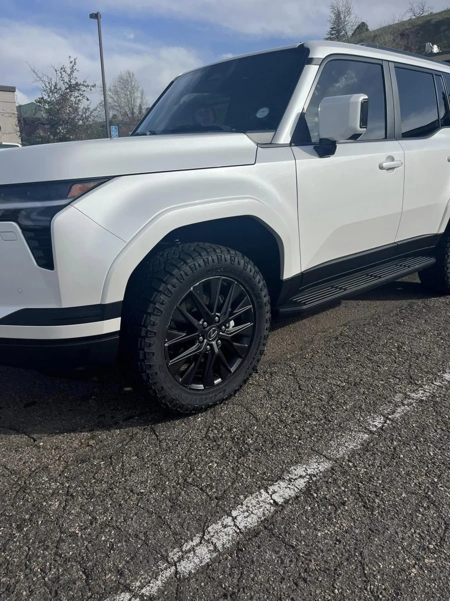

Hello, I'm also considering a tire upgrade on my Premium Plus as soon as I take delivery. Can anyone confirm if 275/60/R20 will fit on the OEM wheels without doing a lift or any finder modification?

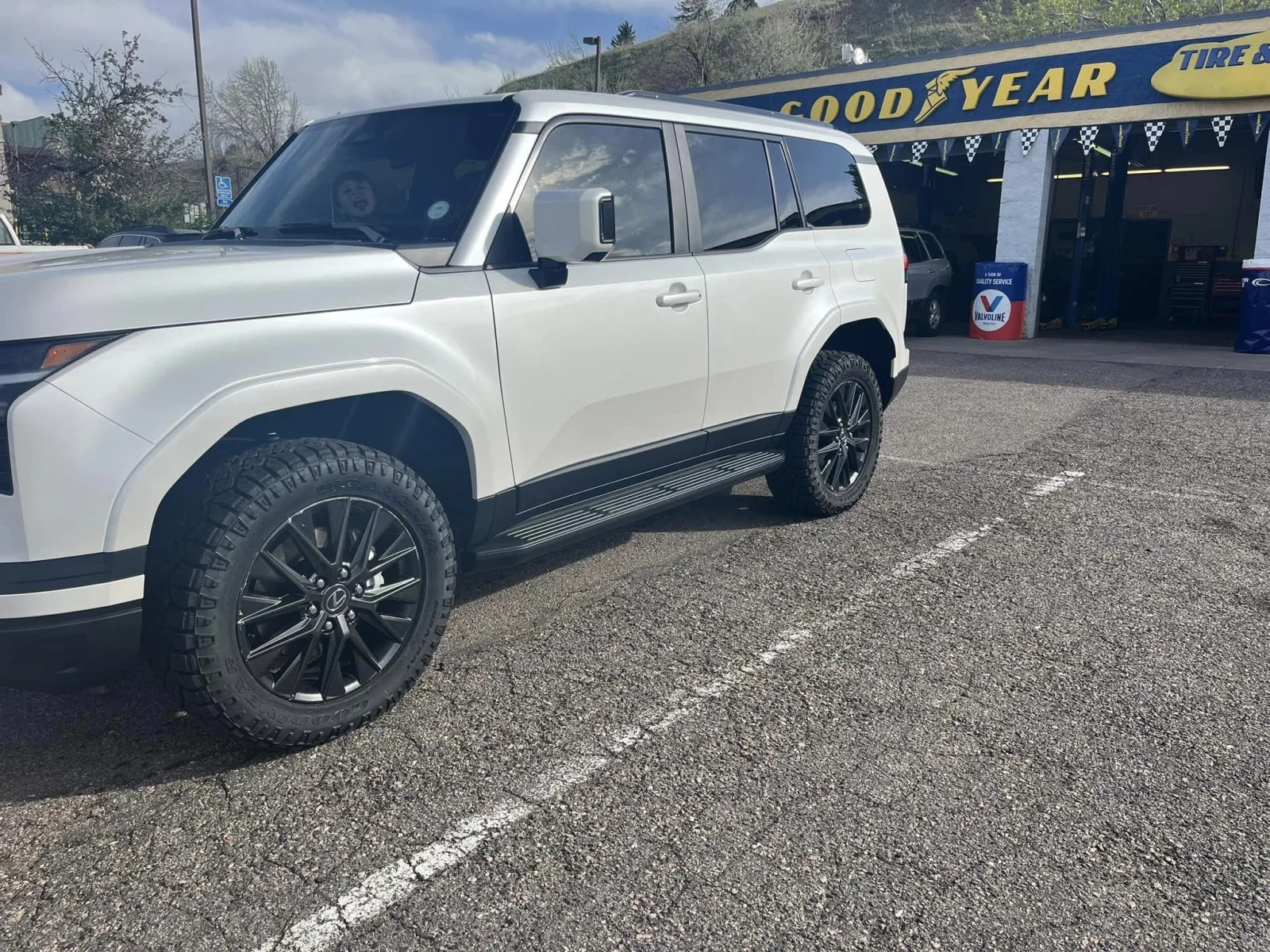

There was someone in our FB Group that installed Goodyear Wrangler Duratrac 275/60r20 on stock wheels. They aren't much taller then the stock tires that come on the overtrail, so I don't think you would have any issues.
Thank you, supersix. I'm not a big fan of the OEM wheels that came with Premium Plus, but I'm also considering swapping with aftermarket or OT wheels as an option.

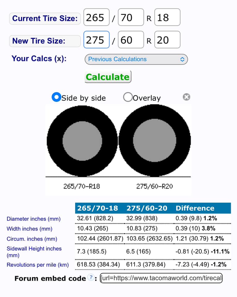

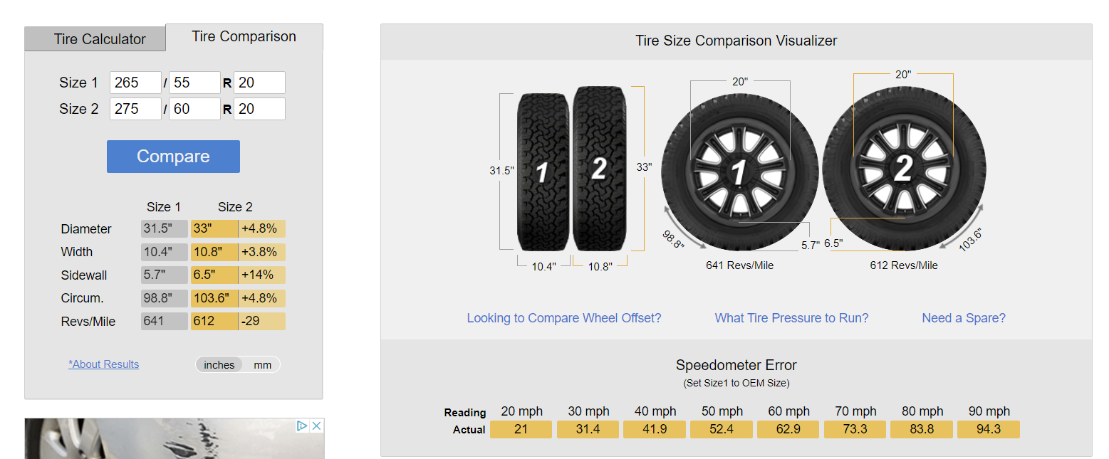

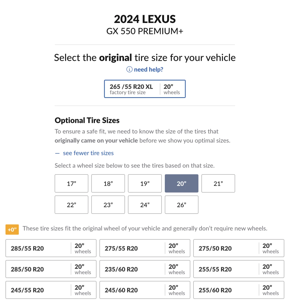

I missed mentioning that I also looked into size differences from tiresize.com/calculator. 1.5" taller and 0.4" wider will require any modifications. Again, Thank you! supersix.

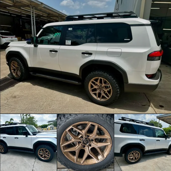

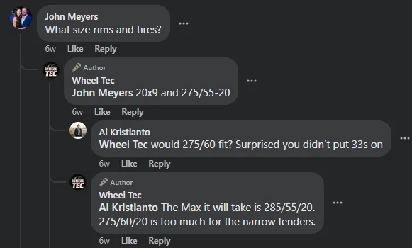

Nice looking setup, but interesting Wheel Tec commented that 275/60r20 wouldn't work. Anybody with proof otherwise?
From a Facebook Group:
