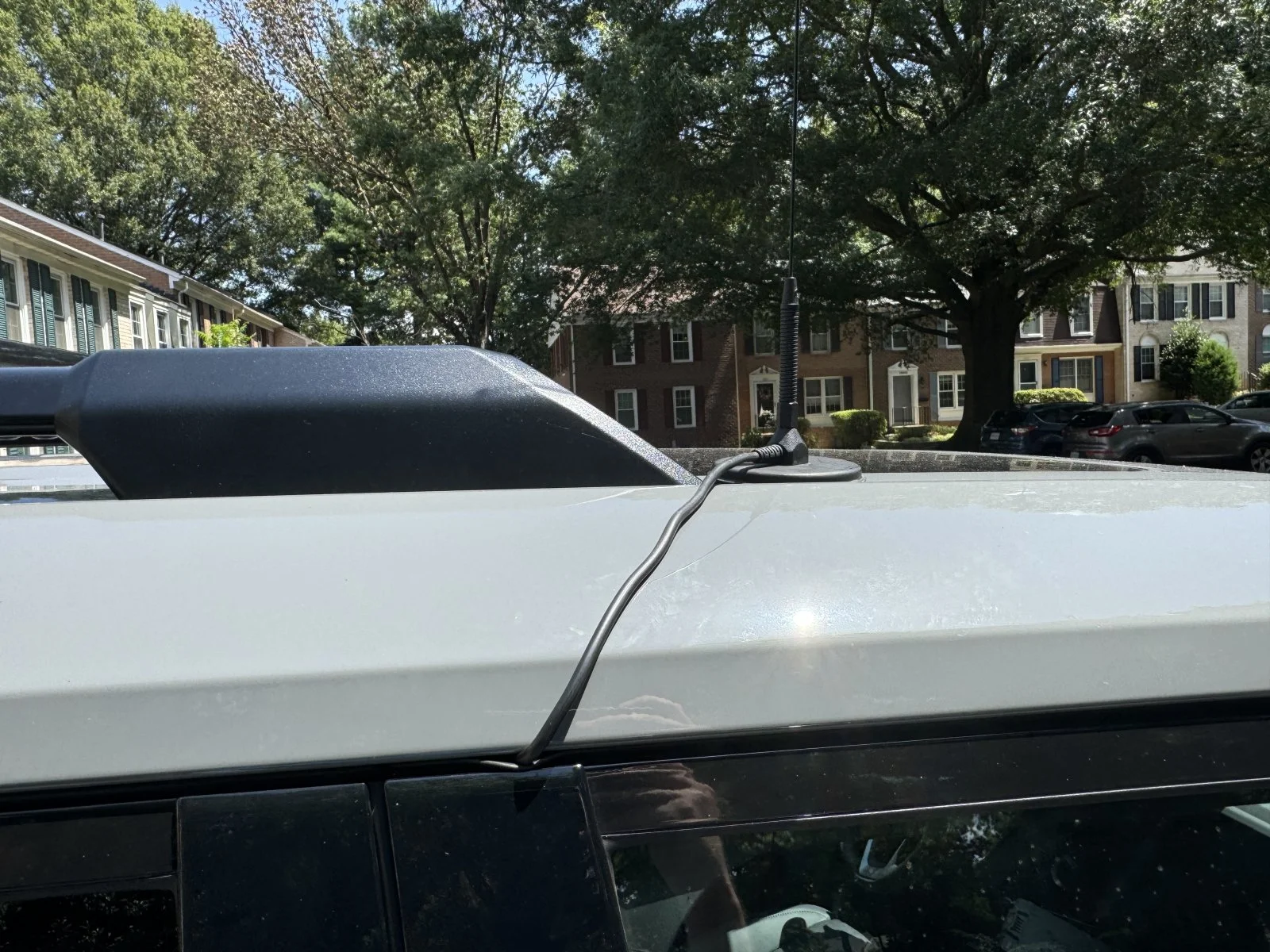

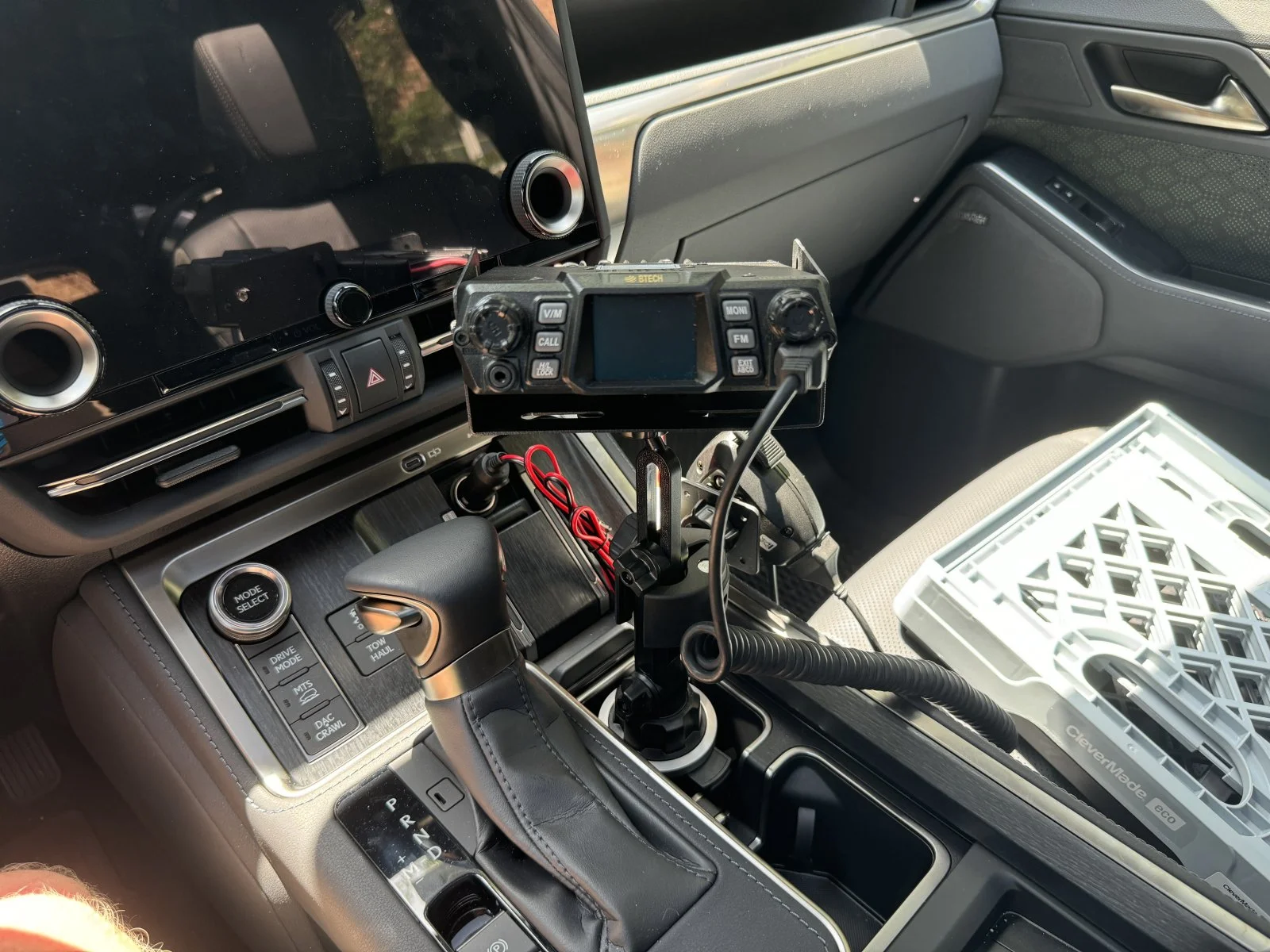

Temp setup using a Lido cupholder mount and magnet antenna.
Will do a permanent antenna mount once someone develops a solution or I invest the time in making one. I like the idea of using the rear most front passenger fender bolt and a bracket like Gamiviti.
